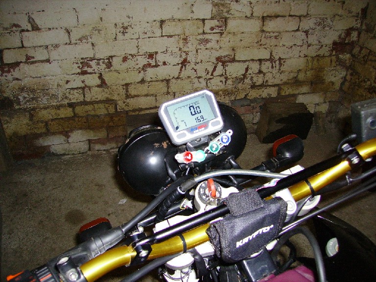

Postby Fil » Mon Jan 23, 2006 12:29 pm
Here's a pic (if it works!!)
The engine is not running, so the revs are zero, but you get the general idea. Also, please excuse the idiot lights which are temporarliy ziptied to the speedo mount. I should have spend the extra money to get the speedo with built in idiot lights I guess!
New Speedo sml.jpg (177.36 KiB) Viewed 6576 times
