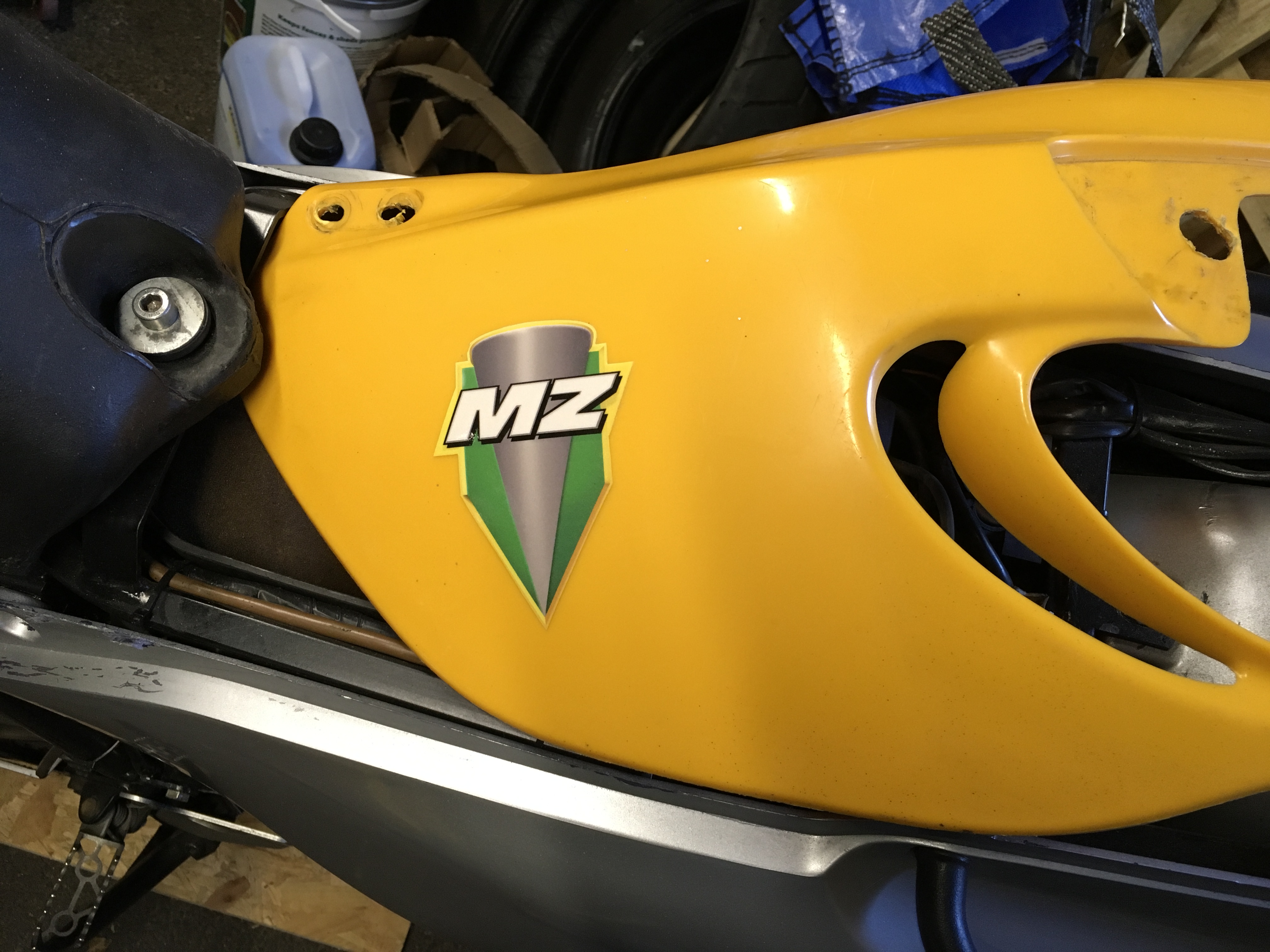

Postby Malcvtr » Thu Aug 16, 2018 1:37 pm
Decals applied. Hooray! First thing changed :-D
