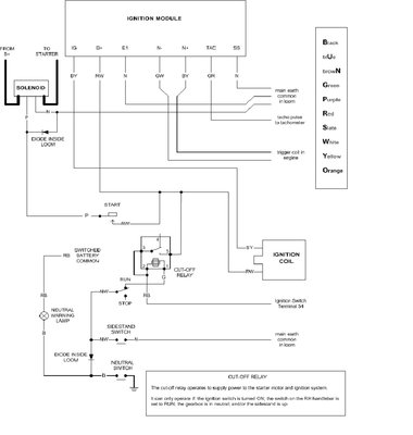

Postby DAVID THOMPSON » Thu Jul 20, 2017 3:52 pm
this is drawing click on it for bigger view
Re: No ignition on Traveller
Postby DAVID THOMPSON » Thu Jul 20, 2017 4:33 pm
horn is usually hot and grounded to beep
some bikes have a big black neg wire but also a small brown wire did the brown wire get missed on the neg post

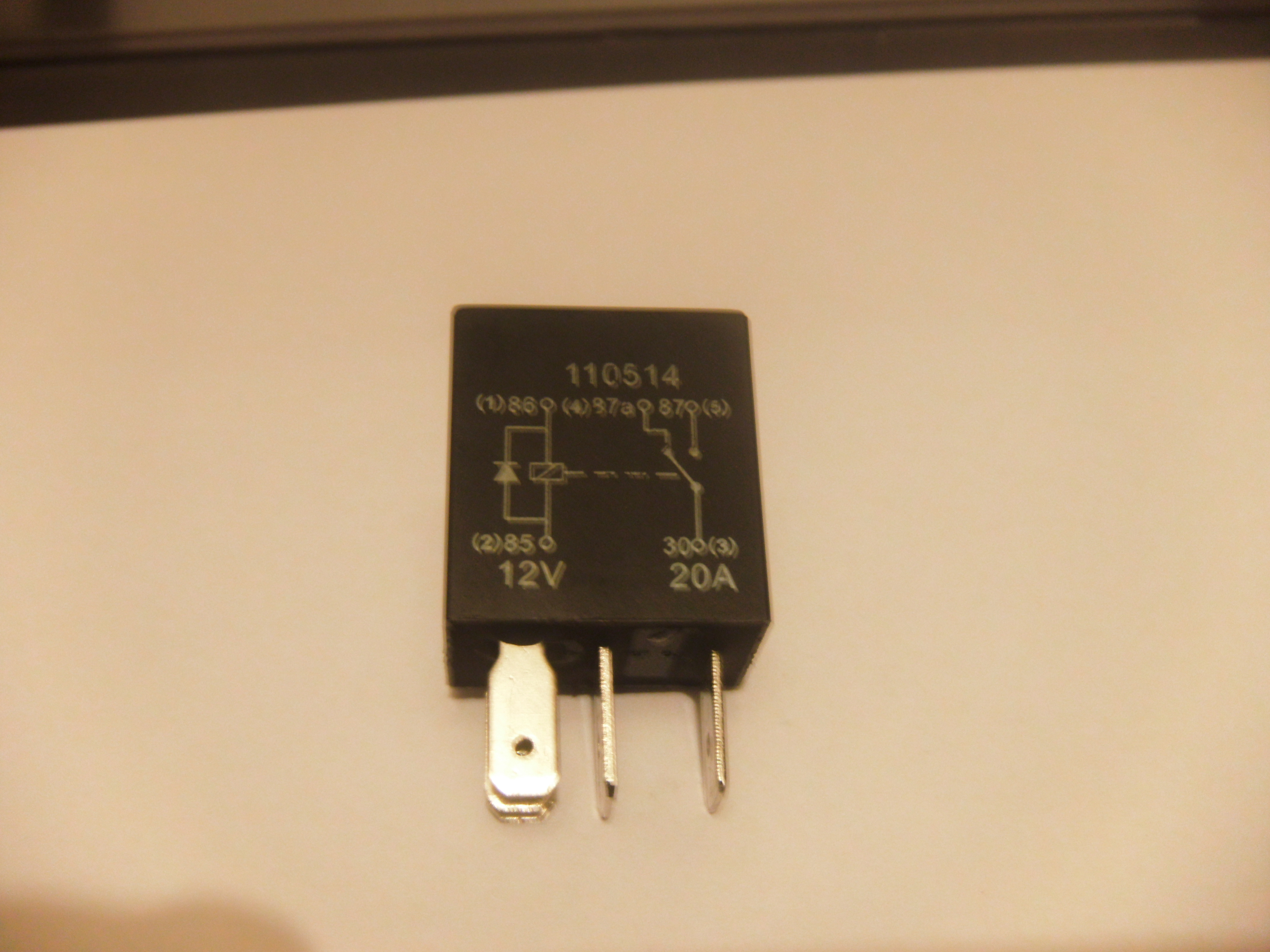

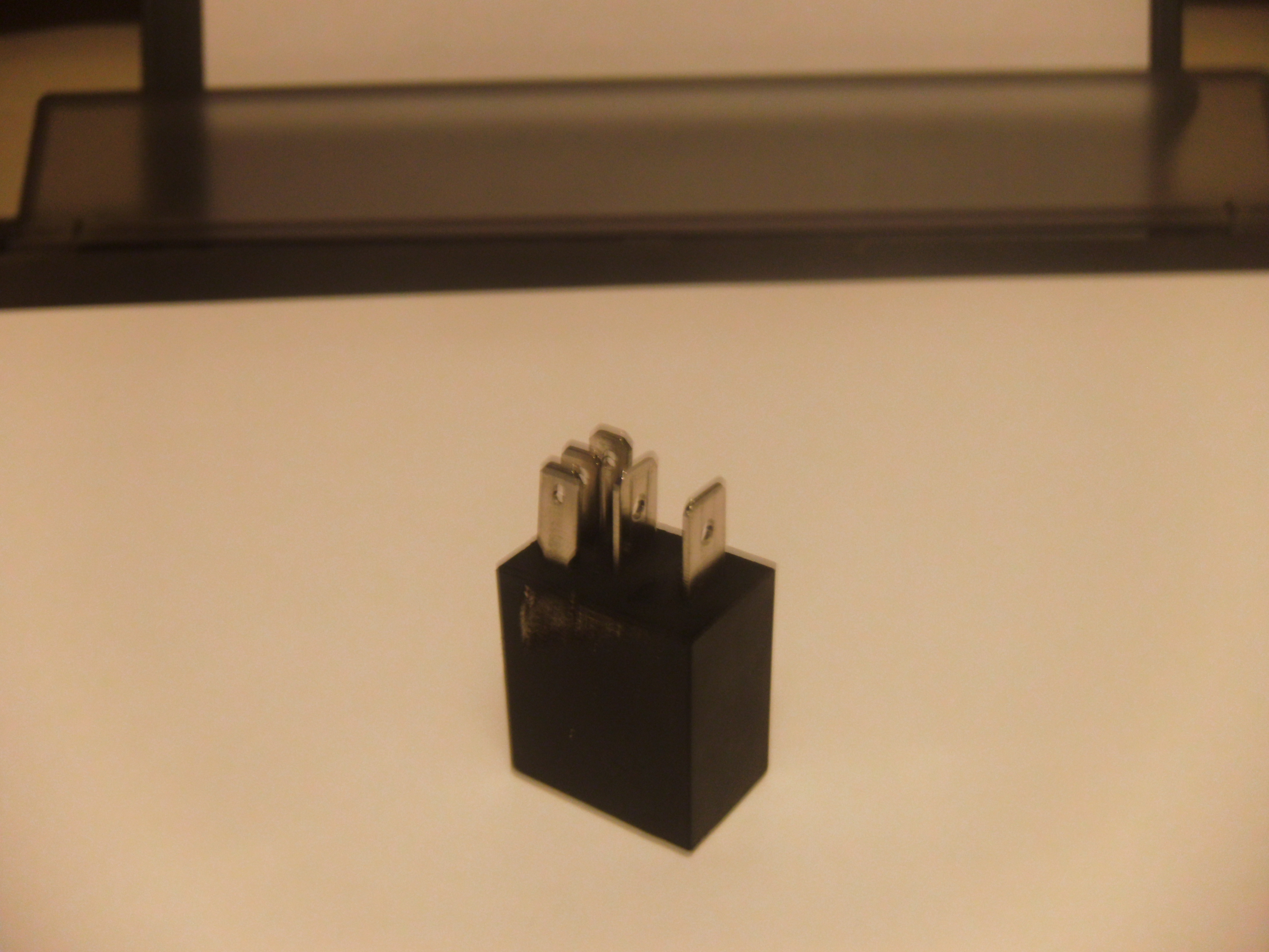

After a couple of hours in the garage, I removed a relay from the Replika (having removed some of the fairing!) and transplanted it to the Traveller and......BINGO the engine now turns over!! I need to sort out and free the choke cable which is sticking, or it could be the mechanism at the carburettor. At least we have some progress, although none of the "dashboard"/warning lights work. I have attached 'photos of the part I swapped over, is it a starter relay?

Postby DAVID THOMPSON » Sun Jul 23, 2017 4:19 pm
it is the famous relay 30 on 660 bikes or relay 19 on the 125 cc bikes
and an accessory relay at the parts store tell counter guy RL-44
shown lower middle of drawing above
solenoid is upper left it starts bike and is a bit bigger than a golf ball
Dave

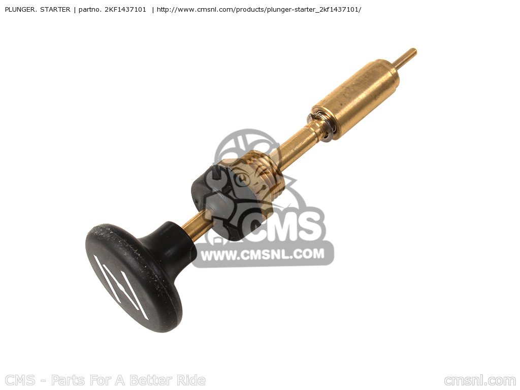

dickl wrote: I need to sort out and free the choke cable which is sticking, or it could be the mechanism at the carburettor.
Delete the cable and put a plunger style choke on the carb itself. Here's the part number, 2KF1437101.

Postby dickl » Mon Jul 24, 2017 4:04 pm
After a few hours I managed to lubricate and free the choke, and the bike started and runs!! :D I will now turn my attention to the horn and warning lights....watch this space! Thanks for the help/advice, I will get a new relay for the Replika (and possibly a spare), the plunger choke seems like a good idea, but a bit pricey.

Postby DAVID THOMPSON » Mon Jul 24, 2017 4:41 pm
at the relay the spade lug on the green wire is smaller than the rest needs a little adapter or a bigger lug to fit the rl44
Postby edfmaniac » Mon Jul 24, 2017 7:10 pm
dickl wrote:After a few hours I managed to lubricate and free the choke, and the bike started and runs!! :D I will now turn my attention to the horn and warning lights....watch this space! Thanks for the help/advice, I will get a new relay for the Replika (and possibly a spare), the plunger choke seems like a good idea, but a bit pricey.
It's a nice upgrade in my opinion. Never worry about choke cable maintenance again, and if you are doing a lot of tuning like I was, one less thing to take off and put back on every time you pull the carbs.

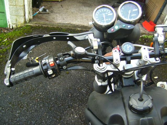

Postby breakwellmz » Wed Jul 26, 2017 3:18 am
A stainless inner cable running in decent bicycle brake or gear outer and you shouldn`t have any problems, what bikes don`t like is not being used.
I replaced my choke lever with a friction cycle gear lever which is much more usable-

Postby dickl » Fri Jul 28, 2017 9:25 am
The new relay arrived today (£2.49 including p & P!!). I have tested it and it works fine; one small question, when I came to fix it in its final position, I noticed that after a couple of moments with the engine running that it had got a little warm. Is this normal? :?

Postby DAVID THOMPSON » Fri Jul 28, 2017 10:55 am
if its the stock one it will be very warm because its to small for the job its doing
but any relay will be warm as ALL the power to run the bike passes thru the relay contacts
plus the coil inside is on all the time and produces heat as a results of being on
a toggle switch would work here but then all the safety features of the bike would be bypassed
