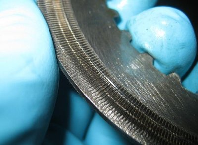

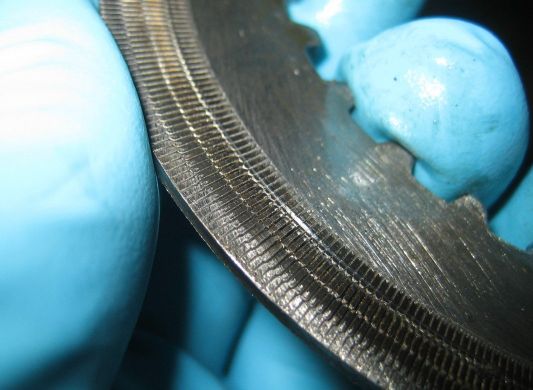

Technical details: unmodified 1976 TS150/2 engine; a (well tested, definitely non-faulty) transistorized 6V points-ignition; N.O.S. replacement clutch plates less than with 50 miles on them; original driven-plates (with some wear, but not much - see attached); new oil seals installed correctly with well-greased lips; gearbox filled with 0.5l fresh GL4 80W-90 _gear oil_; clutch worm adjusted to be 0.25 turns out from "tension" point on the clutch pressure-bolt. Definitely not burning gear oil, because the oil pours out from the check-screw hole just fine.
I have no idea what to check next. I'm pretty sure it's the clutch from the behaviour. When I changed the friction plates a few months ago, the springs still felt VERY stiff (hurt my hand getting the cups out!) and seemed about the right length (didn't put my calipers on them, however) so I wonder if it might be the springs losing tension because they're 30+ years old? Can anyone throw some light on this?

I'm pretty sure the clutch basket and splined centre-unit are okay - the bike's got 15K miles on it (only about 50 are mine) but I doubt it got much exercise just before I bought it because it came from a garage that obviously didn't know how to service it. Didn't notice any bites/notches in the basket, the clutch centre didn't have obvious scoring/dents. I did have to file the new friction plate lugs so they fit smoothly between the basket fingers, but I don't think they're binding...
...besides, it's a TS150, which means only the friction plates actually put any force into the basket - and the friction plates are pure bonded-fibre stuff. Could these plates really deform/damage the clutch basket?

I have seen worn clutch baskets on small TSs and ETZs where the fiber plated have eaten their way into the clutch basket fingers, but you'd have see that when you had it apart, it's not subtle.
