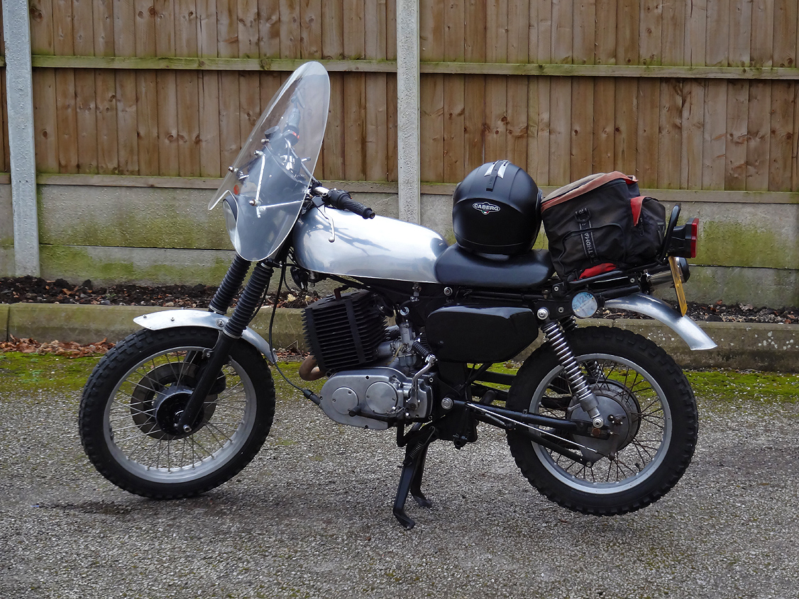

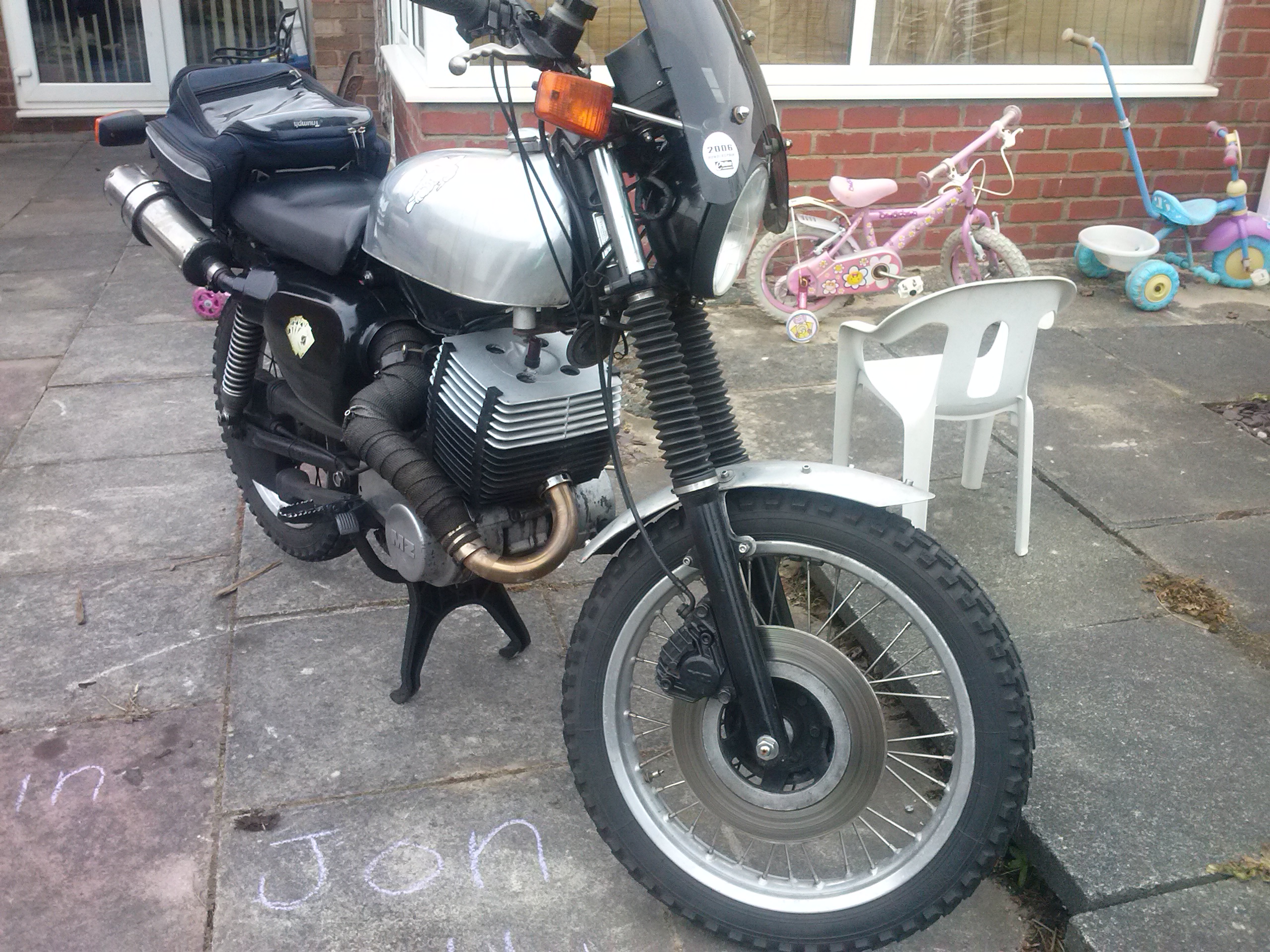

I'm intrigued by your smart looking bike. What tank do you have on there, and how have you fabricated the exhaust? It all looks great. :D

Thanks for your interest, the tank and exhaust have been hand made by a previous owner. the seat is Yamaha TRX850 the screen zxr750 turned upside down and trimmed a bit. the mudguards are British. The bike started life as a Kanuni 251 with cast wheels and nasty styling.
I bought the bike a couple of years ago as a half finished cafe racer project from eBay it came with a big pile of bits, all I did was fit the bits I liked and ebayed the remains to end up with what you see now.Itried a big screen but it was too big so its been replaced by the Kawasaki screen

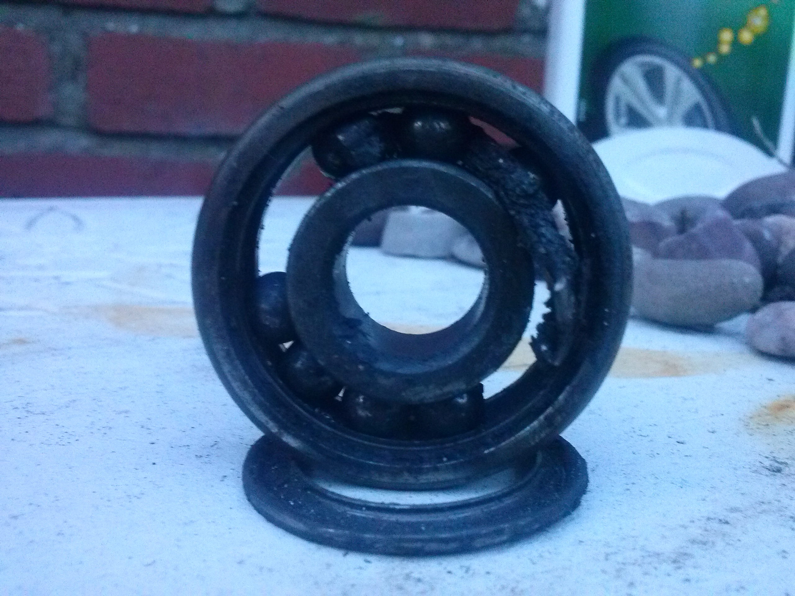

Despite no play in the rear Wheel this is what I found Replacement fitted at a cost of £1.37 inc vat still rattling but the roll has gone...............
