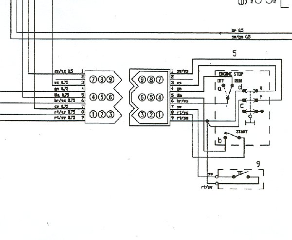

Hi, thinking of using light switch on right handle bar to control some auxiliary lighting on my bike. As mine is a US bike it appears that this switch is disabled i.e. headlight is always on. Anyone have experience using this switch to do what I am thinking about? I'd rather use it than add a switch to the console. Thanks.

Here in the UK we are able to switch the lights off and on with this switch. I've copied the connections from the wiring diagram:
Sorry it's not very clear, but hopefully clear enough to understand.
The light switch (5) obtains switched +12V from pin 9 red/black wire (rt/sw). This is the same supply as the brake switch (9 on the diagram).
When the switch is in the 'P' position, power is connected to pin 1 black/white wire (sw/ws), and when in 'H' position it is also connected to pin 3 white wire (ws).
Hope this helps,
Norman

Postby DAVID THOMPSON » Sun Dec 05, 2010 11:45 am
when you decide where to hook for the switched power
do use a relay to power the added items.
drawing very much power threw the switch is not
a good idea
Re: Right hand light switch
Postby Fluffy_Dog_1018 » Sun Dec 05, 2010 2:19 pm
Hi Norman, thanks for the diagram it will get me started.
Dave, yes I plan to use the switch only to control a relay I have wired (via fuse) to the battery.

The switch is a real switch with wires terminating in the headlamp cowl, but as Dave has said, the switch should only be used for very low current (maybe 1A) and/or to control a relay.
