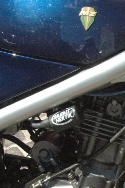

I use a SilentHektik MotoCoil:
http://www.silent-hektik.com/Zub_Moto.htm
which bolts right in to the two tabs on the frame of the Skorpion. This coil take the standrd type car lead to plug in, not a screw-on lead like the Denso. It also has a much hotter spark.
here on the street bike.
