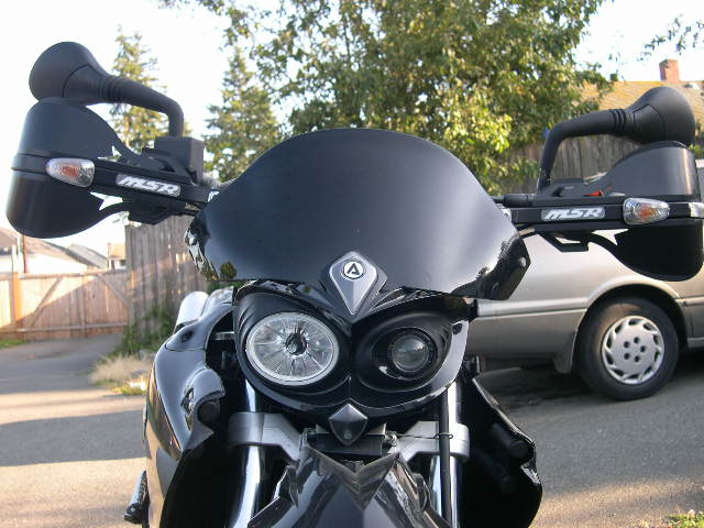

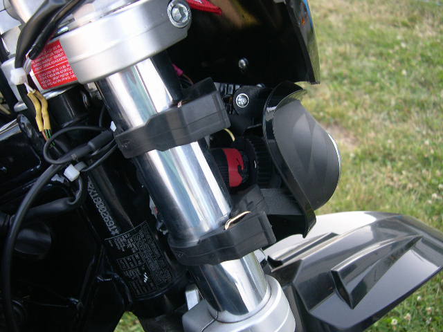

check the pics, I cut the side panel suppurt tubes even,, moved the cap from the inside to the visible side. The headlamp is held on with the supplied rubber straps. made a harness, and zip tied it between the 2 bosses on the head tube so it does'nt catch when turning. there is not enough room to run the stock speedo, so I installed a Trailtech electronic speedo, which is great!
in one of the pics, you can see me holding up the wind deflector that came with the headlamp unit, I modified and installed 1 I got of a BMW650 at a motorcycle swap for $10.00. MUCH better wind protection, but still looks cool :twisted:
mounted lockhart phillips flush moun turn indicators on the hand guards, drilled through and ran the wiring on the back side.
last weekend added the HID lamp setup in the larger reflector, and mounted the controller under the right sidepanel.
any questions?
