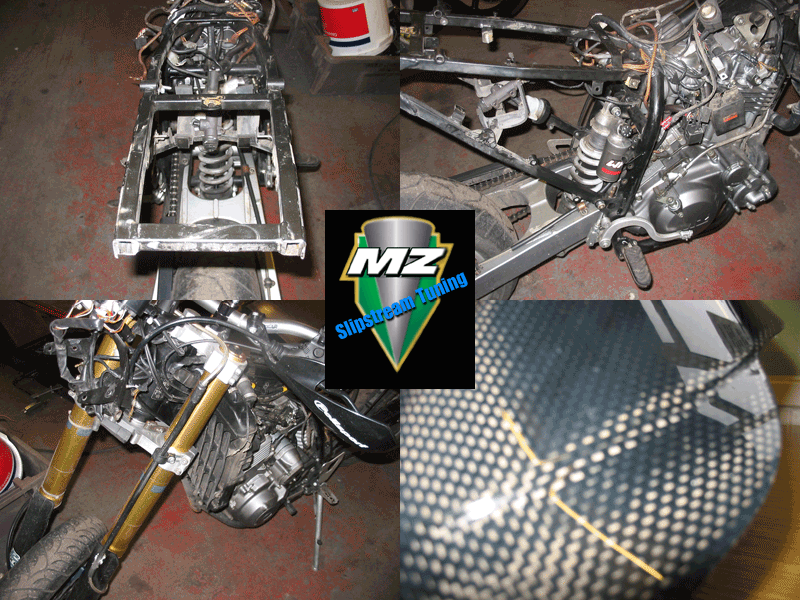

Postby Wonky » Wed Dec 20, 2006 5:54 am
Well it's started, on Monday the bike was taken off the road and stripped, back ends being chopped about and we have managed to line up the link-pipes and headers for the two into two system. All is looking good! Had yesterday off work as the candles burning both ends and nearly met in the middle. I'm juggling day job, Graphic Design business, Social life and this project, it's all crazy and to top it off i've got the dredded Flu lurking, but a nice damn hot Chicken Curry last night smashed that into line for now, can't say my ass is happier for it though! :-D
Anyway just want to wish all you guys/girls a Merry Xmas and a happy new year! Stay safe and please, please,please DON'T DRINK AND DRIVE!!!
DRINK AND RIDE....it's much more fun!!!!!!!LMAO!!!!! No actually don't do that...
Anyway have a great holiday and spend every minute you have tinkering that beautiful MZ in your garage. I'll be in work getting this bike completed! :D
Wonky

Postby cat » Wed Dec 20, 2006 6:04 am
take photos! :D (well, as much as you can....you said something about first rights or something.)

Postby Wonky » Thu Dec 21, 2006 9:38 am
Here we go, here we go, here we go.....here we go, here we go, here we goooooooooOOOOOO!
