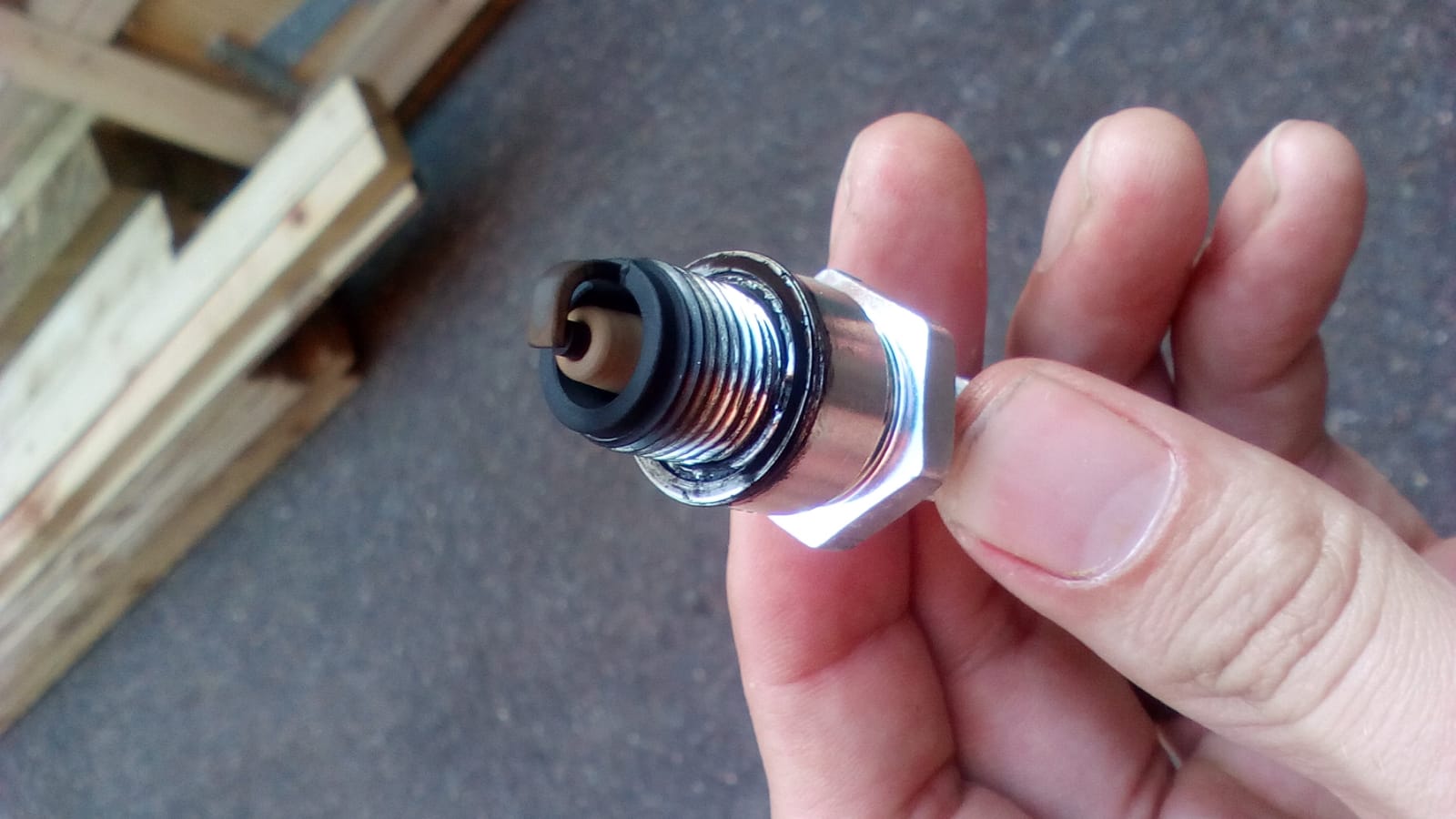

Postby otb123 » Fri Aug 30, 2019 7:23 am
Attached is a pic of the plug after some general running about i.e. a mix of all throttle positions... the plug was not new and the insulator was covered in black prior to this from how the bike was running prior to carb clean, re-jet and timing being set right...
Does anyone see anything wrong here? I'll do some controlled runs at some point with new plugs...

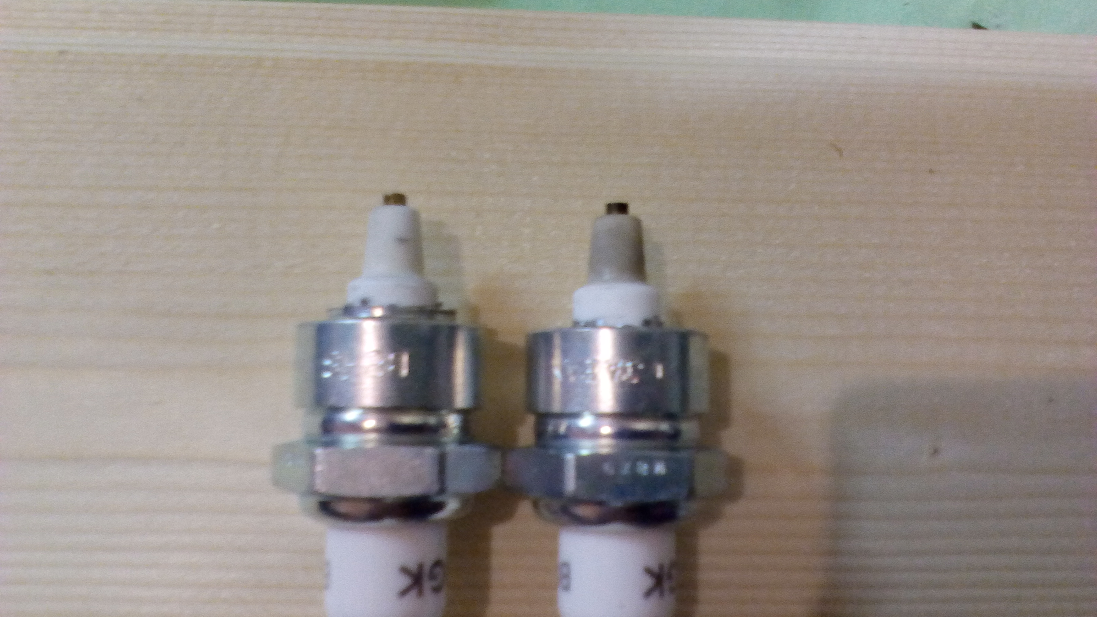

Postby otb123 » Fri Aug 30, 2019 2:53 pm
Well, I had a go at some plug chops, however pretty sure the results are no good due the run not being long enough...
Attached is picture of the plugs, the one on the left is at ~50% throttle and the one on the right wide open, however the bike did idle during the run down (the lights were on and I just clicked the key once, to the ignition still on position! :roll: )...
As I say I don't think the runs were long enough and were likely less than 60 seconds, need another go I think, I'd be very surprised if the 50% was as lean as it looks as the needle is already one position higher than the book says.
Plugs are B8HS.
What do you guys think..?

Postby Puffs » Sat Aug 31, 2019 5:30 am
Well, I think you ruined 2 excellent brand spanking new plugs - why on earth did you take the thread off?
Anyway, you can only read a plug after it has done quite some miles. No, 60 seconds is not enough. And with 1:50 in the tank + the oil pump working, it will be a rather greasy 1:25, so the one in the pic above looks quite normal to me.
If at full throttle, when you look in the mirror, do you see a haze of blue smoke behind you? Then the pump works.
I do not know what the top speed of an ETZ125 is, but I wouldn't be surprised if it maxes out at 55MPH (it also depends on your size & posture). I believe they are just 10HP.
Anyway, if it runs well, I'd just make some miles with it & lean-up the fuel with normal petrol, of course assuming you have said smoke.
When you started with both tanks full, you can estimate the pump's mixing ratio from the volumes added. Initially it will not be very accurate, but the longer you keep a record, the more accurate it will get. I'm actually doing the same thing at the moment.
