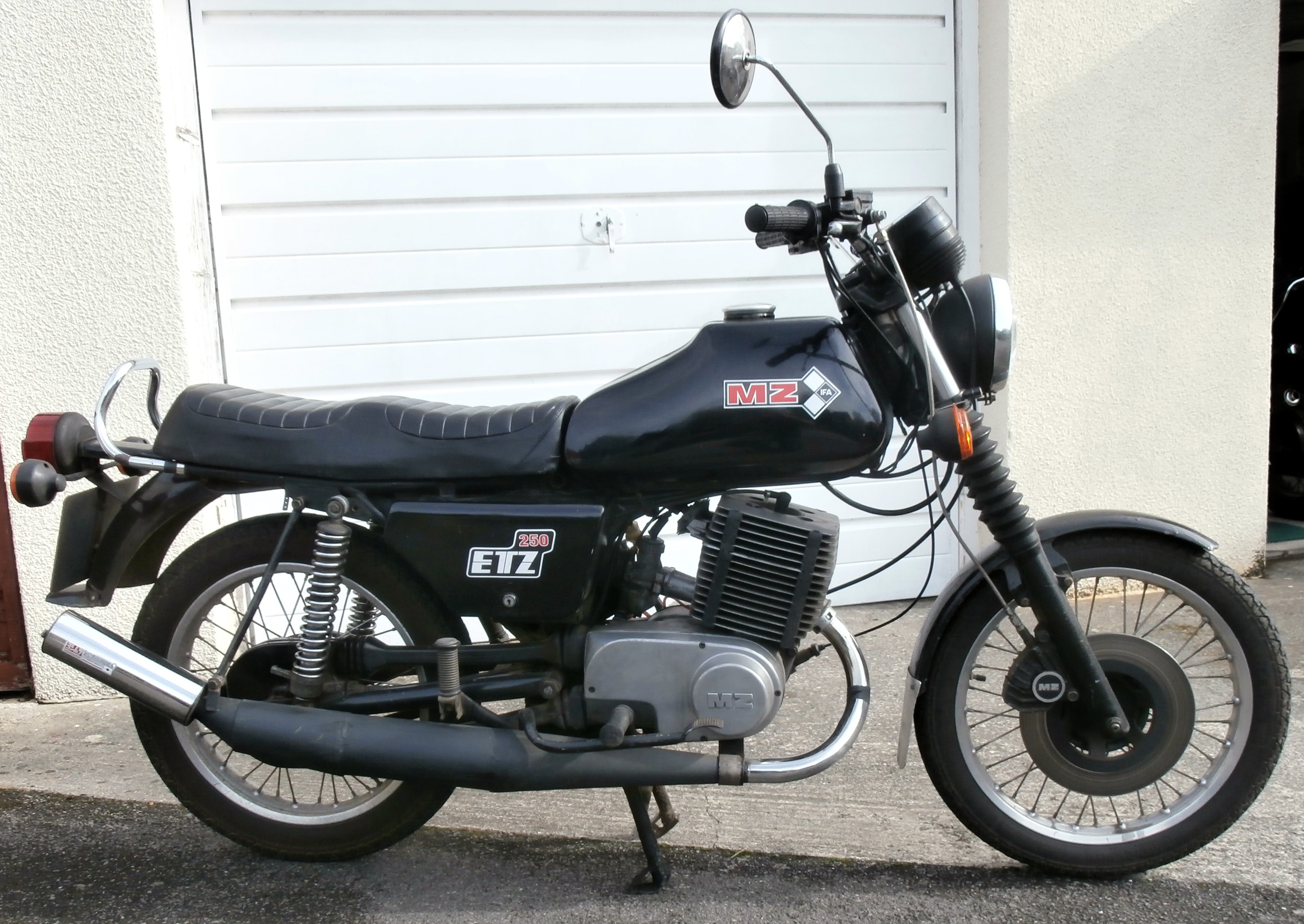

Strongly advise against buying one of the expansion chambers unless you are any good with a welder - I bought one very cheaply just to try it.
As standard the chamber is way too short for the sort of revs that a standard MZ does, and it robs the engine of bottom end torque and pushes everything higher up the rev range giving you a very narrow power band.
I modified the chamber by cutting the chamber in 2 and welding in a long "belly" section, the pipe now performs as well as the standard pipe in my opinion - it just sounds a lot better, and the engine seems to rev a bit more freely and feels a bit livelier.

Postby Andy_C » Sat Oct 13, 2018 1:16 pm
Here is a pic of my ETZ with the modified chamber on it.
Basically a 11" section welded in between the cones of the readily available chamber that pops up everywhere.
Without the welded in section you only have useable power abouve about 5000 RPM with the belly section inserted power delivery feels pretty much like it does with the standard system.
I like it because it does make the bike feel livelier as well as making it look a bit different !
