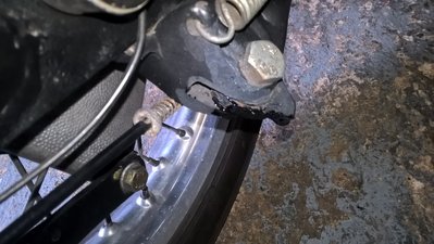

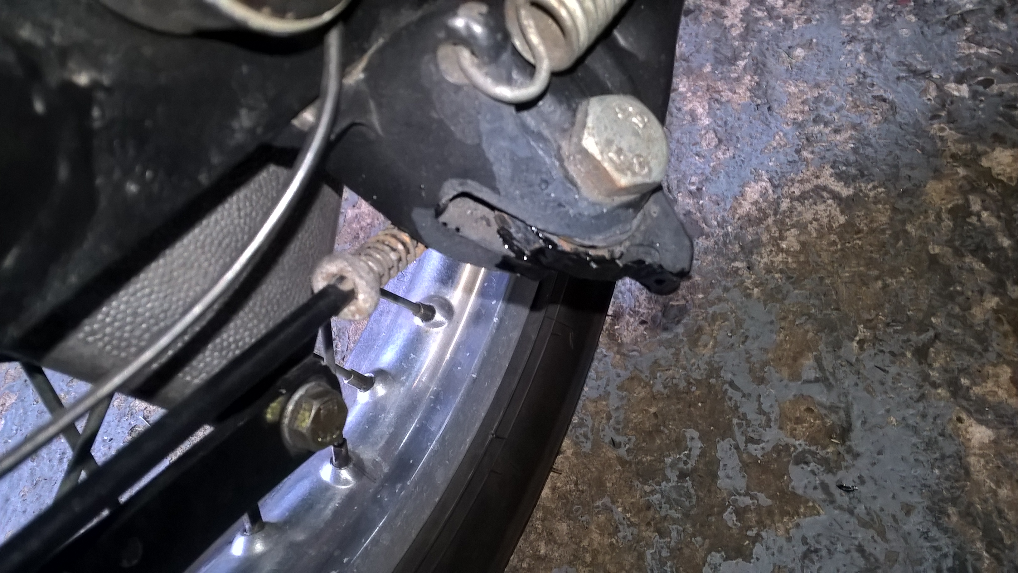

Postby akirasan » Thu Aug 30, 2018 11:45 am
I have cut away part of the 'stop' to allow the stand to point further forward and painted it too.
The bike is a lot more stable
