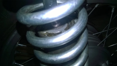

Can you even dissassemble the rear shocks and change the oil?
If yes, how?
Kruh
Posts: 149
Location: In the shed
Re: Fork/suspension oil for ETZ 250
Postby Puffs » Mon Mar 09, 2020 6:28 am
The original ones you can, unscrew the threaded ring below the bump rubber:
and you can pull the whole lot out. See also pg 90 of Haynes.
