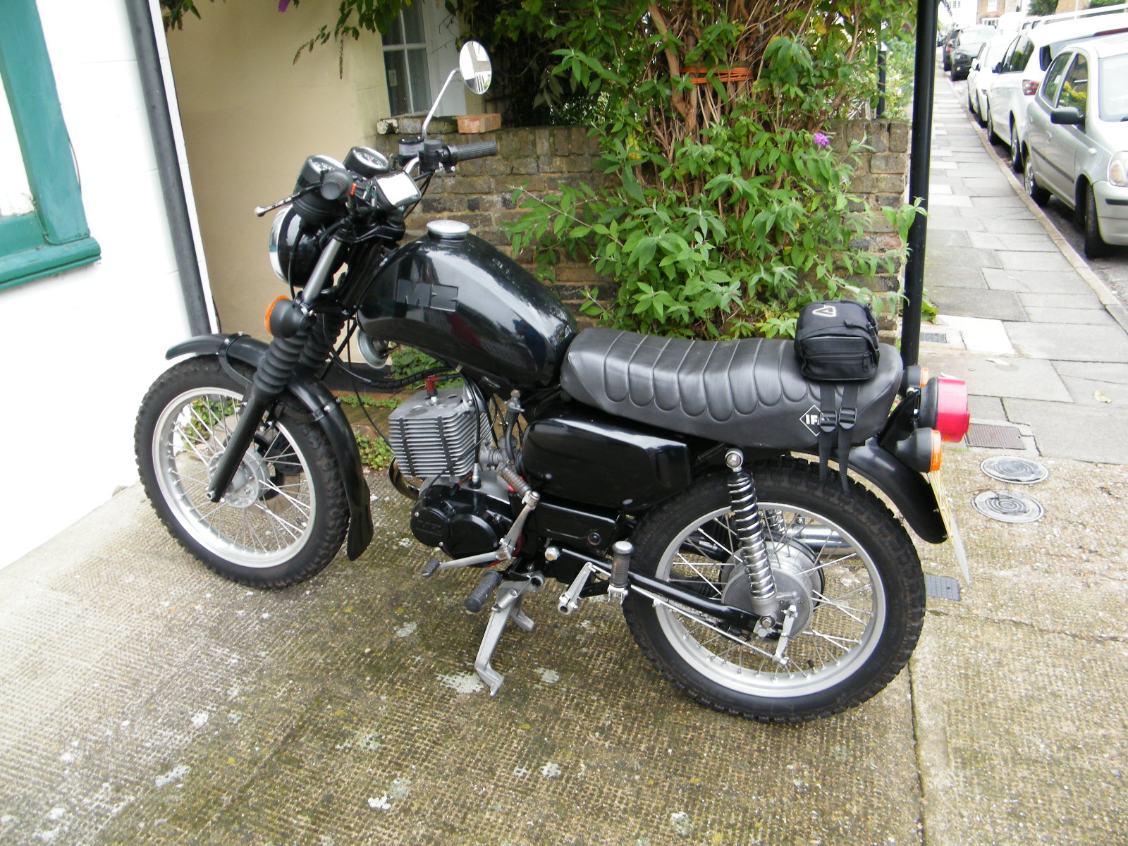

18" Rear wheel
The reason for the 18" rear wheel is to give the bike a higher ride & seat height as I'm just over 6' 2"

Eric, thanks for that pic & sharing your experience. It looks like when the bike on the centre stand, the tyres do not have much clearance, but it still works. The bike looks better with the bigger rear tyre (3.50x18 ?)!
You say you moved the swing arm cross piece forward by an inch; does that mean you took the swing arm completely apart, and re-welded the lateral bar 1" closer to pivot point? That would sure help & make clearance for the tyre, but it might weaken the swing arm a bit (the two lateral connections are then closer together).

Postby Eric Frith » Fri Jan 19, 2018 10:48 am
That's exactly what I did, but I used a slightly bigger section of box steel rather than the original piece of tube, I'm guessing at about 40mm x 25mm, placed a piece of large studding through the pivot end and the same at the other end to keep everything in place. Cut, ground and then welded, gave it a little tweak in the vice and then painted it.
