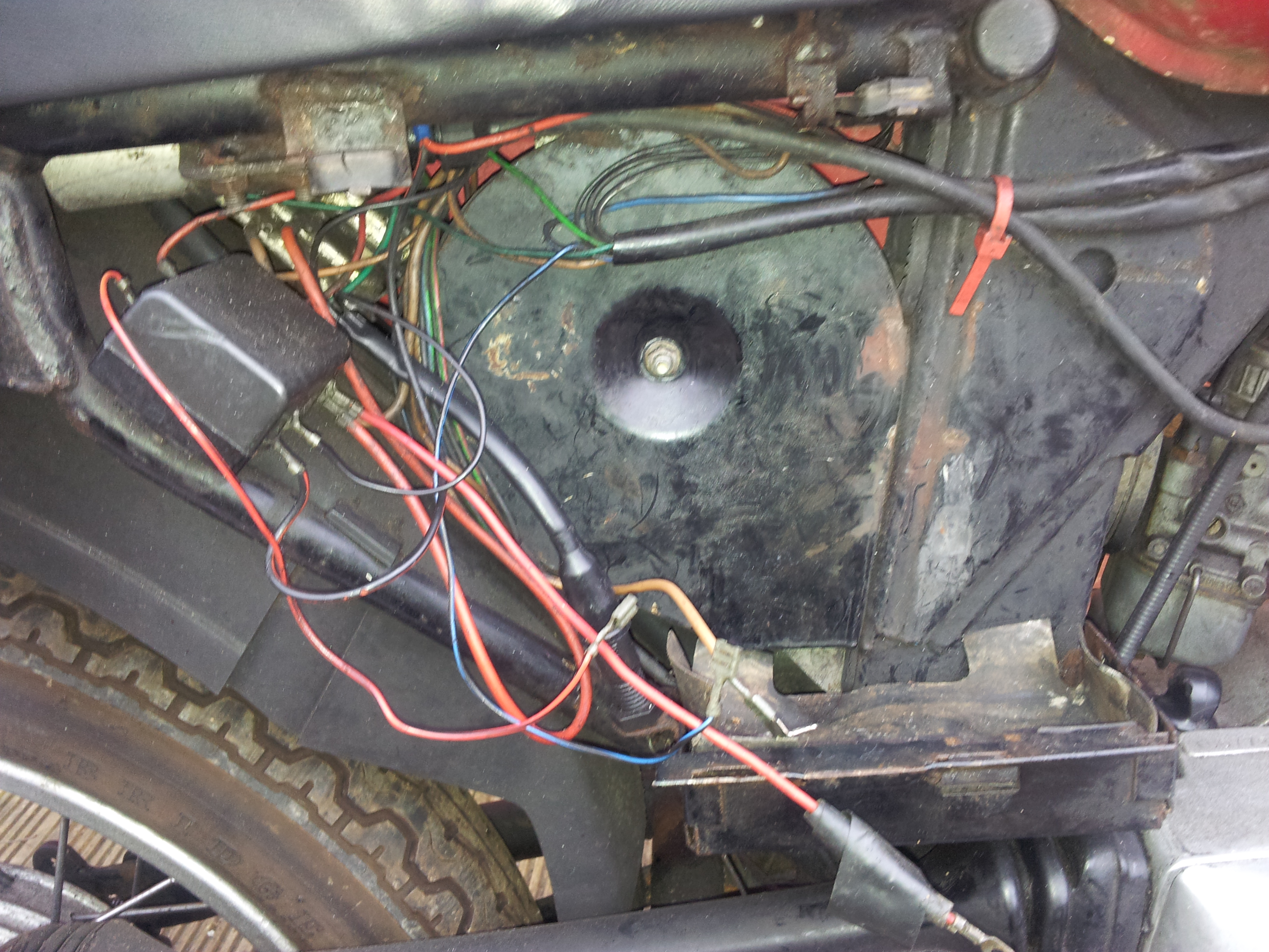

Just got an MZ ETZ251, opened the battery case to find a couple of extra wires that I am not sure about.
The main battery leads are easy to id but the other two (black/red and black/blue)..no idea what they should be connected to, any thoughts?
Can the 1991/92 MZ ETZ251 be started without a battery? it is the 12 volt version with (I think) electronic ignition
Thanks

Those two wires should go to the indicator relay..

Thanks, now I know I need to buy a flasher relay.
Do you know if these bikes should have a 9Ah battery.

Hi alexxx,
The ETZ 251-301 came with a 5.5Ah battery.
The ETZ 250-300 came with a 9Ah battery.
I'm sure I've heard that a 9Ah battery will fit into a 251 you will just need to check the dimensions .

Will it be ok to use a larger Ah battery? just thinking of old japanese bike where the indicators and lights would dim so much at tickover and at night..virtually nothing but a dim headlight at tickover.

I use an 9ah battery in my '90 251. It fits, physically in the provided space and although the headlamp dims a little at idle, it's no way near as bad as a magneto system. It's noticable, but not dangerous.
