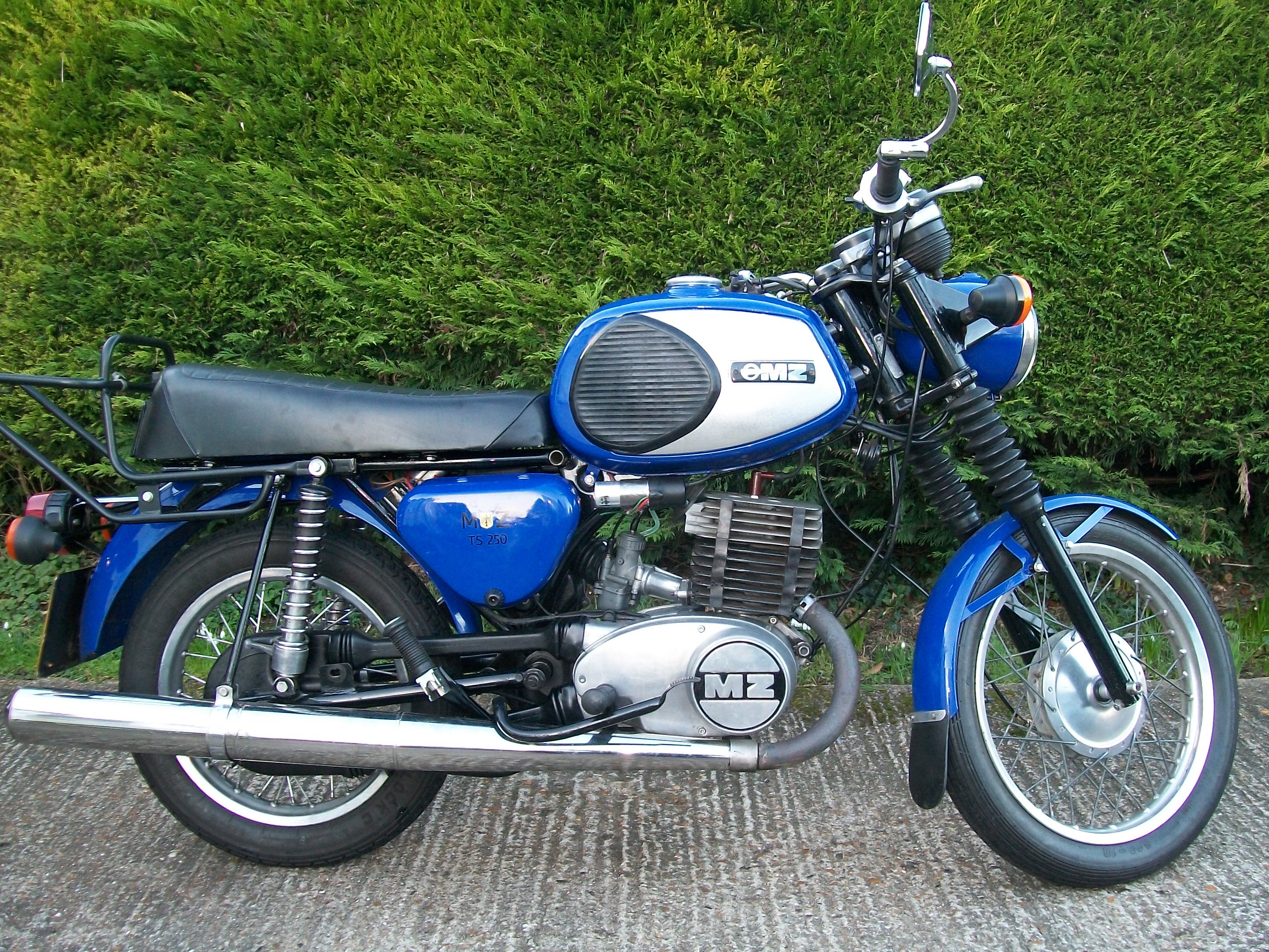

Postby JohnP » Tue Jul 19, 2016 10:31 am
Hi I am new to the Forum and I am here because I have a problem with my TS250/1. When battery is flat there is no spark on emergency switch position. When battery is charged and engine is running then it will run on emergency until the revs drop to a very slow tickover then it cuts out. It seems like it needs a few revs before it will go on emergency. What does yours do? Maybe this is normal and bumping it may be the only way to get it started with a flat battery....John P
This is the beast

Postby AlanJ » Mon Aug 29, 2016 4:24 pm
Hi John, Sorry am a bit late in replying, just noticed your added pic, bike looks good but why does the front brake cable go to the left side? Wish you well John Take care Alan.
AlanJ
Posts: 321
Re: Supa 5 Emergency Start
Postby JohnP » Fri Nov 03, 2017 3:06 pm
Sorry only just found your reply, it's got a Honda front brake!
