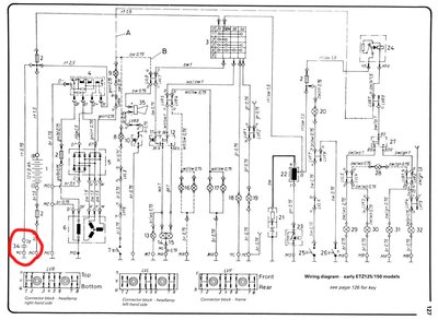

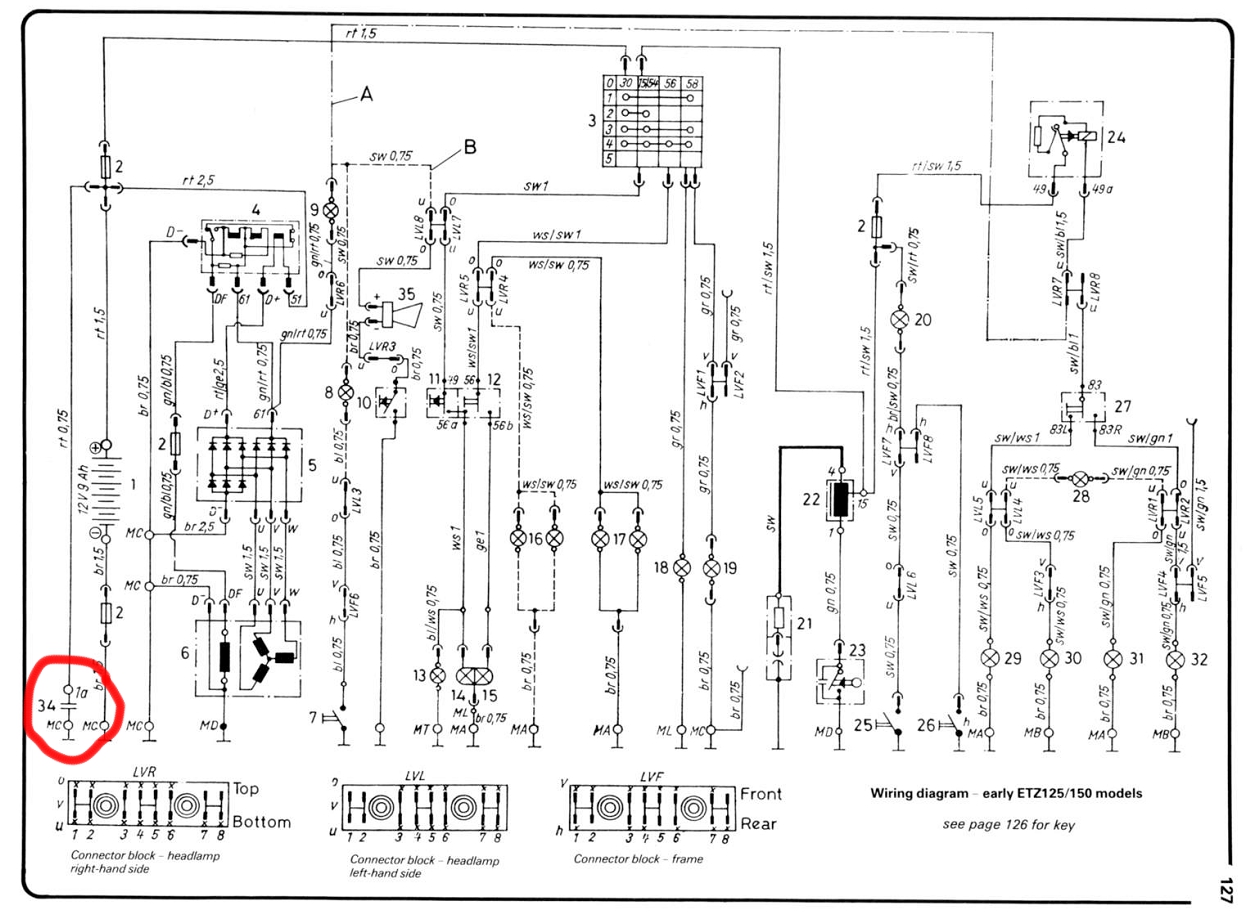

Postby therealche » Tue Jan 12, 2016 7:10 am
Hi Paul
Must say Ive never seen a capacitor under the seat either in real life or on a wiring diagram. However Ive just had a squint ( literally) at Haynes and there does seem to be a capacitor between the red wires and the main earth. Can't see what this would be expected to do apart from fry the electrical system if it failed.
Capacitor and condersor are are the same thing, they may look the same or they may look different, but in this case I would expect them to look similar ( cylindrical metal thingumy, not to be confused with the indicator flasher cyclindrical metal thimgumy )
And I can see no reason whatsoever for the extra capacitor!
Ive added a copy of the schematic to see if any electrical bods can see a reason for it

HOWEVER - the capacitor under the seat on your bike ( - mine also has one, by the way !.....) has a different rating and part no. to the ignition capacitor, which makes it NON -interchangeable for that purpose, in my limited understanding of these matters...... :?
Do you have an OE Owner's Handbook/Instruction Manual ? The (downloaded from the internet) copy that I have shows "Electrical equipment under the dualseat" in a line drawing fig. 35 and lists the capacitor (item #3) as "Interference supression capacitor".
HTH,
