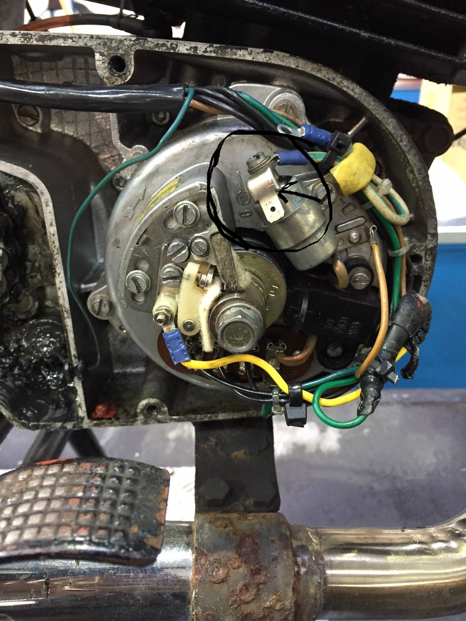

Here's a picture of the points/generator area that will hopefully give some indication of the kit.

Ah... it's the other end we need to see! It still has points so it is probably on of the electronic assist systems

Postby DAVID THOMPSON » Thu Jul 02, 2015 11:51 am
look at this pic at the high lighted area you may have a short to the condenser case
looks a bit close
click on pic to make it bigger
Re: Semi electronic ignition/click or tick
Postby Tome » Thu Jul 09, 2015 8:42 am
I'll have a look at that, it doesn't appear to be connected to anything so hopefully I can just bend it back a touch.
