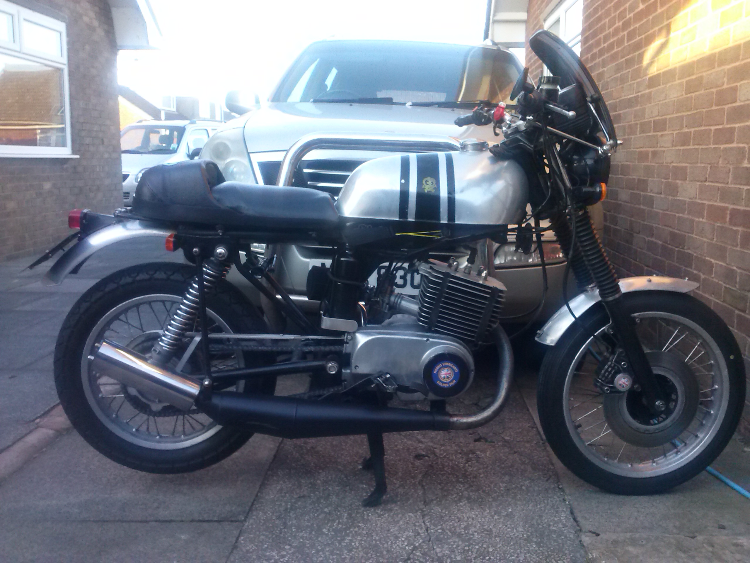

Just had my ETZ251 re bored what are the recommended max rpm, mileage till its run in. I would like to get the best out of my fresh bore/piston what did the factory recommend from new?
