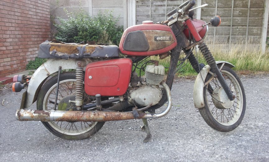

Hi, I just thought I’d say hello and introduce my project to the MZ community.
My name is Ian and I live in Cheshire (UK) and have just become the proud (??) owner of a 1980 TS150 (fitted with 125cc barrel and head).
The bike is in very poor condition having been sat under a sheet for over 20 years. I’m sure that it is not worth trying to restore the bike to as new but hopefully it can be rebuilt into a tidy reliable runabout.
Why an MZ? My dad is 77 next month and been a motorcyclist all his life (British bikes) and needs something to keep him busy over winter which he can then hopefully ride next summer as his days of riding bigger heavy bikes are now over. This bike had been sat in a friend’s garden and I couldn’t see it go for scrap when dad needs a project.
We’ve stripped the bike down and overall things don’t appear too bad. The engine components have all cleaned up OK but unfortunately the big end has seized and the crank seems shot. (If anyone has a good 2nd hand one for sale please get in touch ) Hopefully we can rebuild the engine gearbox with all new bearings and seals etc. but would like to solve the crank problem first. The clutch and gearbox seem ok so will be rebuilt with new springs etc.
The frame seems Ok so we’ll strip the forks, rear dampers etc. along with the wheels which are quite solid so again will be rebuilt with new bearings, seals brake shoes etc.
The electrics, carb. etc. haven’t yet been checked but a new headlight is needed at least as is a new silencer as the old one is like a sieve. (again if anyone can help with good 2nd hand parts please get in touch)

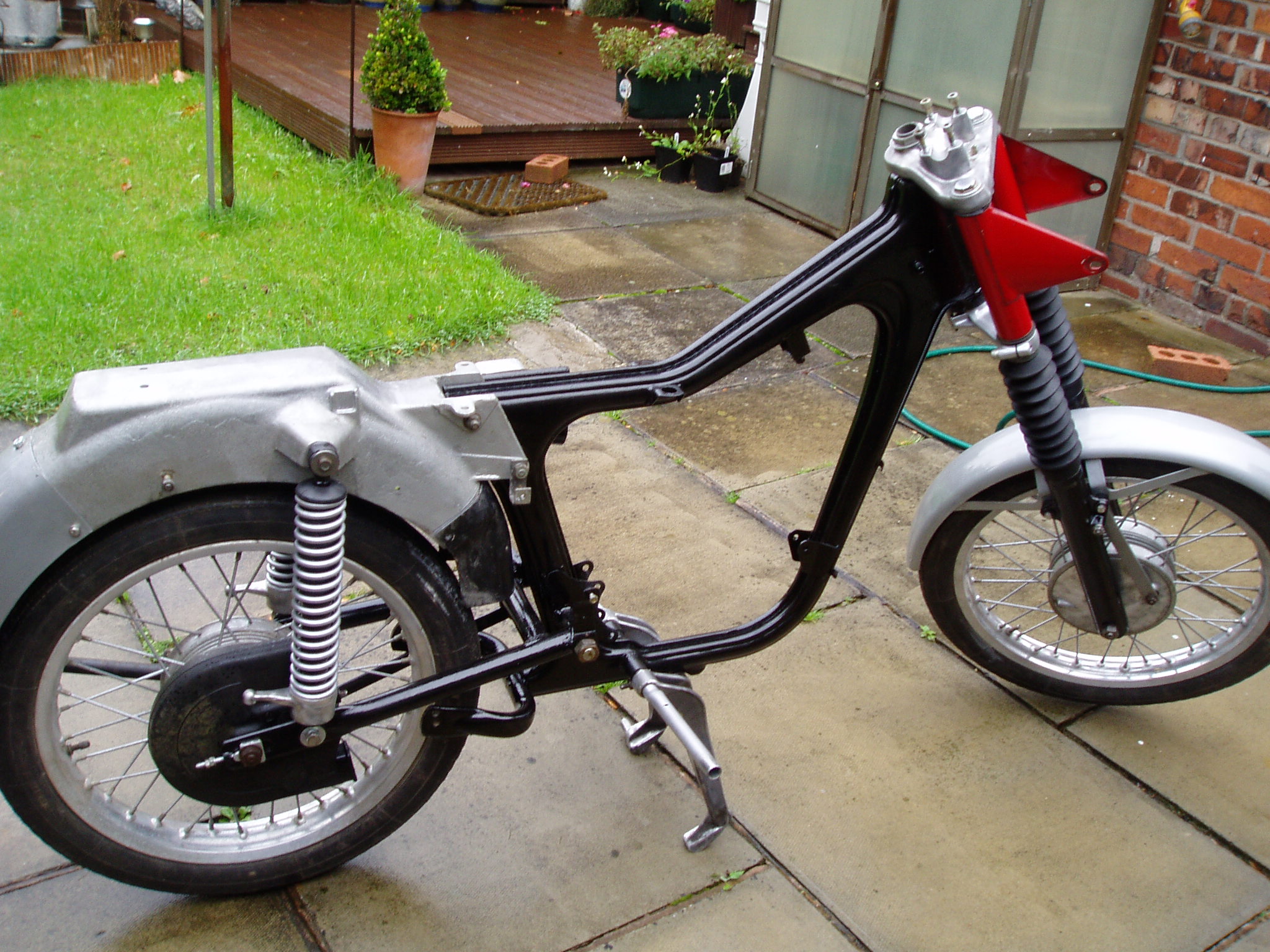

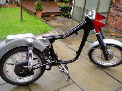

Postby ianc » Tue Oct 15, 2013 12:55 pm
Hiya,
Just thought I’d offer an update on the TS project.
We’ve completely stripped the bike down and have set about cleaning up all the parts to see what’s reusable and what need replacing.
The frame and swinging arm were OK so have been repainted and new sealed steering head bearings fitted.
When we stripped the forks there was no wear and the stantions were in excellent condition so the bottom legs and yoke were stripped and repainted and the forks rebuilt with new seals etc.
The rear dampers were stripped and checked, they seem fine so we repainted the springs and reassembled.
Plenty more work to do but I’ve attached a photo of where we are upto.
Cheers
Ian
PS Still looking for a crank assembly if anyone has a spare :wink:

Postby therealche » Tue Oct 15, 2013 3:18 pm
That's coming on great!
