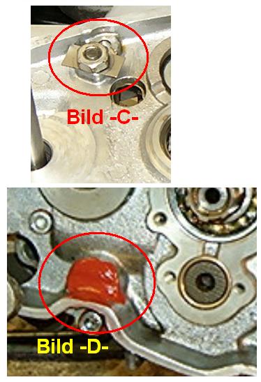

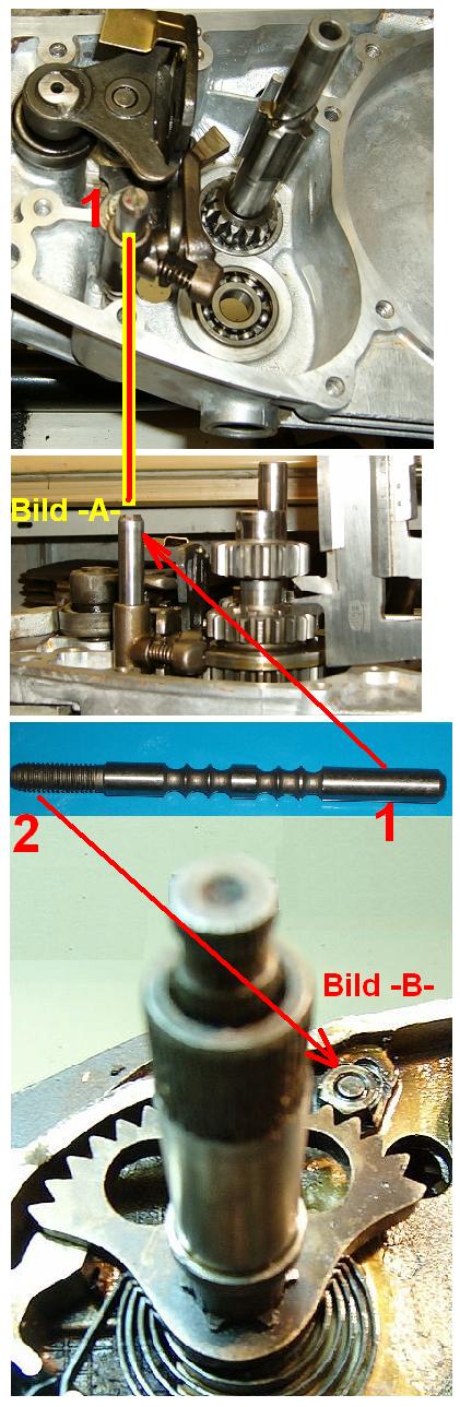

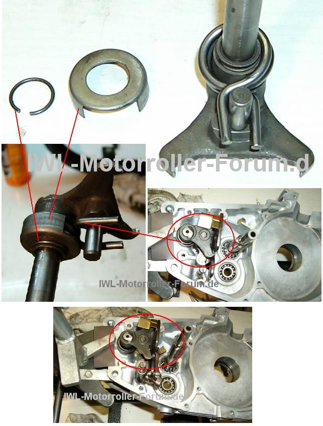

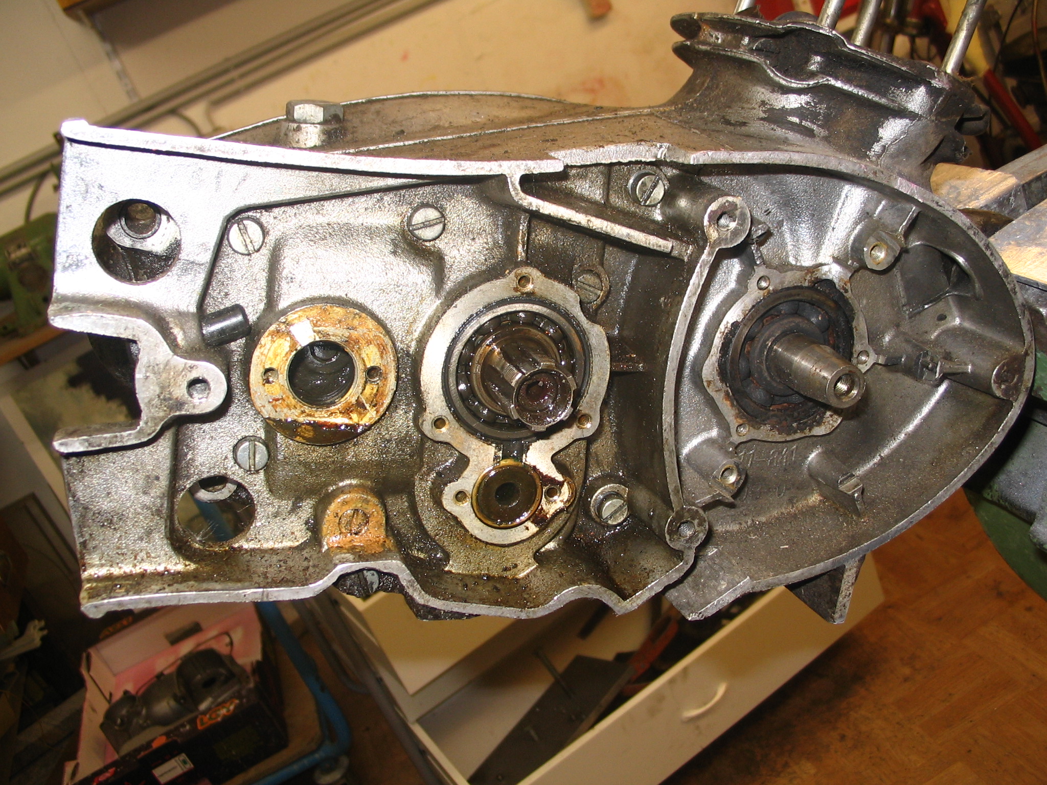

Can anyone show or tell me how this is supposed to look? It´s been a while since i closed this engine, can´t recall if there was an outside nut and locking washer, it would be easier to just look at another one and once this engine is running i can adjust it.

FerreiraAveiro wrote:Can anyone show or tell me how this is supposed to look? It´s been a while since i closed this engine, can´t recall if there was an outside nut and locking washer, it would be easier to just look at another one and once this engine is running i can adjust it.
There is a nut and locking washer on the other end ( clutch side) but nothing on this side

Postby therealche » Tue Oct 02, 2012 5:44 pm
My ETS is 30 miles away but I will try to find some pictures from another site

Postby therealche » Tue Oct 02, 2012 5:55 pm
That was quicker than I thought! Heres a few pictures from iwl-motorroller-forum.de , Its from a IWL Berlin engine but they are based on the same unit

Re: Mz Ets 150 1972 restauration
Postby FerreiraAveiro » Wed Oct 03, 2012 4:06 am
Thanks a million!!!
That screwdriver´s end got me confused, thanks again. How common is it to seal the top with silicon to avoid leaks on these engines?

Postby therealche » Wed Oct 03, 2012 9:28 am
I usually stick some sealant over it, just to try to keep as much gearbox oil where it belongs!

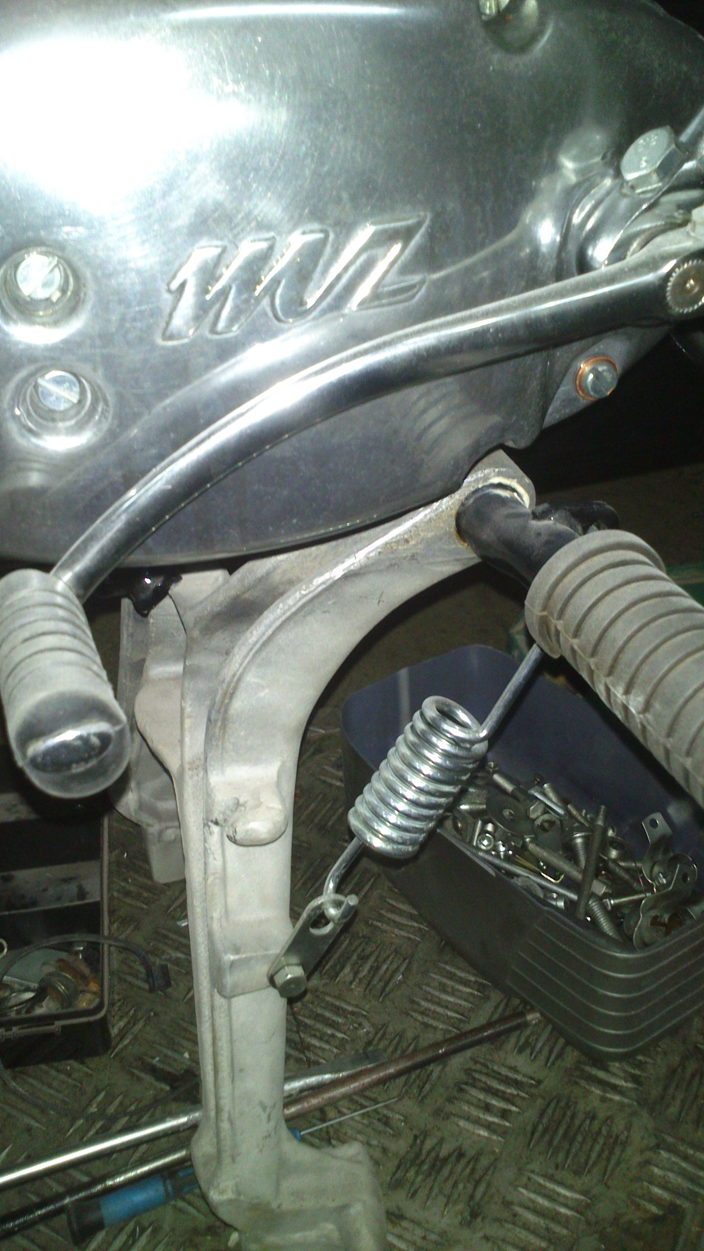

Postby FerreiraAveiro » Fri Dec 13, 2013 7:32 am
Hello again everyone, i havent finished the bike, but it´s close :D
I need some help about the center stand springs:
download/file.php?mode=view&id=3512
Can anyone tell me what part number spring i need to add there, so that the stand will stay in its position once closed? It just hangs now.... this spring is new but not enough to pull it back up.
Thanks in advance.
FerreiraAveiro

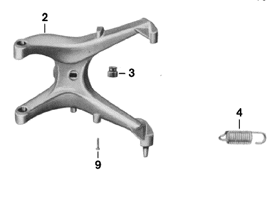

Postby therealche » Fri Dec 13, 2013 5:58 pm
That`s a fine looking bike! The centre stand spring part no is 13-21.177, same as for the ES and TS. Length is approx 105mm. The problem might be this bit (A), which is not original.The spring should hook on here (B)
mz stand spring.JPG (71.45 KiB) Viewed 7853 times
As in the MZ parts book
