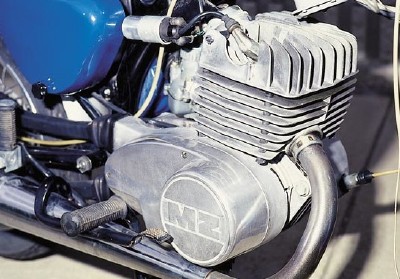

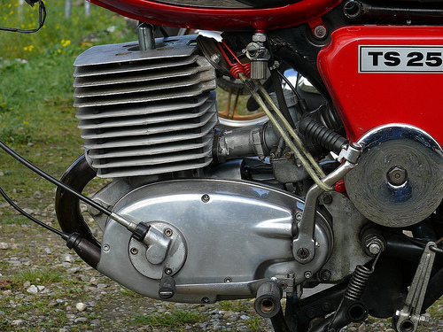

Postby therealche » Mon Oct 01, 2012 4:36 pm
4 speed engines have a head with vertical fins and a inspection plate in the top of the crankcase, 5 speed have the horizontal fins and no inspection plate IIRC
therealche
Posts: 702
Re: TS 250 crank seals
Postby therealche » Mon Oct 01, 2012 4:41 pm
5 speed TS 250/1
4 speed.jpg (54.24 KiB) Viewed 3806 times
4 speed TS 250
