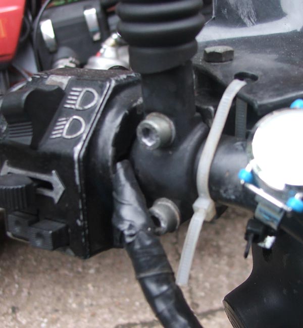

Had a worn out mirror boss on Emzie when I bought her, so I replaced the rear clamp on the clucth lever with the one below.
replacement mirror clamp
This allows a japanese mirror to be fitted, as they are more available.

The ETZ (brembo) has M10x1.5 threads. Cheap pattern mirrors have very loose-fitting threads as standard and two nuts that lock where the original one has a tapering nut.
The 250 RS had ETZ-Saxon mirrors but Brembo brake and levers.
The ETZ-Saxon has very good mirrors with an M10x1.25 thread. The Saxon mirrors screw into a half-clamp like the one in radiograf's photo. You could fit them to the brembo levers.
I've seen photos of accessory mirrors that fitted to the lever pivot/were the lever pivot. They didn't look very robust.
With brembo levers and Saxon half-clamps you could have four mirrors. You might have to wear a parka with that combination!
The previous paragraph is a feeble joke about mods and scooters which cannot be translated into American.
If the thread for the brake side really is worn a thread insert or helicoil kit will start to look like a cheap option.
