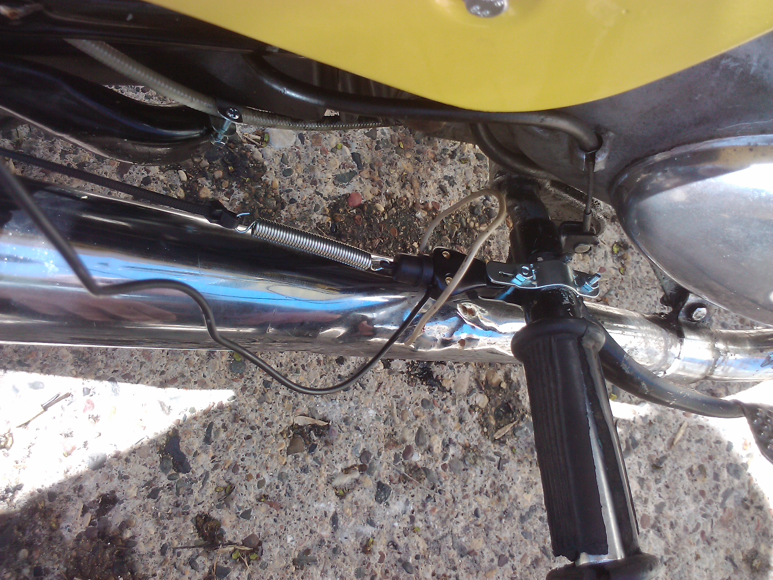

I was having too many issues with the contacts coming loose and not working on my front and back brake lights so this is what i did. The part is a Harley custom lighting switch i ran the black wire from the relay to the switch and then just grounded. Took me a minute to find just the right spot to get it to engage and disengage but with a couple of zip ties. You cant see here but i ran one zip to the passanger peg and used just the end of another zip as my adjuster.
