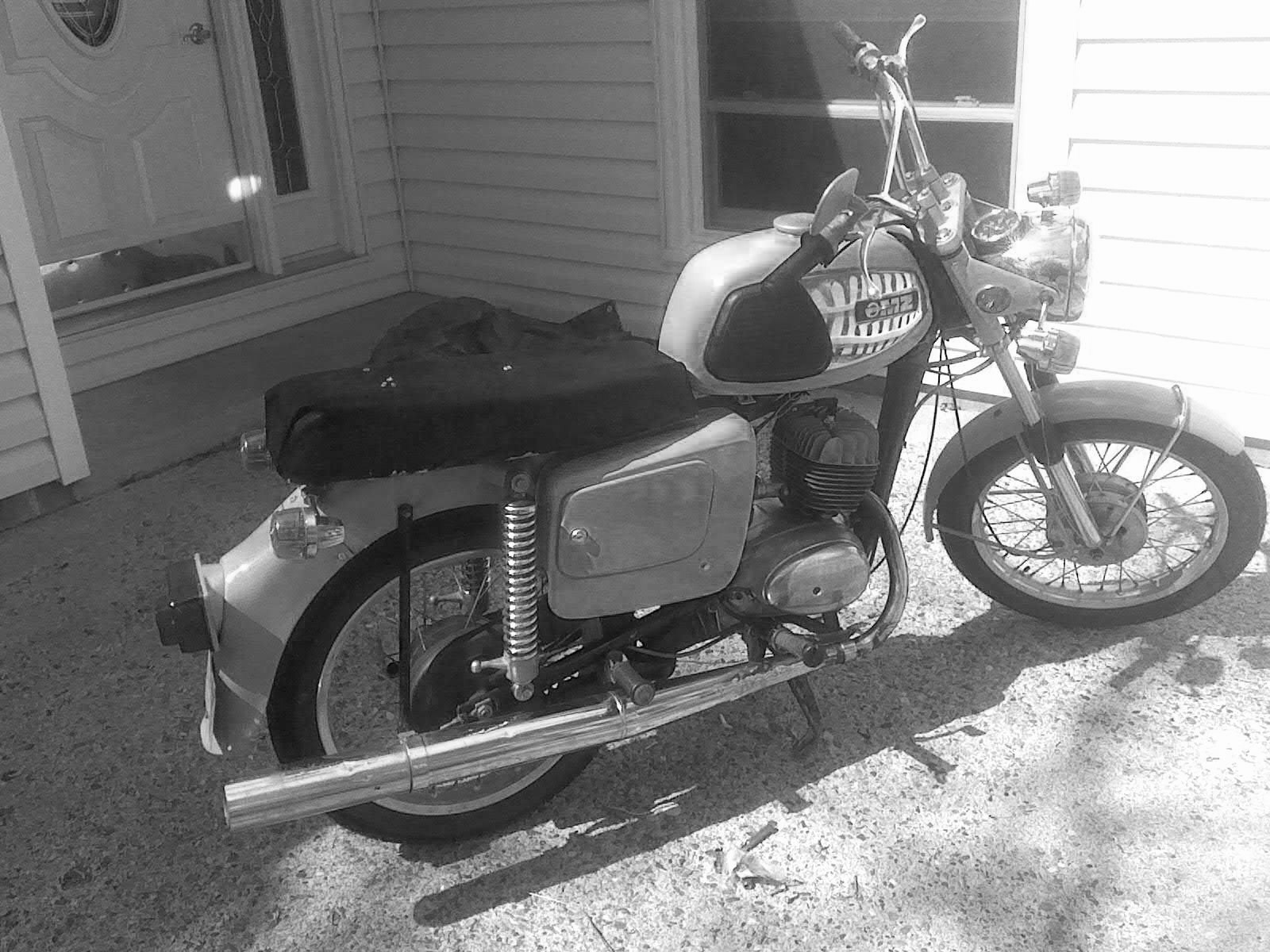

Postby ghostinthemist » Mon Apr 09, 2012 8:53 pm

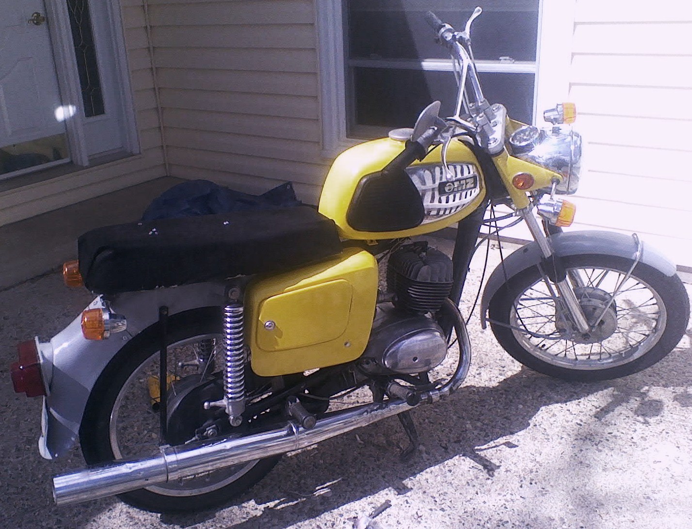

heres a couple of pics i did the one in bnw for nostalgic purposes

Postby ghostinthemist » Mon Apr 09, 2012 9:58 pm
the one thing i love about every MZ pic i have on my comp is that there is a secondary picture provided by the shinny side panel in every picture that shows Germany and England in the background. This one is I think a very stereotypical American reflection.

Postby therealche » Tue Apr 10, 2012 5:28 am
What a sweet little bike. Take your time running her in. Unlike modern motorcycle the cylinder wont be as finely honed so takes more running in. I have always been interested in the way MZs morph between models. Yours is a TS yet to me the only bit that is TS is the tank. The rest ETS.. the forks, headlamp etc. And then there are the differences between on the bikes for the American market. Lucas indicators and rear light, those side reflectors on the headlamp brackets.
Mind you I am the kind of person who gets a strange pleasure pointing out when people have put rear lenses on front indicators on the german indicators. I need to get out more!

Postby ghostinthemist » Tue Apr 10, 2012 9:49 am
The front forks are of the ts model just there are the newer integrated telescopic forks that were put on in late 74 models in England along with the Lucas style lenses that were on these. I choose to find ones that were as close to the German ones as possible. The headlamp is a Lucas not an ETZ these were fitted to comply with American standards.

Postby therealche » Tue Apr 10, 2012 12:39 pm
Don't like to contradict you........BUT....... the forks are the early forks as fitted to the ETS between 1969 and 1973. These have chromed steel bottoms and are just about impossible to take apart unless you have the proper tool, and even then it can be a total pain!

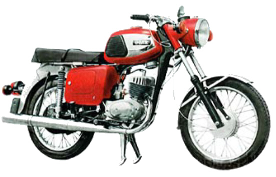

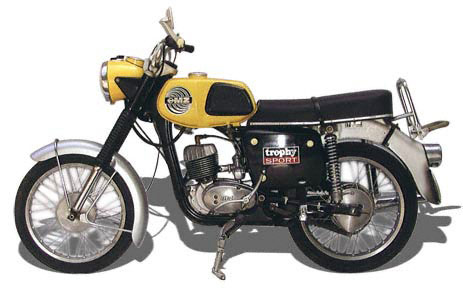

Here is a picture of an ETS 150
Then there came your TS150. If memory serves the tank, rear aluminium part of frame and seat are different to the ETS
Then comes an intermediate. This has the later forks with aluminium sliders , which necessitates a different front mudguard and brake plate.Also has a different mounting for the rear light
And finally the last incarnation of the TS150. Later forks, different headlamp, and rev counter and speedo on aluminium dog ear brackets
So there you go, a quick history of the evolution of the TS150!

Postby ghostinthemist » Tue Apr 10, 2012 1:57 pm
im confused because the American Haynes shows a ts 150 for my manual is exactly the same as my bike just red?! I think they did whatever they wanted depending where they were finished. The picture says it was taken in chicago?

Postby therealche » Tue Apr 10, 2012 2:59 pm
No need to be confused! You have an American version 1974 TS150. However apart from the tank and seat the bike was the same as the ETS150.
However by 1977 the front end, instruments, headlight and rear light had been changed. However MZ never changed the model name!
