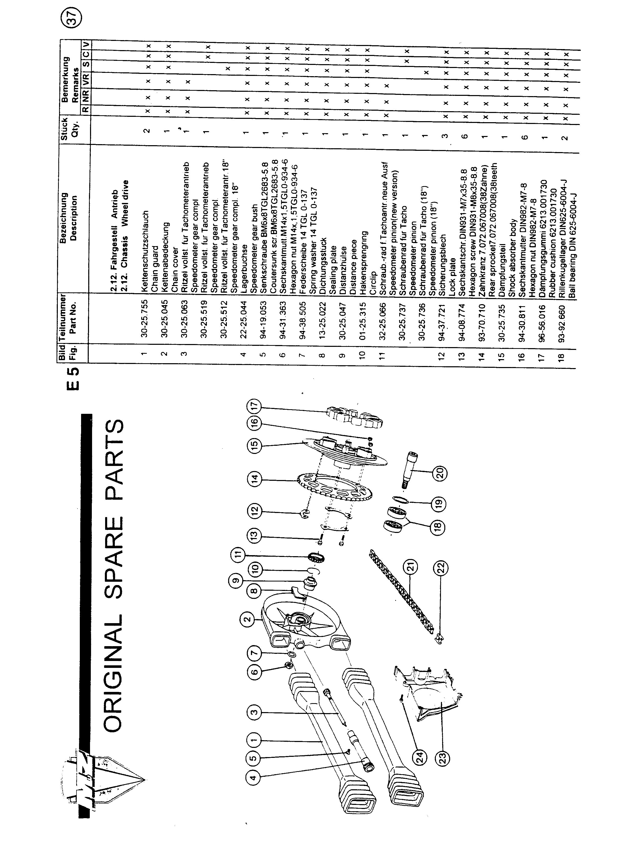

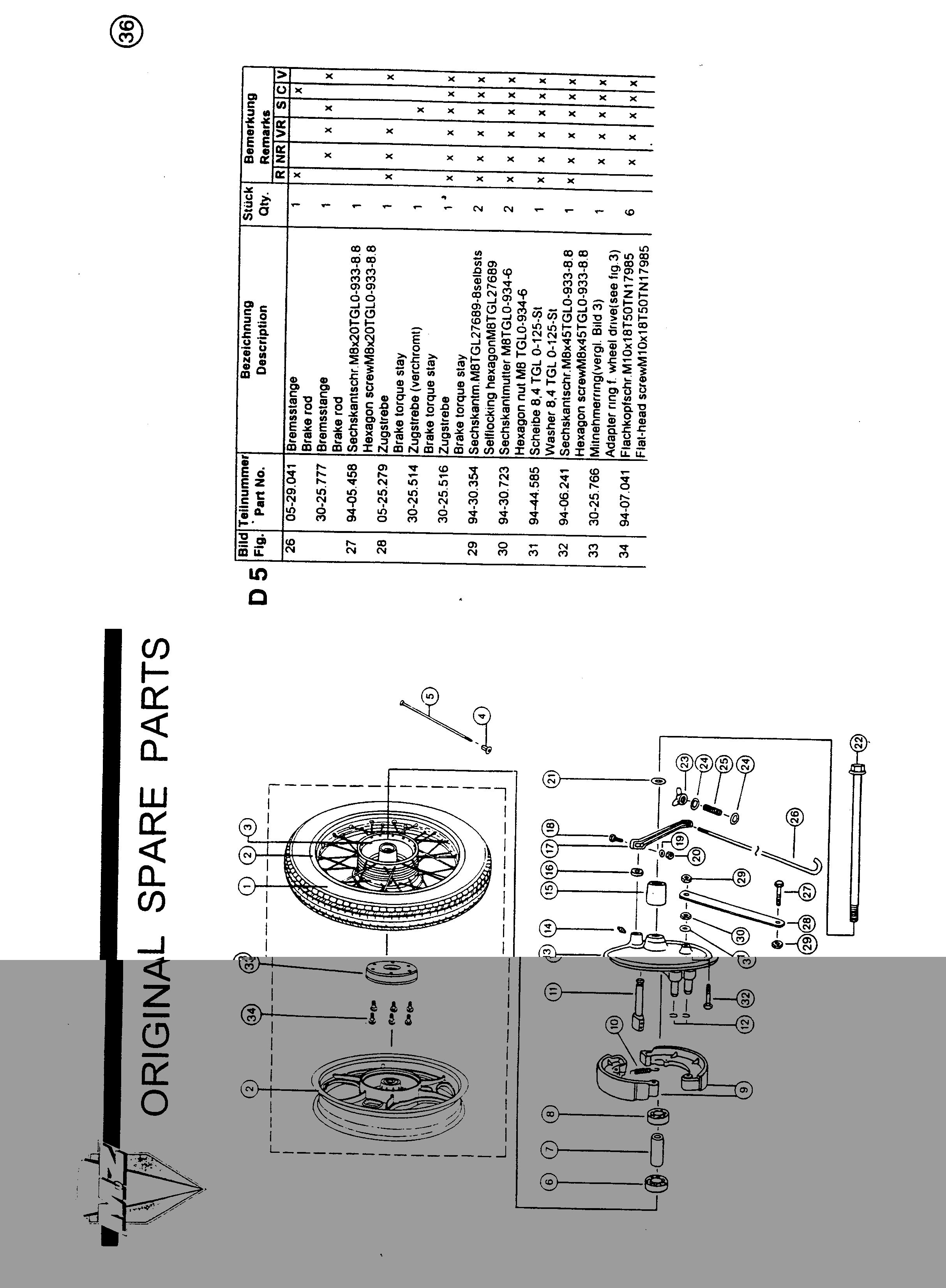

bolt is on left side hold nut on right do not turn nut on right
remove bolt on left wheel will come off
the brake rod needs the nut off of it a spacer comes out and wheel and the brake shoe housing come off together
there is also a bar bolted to brake housing
the other nut removes the other side and adjusts the chain it also holds sprocket carrier and the speedo drive
is not to be removed unless you need to a full clean and service
best to down load pictures to view in a picture viewer or print
click on picture to show full size
