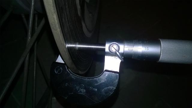

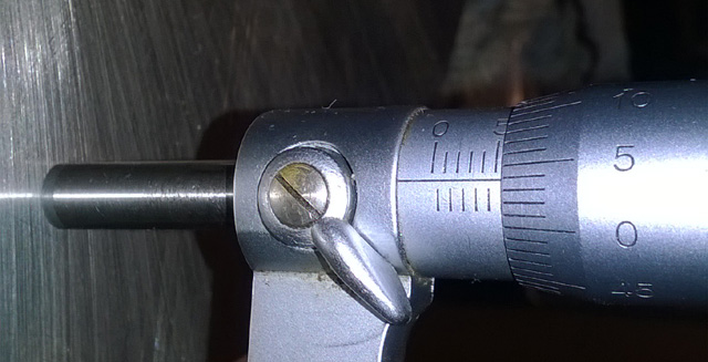

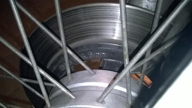

Over the years, the front disk rotor of my '89 ETZ 251 has become significantly below spec:
Min. TH = 4,5mm
TH = 4.15mm, in 2021

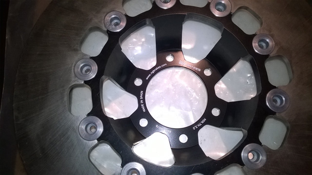

Now one of the things that happened during my absence from this forum was that new brake disks became available, with specs equal to the original disks. That means you can keep your hub & calliper, just take off the old one & fit the new one. So I ordered one of those disks (from Guesi, but several traders can supply them).
NG Brakes BRN30978, min. TH = 5.0mm
Being a floating disk it looks a lot more modern. Also see the minimum thickness is specified at 5.0mm, while the thickness new = 5.54mm:
TH = 5.54mm

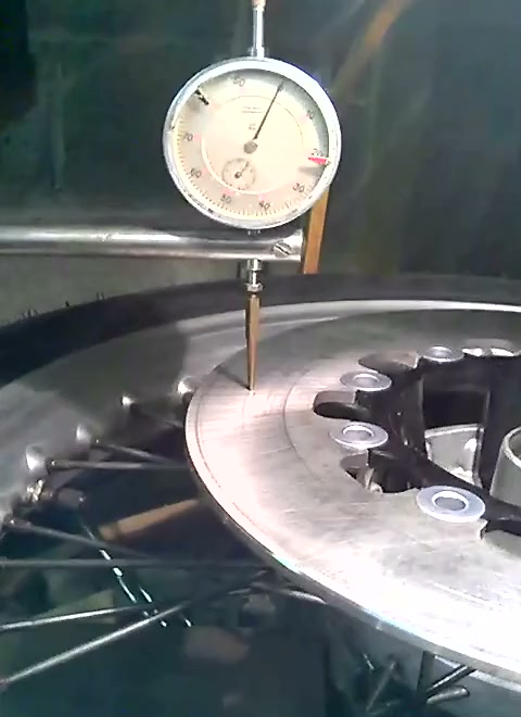

Easily fitted, I could not help measuring runout:
Measuring runout on NG Brakes rotor
A video of that can be seen here: https://streamable.com/gvjgqc, but only for a few days after posting. It wiggles 0.02mm or less, which is fine.

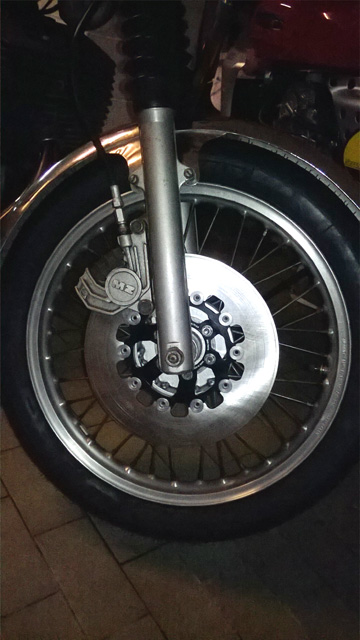

So, there we go:
The Spanish stroll
Of course it works fine. Soft pads may be best, as it can have a tendency to squeak a bit. And also, softer pads may cause less disk wear (though I'm not sure of that).
