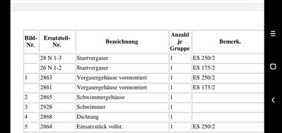

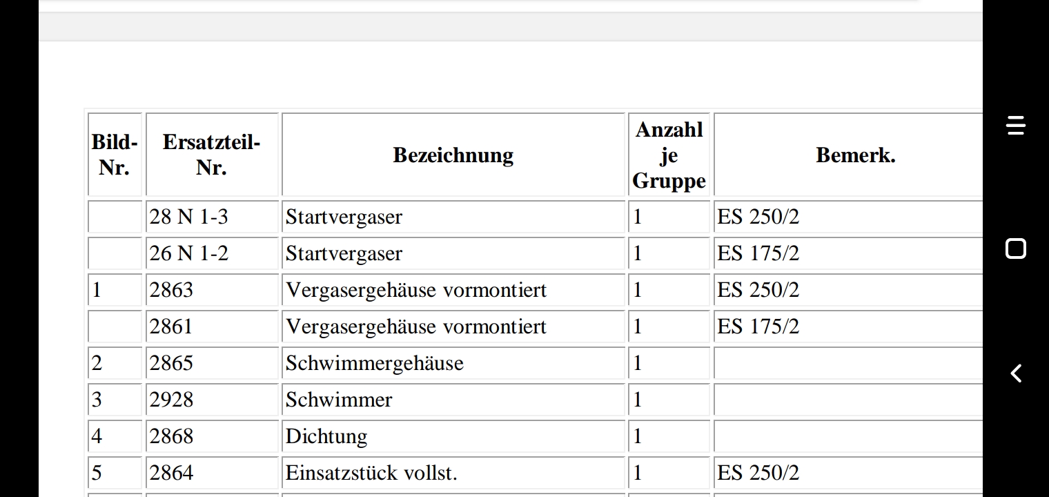

I know nothing about carbs or the es175 but for what it's worth the MZ parts book gives 26mm for the ES175/2.

I beleive the 175 has 26mm, and the 250 has 28mm.
