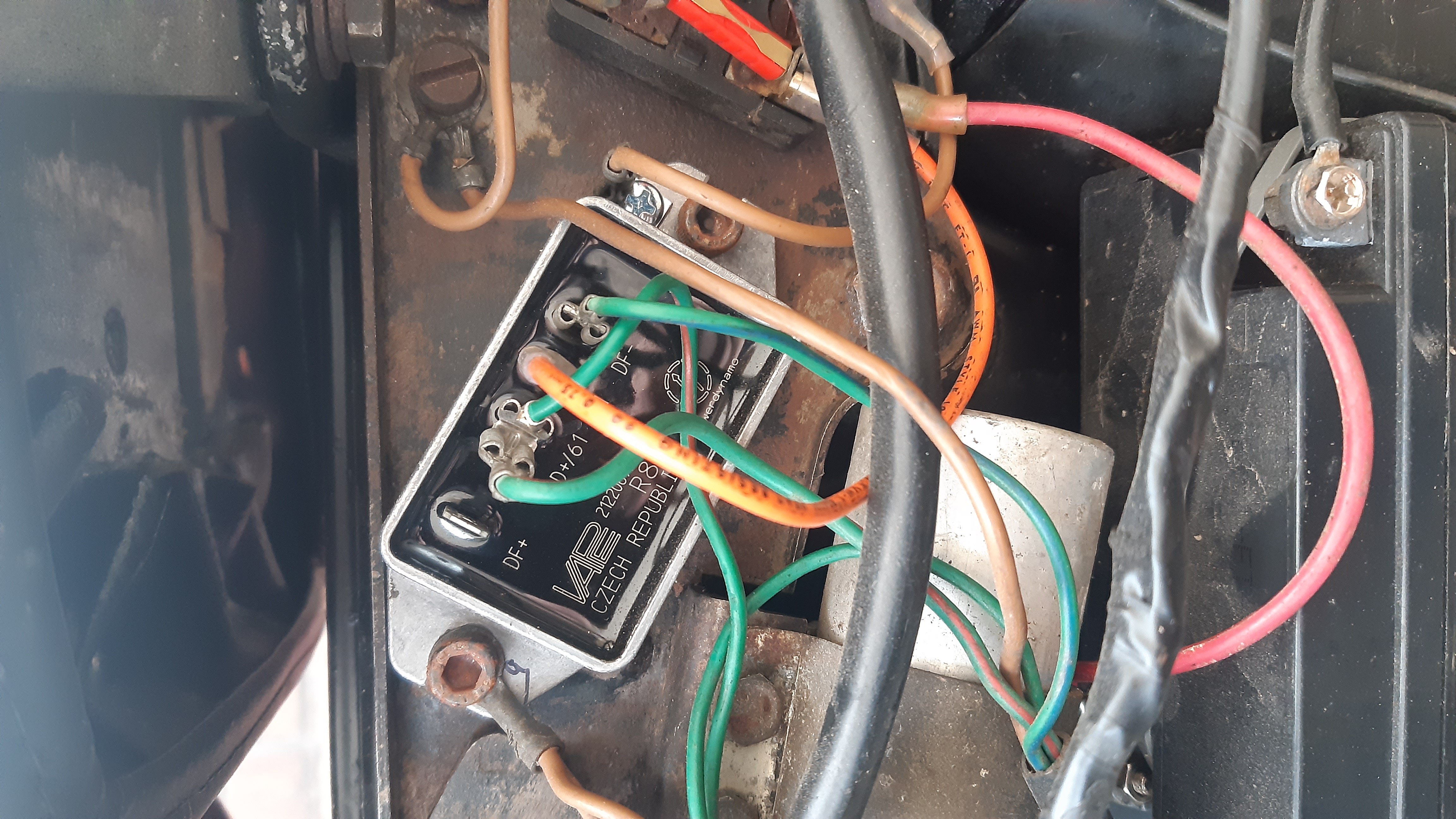

I was out on the TS125 the other day and as the sun went down I deployed the headlights and noticed the charge light was on dimly.
As the journey progressed the light went on and off a few times and then stayed on permanently.
The bike got me home, but the problem remains.
Running a few tests, the light actually stays off at tick-over, but comes on as the bike is rev'd.
I've checked the dynamo brushes which seem to have plenty of wear left on them.
The bike is fitted with some kind of solid state regulator.
I'll try and attach a video of the light and a photo of the regulator.
Are there any tests I can run?

Postby breakwellmz » Mon Jan 01, 2024 3:25 am
From your photo the earth connection top left looks suspect. As it`s easy and simple to do I would sort that, and clean all other connections as well first.

Postby stevebod » Fri Jan 12, 2024 12:00 pm
I have been through the wiring and have cleaned up earth points and checked for loose connections.
I found the orange wire at the regulator was sometimes arcing/failing when it was jiggled. So I pressed the crimp tighter to make it secure.
Today I fitted new brushes to the dynamo too.
The light now stays off unless the headlight is one.
Then it glows dimly. Not sure if this is problem - perhaps not.
