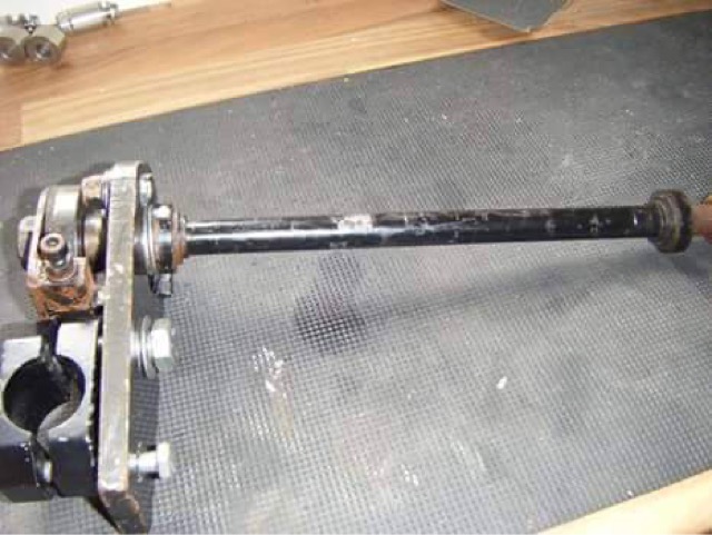

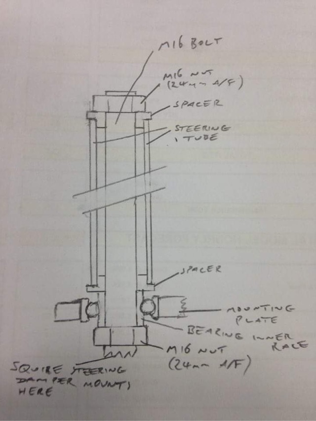

Postby mr_luke » Sat Jan 14, 2023 1:49 pm
I'm afraid I don't have it anymore. Wish I did!
I don't have any photos of my own, but looking back through some old emails I found a (slightly rubbish) sketch and a photo of someone else's. Hopefully of some use?

Postby lavrentyuk » Sat Jan 14, 2023 2:35 pm
Splendid, and useful. Thank you.
