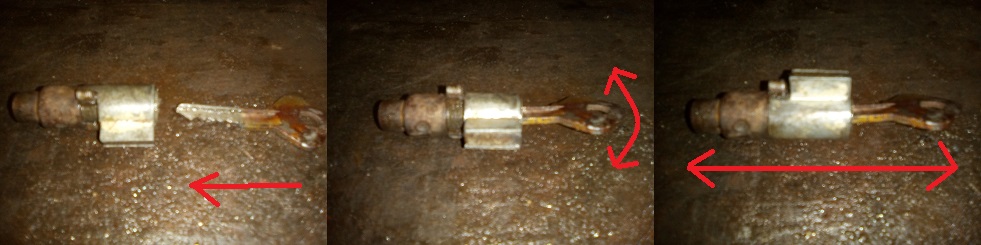

The steering lock doesn't work by inserting the key and then twisting and taking the key out. What you need to do is insert the key, turn it, then push the whole assembly (key and all) upwards into the yoke, you must then twist the key in the reverse direction and then you can pull the key out. All the lock does (by use of the key) is spin a tang inside the steel tubing (which has a sort of H pattern to it) to be able to move it up into the yoke (to then twist it again and lock the whole assembly), or indeed to pull it out altogether.
However, it is a seperate key to that of the side panel- the steering lock key is a lot longer and has more neck in order to be able to adjust the height of the barrel.
EDIT: I've actually been working a bit on this tonight as it happens with my ES cylinder that had the key stuck in it. It is slightly different, but the principle is exactly the same- except on the ES model in order to remove the steering lock you seem to HAVE to remove the whole cylinder. There's no lockable portion on the ES (and maybe TS?) that you can lock the cylinder into position without it engaging with the steering system.
Anyway, as you can see- the key itself can only be inserted, or removed one way (when the turning cylinder tang and the base tang are on 90 degrees axis from eachother). Once inserted the key can be spun and that spins the lockable cylinder allowing you to align the tangs to the same axis and move the whole unit inside the bike to engage (or disengage (where the lock stays on the bike but isn't engaged into..)) the steering system, or indeed remove the lock entirely. Once you have locked it into either position you can take the key out.
For the ETZ, with the lock flush with the steel tube end, you need to turn the key anti-clockwise and push the whole assembly upwards into the yoke (handlebars need to be turned to the right) where you can then twist and therefore lock- you can then take the key out after twisting key clockwise again to engage the tang.
