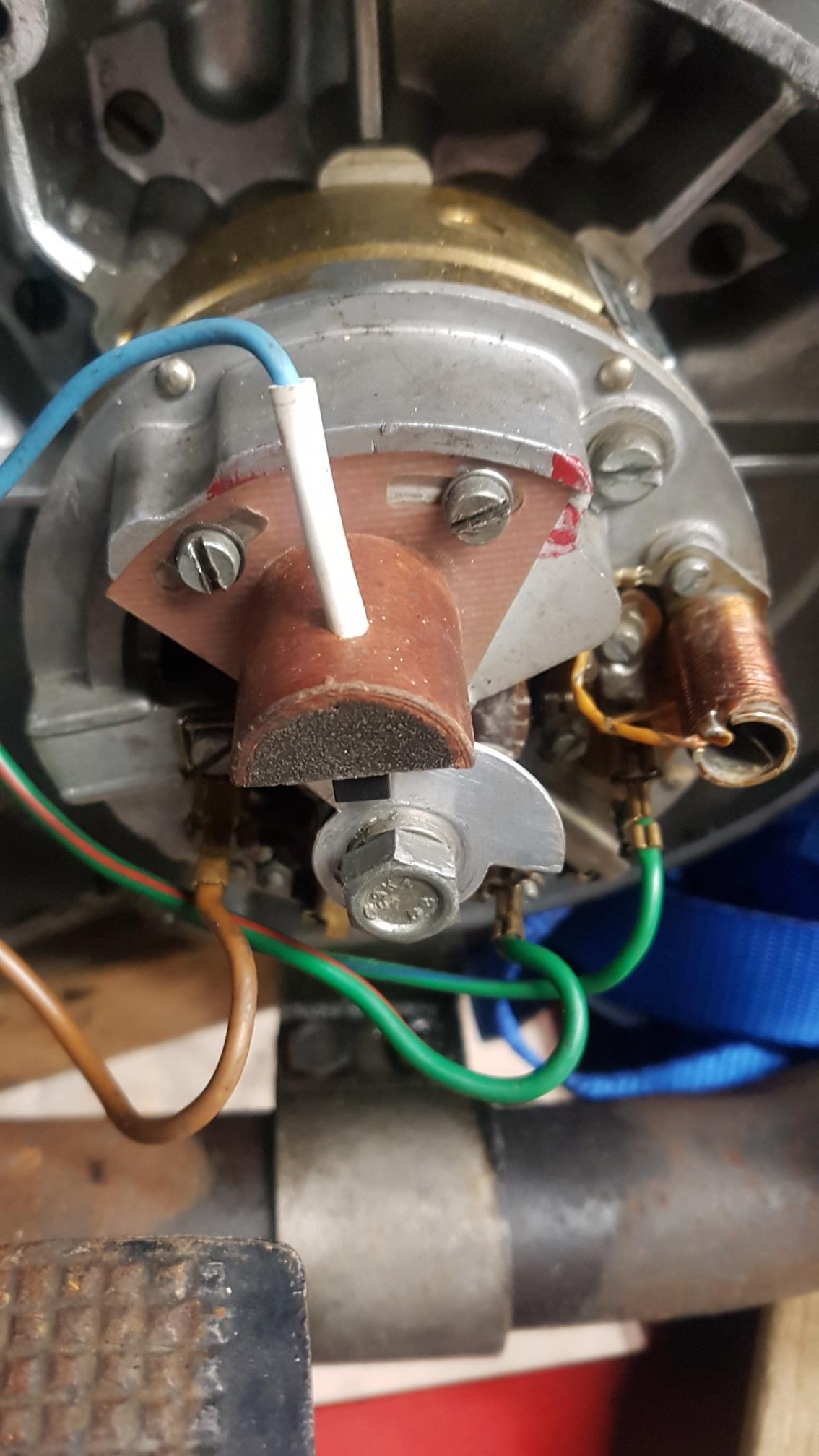

Postby sidewaysid123 » Mon Oct 25, 2021 6:26 am
The plot thickens, I have just returned home from my workshop where I have spent a couple of hours on the MZ, I took the cover off to see the points, only to discover it is some form of electronic ignition, there was a blue wire coming from the sender, and I followed that only to see it was connected to a green, which went onto a terminal at the square box which may be a rectifier, and from this unit went to a green and a black to the coil, I will post pictures of these units later, I think it is an aftermarket ignition and it has gone pop! Afterwards I went inside the headlamp, and for a bike of it's age it looks very clean and un molested.

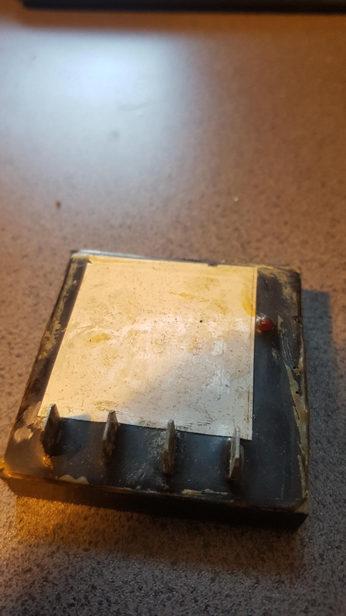

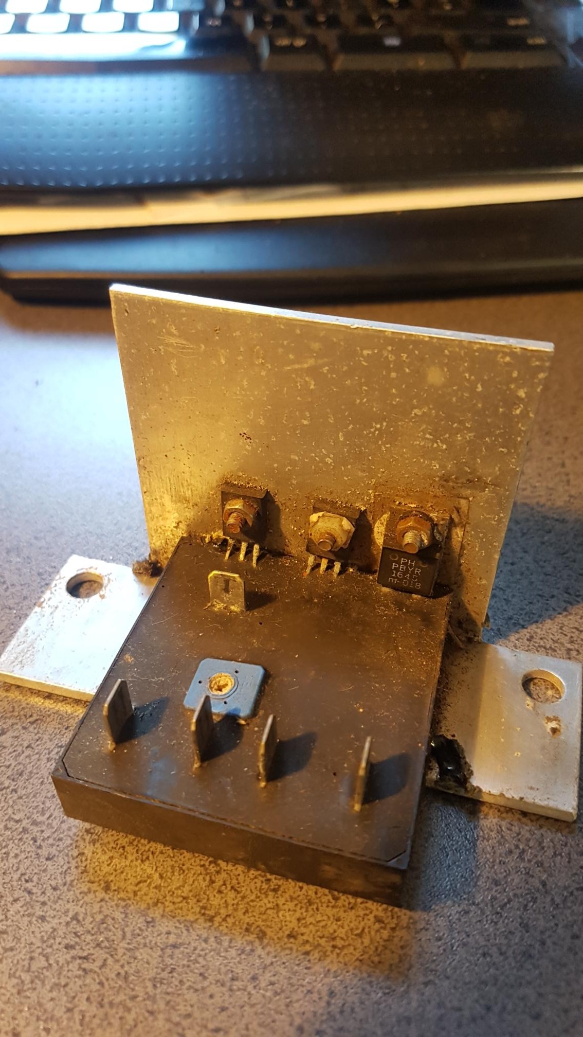

Postby sidewaysid123 » Mon Oct 25, 2021 10:41 am
OK, so this is what the electronic ignition is made up of, the one with the aluminium heat sink I presume is the voltage regulator which replaces the old-style box and lid one, the square thing has a red light that comes on when the pick up is covered at the crank end , The regulator smells of that horrible burnt out electrical, I see those VAPE systems are about 300 quid, could I return to points? I would need a backplate, a regulator and whatever, this cheerful cheap bike is getting expensive.

Postby Andy_C » Mon Oct 25, 2021 12:01 pm
Looks like it has been converted to electronic ignition - lots more to go wrong.
If it has had that conversion it may also have been converted to 12 volts.
As has already been said the orignal points / coil setup works fine, and would be eay to convert back once you have the bits and pieces needed, these are not too expensive either.

Postby Blurredman » Tue Oct 26, 2021 3:35 am
I've seen that electronic ignition before.. I can't recall who made it.. It is aftermarket..

Postby sidewaysid123 » Wed Oct 27, 2021 11:49 am
I Have not had much time to work on the bike due to having to go to Brecon with work, however, I have discovered the thing that was smelling of burn was the regulator ( I have ordered a suitable one) I also discovered that there was no continuity in the HT lead, I took the lead out of the red NGK cap and what looks like a fuse fell out, I presume a suppressor? the lead on it's own was OK, but it is in the bin anyhow, so I hope with a new HT cap and lead, and the regulator changed we may be in with a shout. One other thing is that when I tried the indicators they flashed too quickly, that is usually a bulb blown or the flasher relay, all the bulbs are OK, where can I obtain one of those aluminium 6v units? Thanks for all your help guys, and bye the way I have coming, points set up to convert back if needs be.
