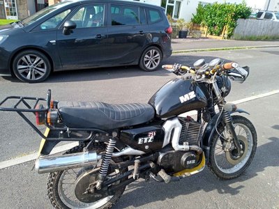

Postby breakwellmz » Sun Oct 10, 2021 7:35 am
Not mine , saw it for sale on FB marketplace -

Postby DAVID THOMPSON » Sun Oct 10, 2021 9:56 am
maybe he had to cross a small stream getting to his house
have 3 places i go with low water bridges what a pain that can be waiting for the water to go down..

Postby Andy_C » Tue Oct 12, 2021 2:49 pm
That certainly is an odd exhaust - looks like it has the end section of a standard exhaust grafted onto the end.
Wonder what effect it had on the performance?

Postby Blurredman » Tue Oct 12, 2021 2:53 pm
Buy it and see... :lol:

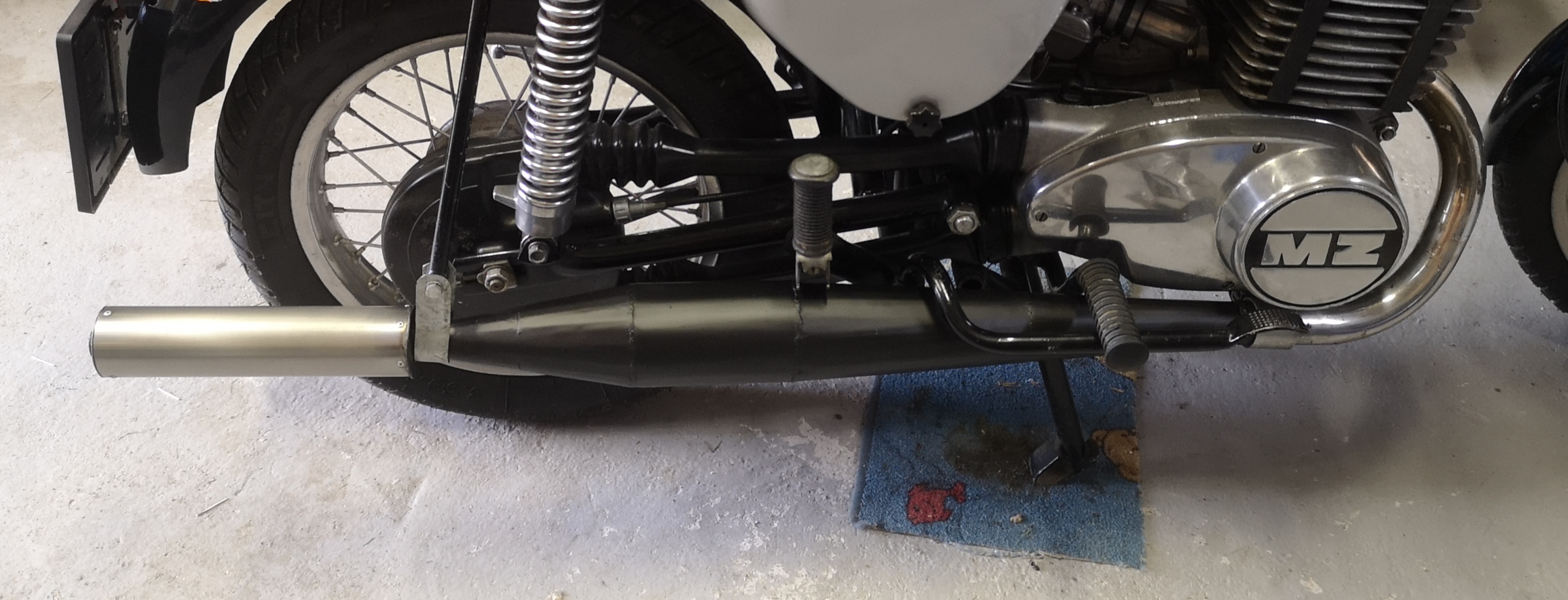

Postby Kruh » Thu Oct 14, 2021 1:39 am
Anyway, on my ETZ251 I tried performance with a long expansion pipe, aimed at lower revs, and I did not get any significant benefit. Race pipes are shorter & tuned to higher revs.
Interesting. Perhaps it was too long?
I also tried an expansion chamber, on my TS. I kept the same difuser angle, but made a slightly larger belly diameter. The main difference between this and the original, is the use of a baffle cone, instead of a flat plate.
I kept the tuned lenght of the original (just a tiny bit longer).
Like yours, no major difference in lower revs. However, the high revs is where it shines. It really livens the bike up, in the powerband from 4500 to about 6000 rpm.
Also, an added benefit is the sound. Sounds like a vintage dirtbike.
The first test pipe in picture below.
