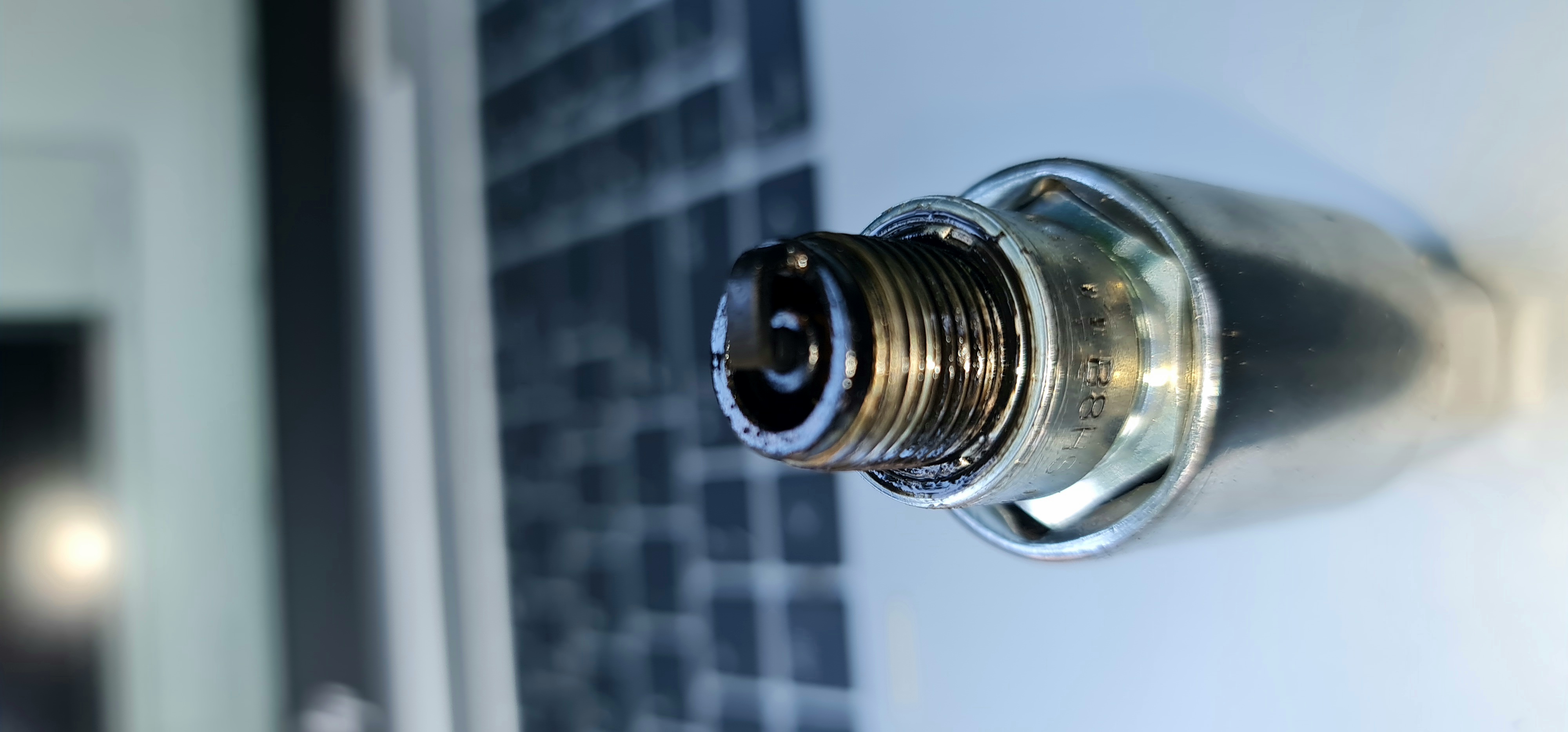

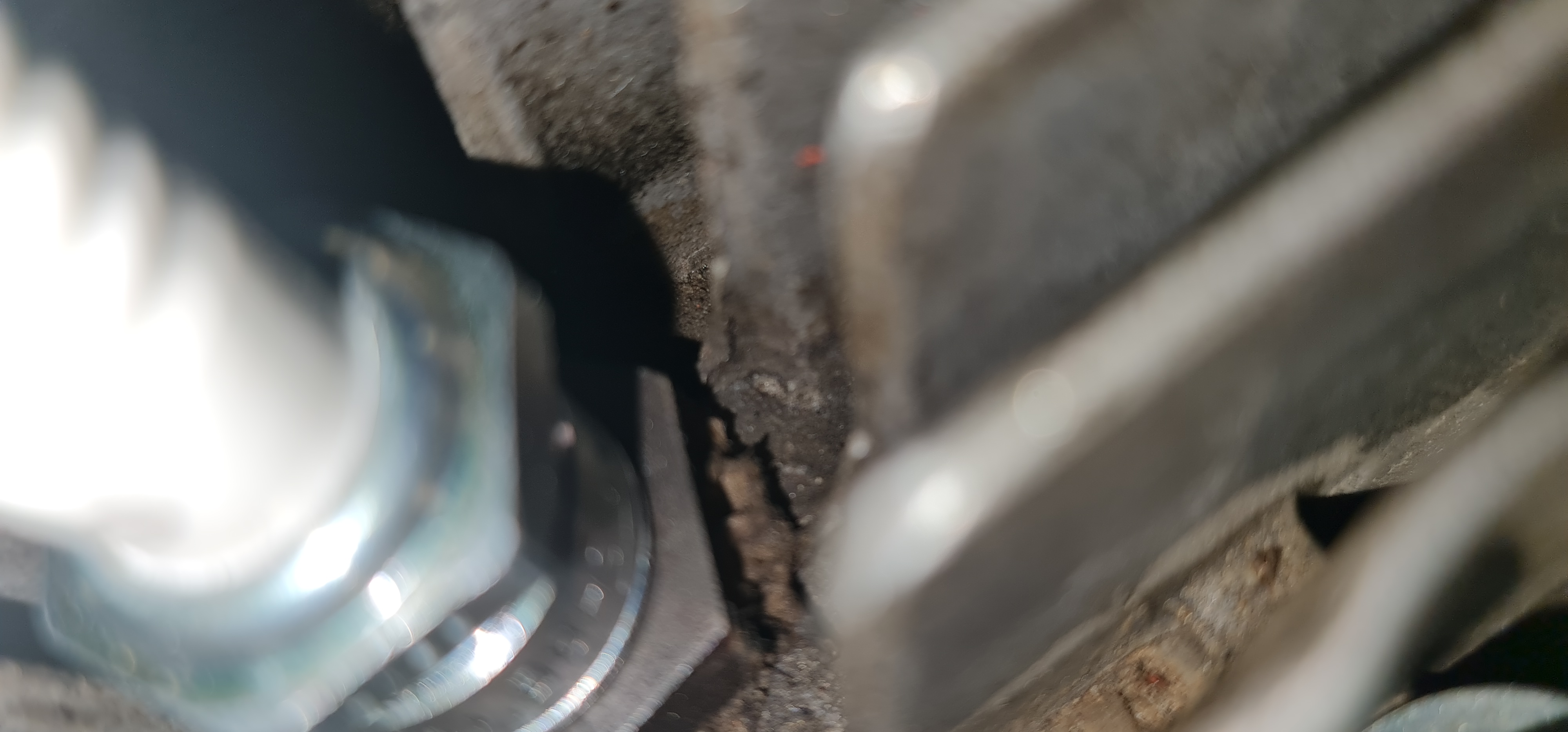

One of the questions I have now is about spark plug.
Initially , 15 years ago someone put a long sleeve spark plug inside which did not fir to the factory specs. It also looks very burnt.
Look at the pic:

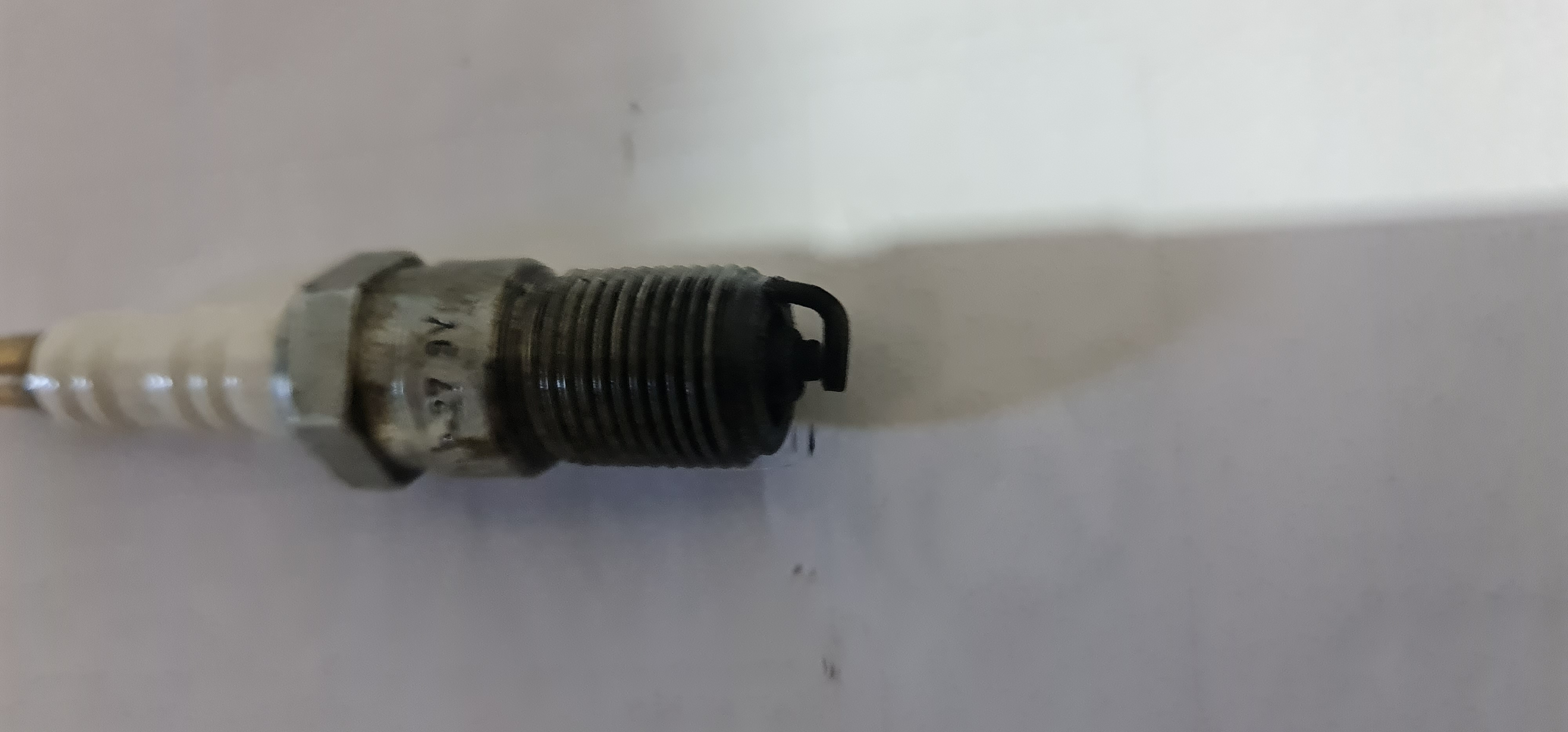

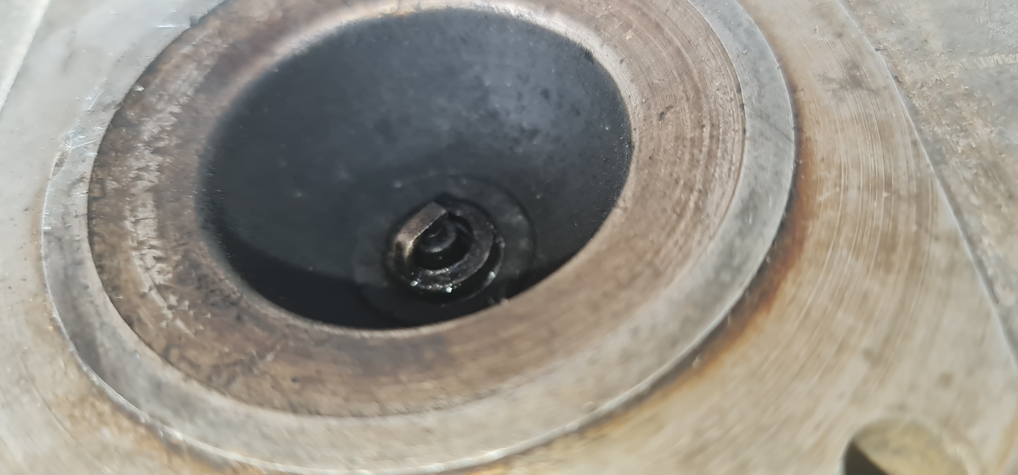

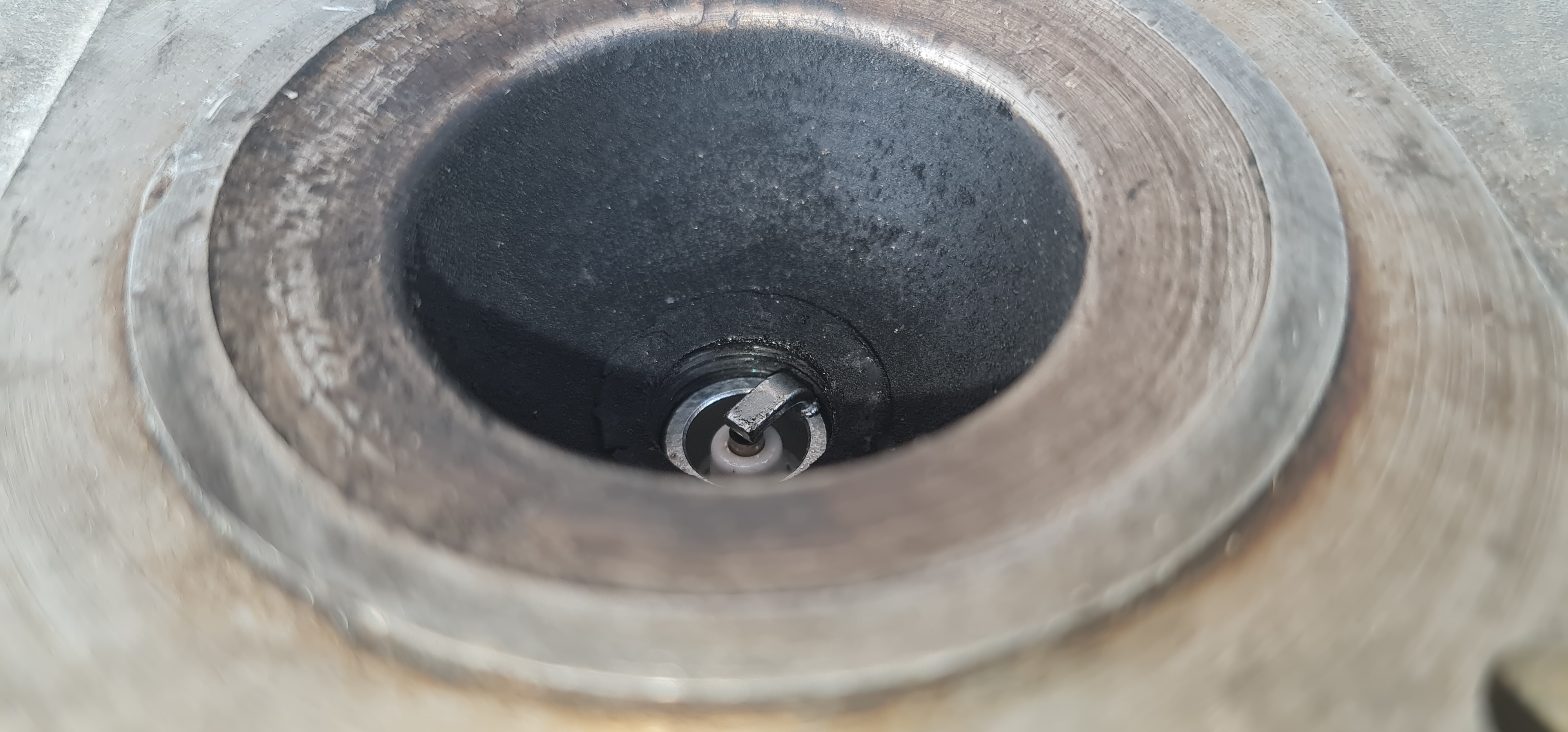

One of the mates here observed that the plug is too long so I took head off and here is how it stays in the combustion chamber:
This is how the recommended ngk b8hs stays:
and this is what I found that a plug should stay:
https://www.cyclepedia.com/manuals/onli ... 235413.jpg
So neither plugs stay in the correct location???? I have 2 heads, in both of them the plug reach is the same.
Beru ZM14-260 isolator spetzial has a reach of 12,5 mm and ngk B8hs has a reach of 12,7 mm.
Anyone with any experience on this subject?
Can someoane measure a head and tell me the lenght of the thread, maibe both of mine have been altered. No mine have 15mm thread lenght.

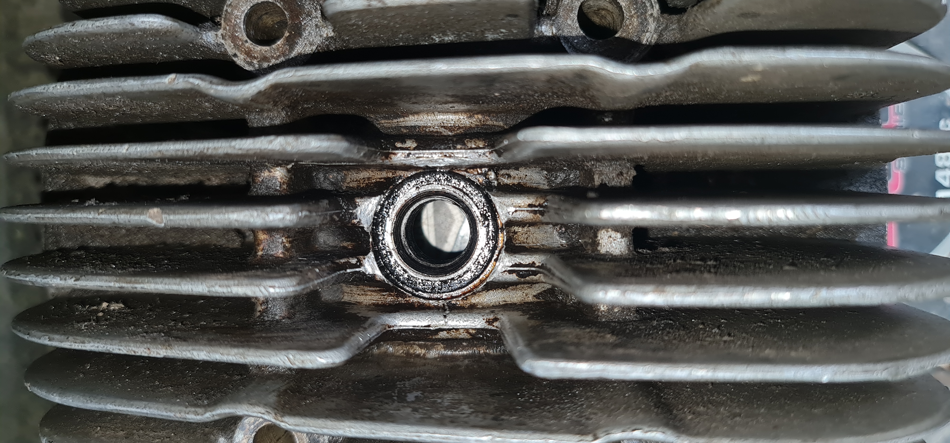

Can you post a photo of the cylinder head from the outside, without a spark plug fitted? I wonder if the thread has been repaired with an insert at some point in the past?

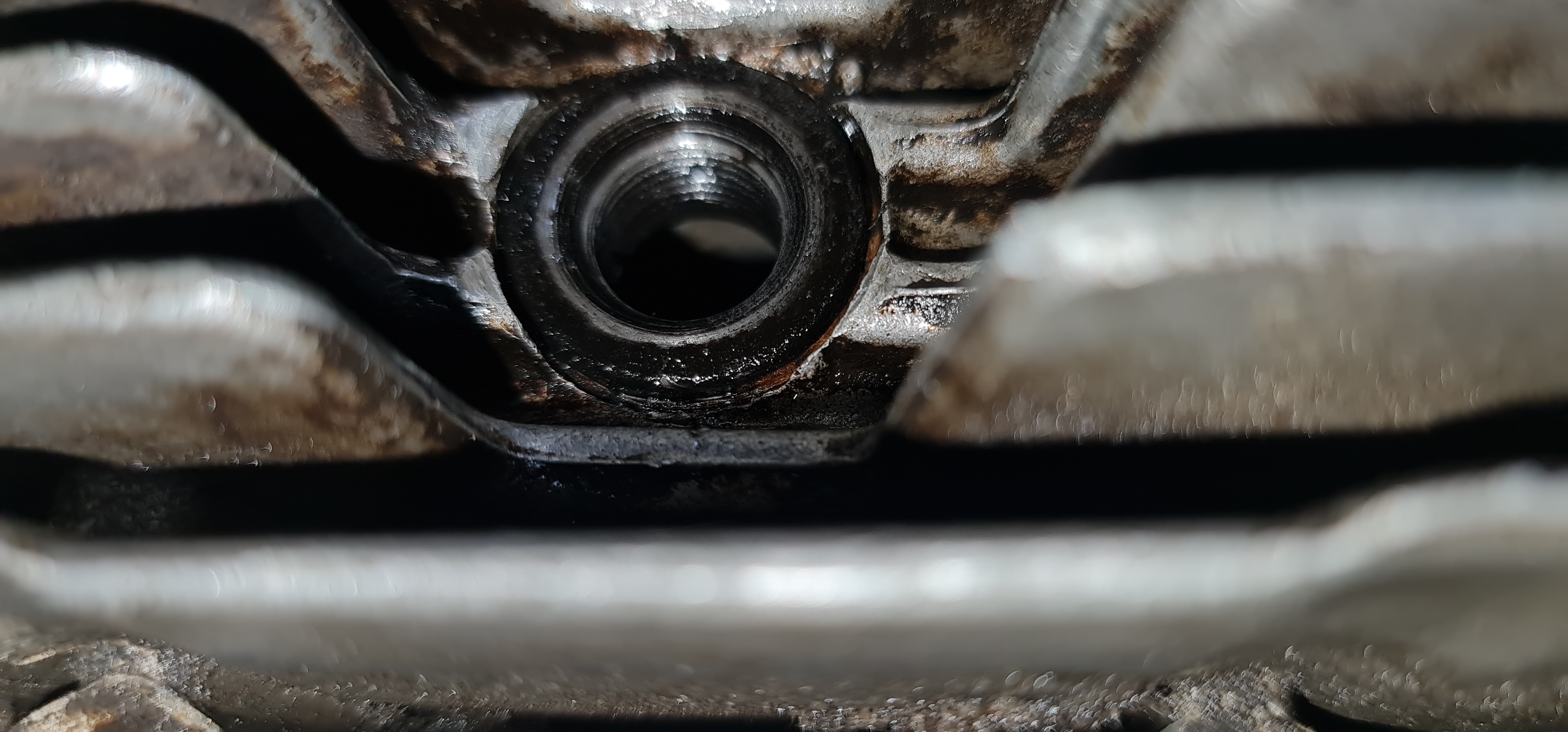

Postby grimstone » Fri Sep 17, 2021 10:10 am
so the ngk and the long plug stays the same in both. here is a pic on the es250/1 head:
and from the es175/1:
They both seem sleeved/repaired but I cannot imagime how someoane would repair and not be consistent with the original lenght.

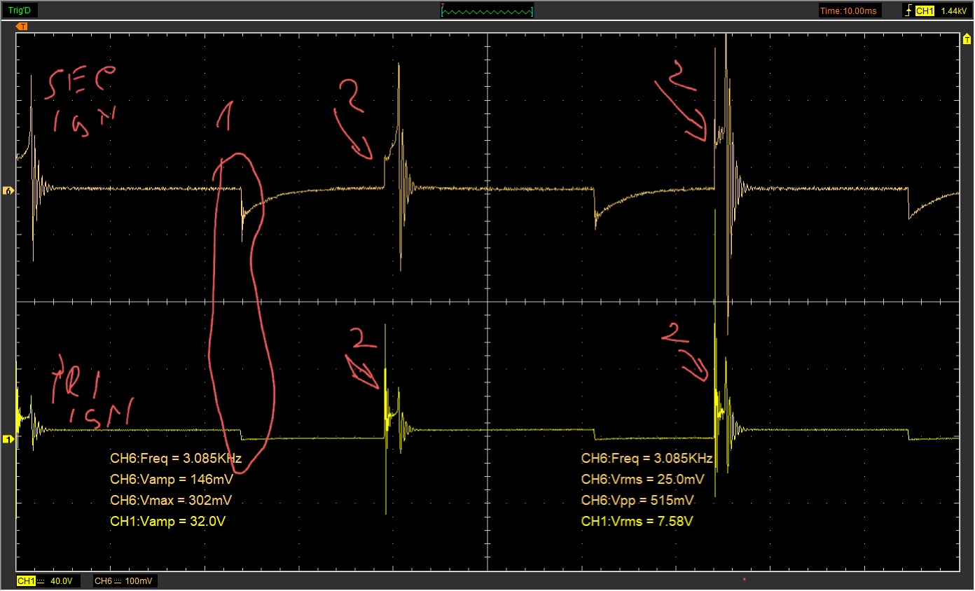

Postby grimstone » Sat Sep 18, 2021 11:47 am

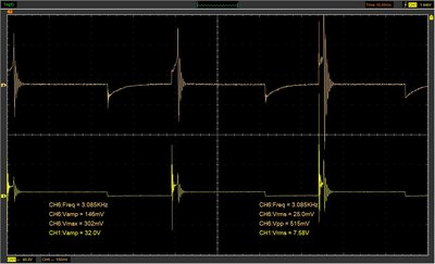

Hello,
Here is the data from the primary and secondary ignition with b8hs.
The burn is definitively very rich:
Below the data. first line from bottom is the primary ignition, meaning how the coil performs and the second line is the actual burn inside the cylinder. Will have to analyze and see but besides being rich ...
Ignore the measurements, they are compensated by some atenuators.

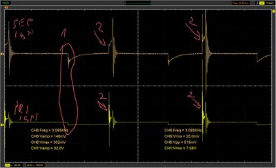

Postby grimstone » Sun Sep 19, 2021 2:15 am
Holo first issues I detect on my burn quality. See below:
numbers from the pic commented
1. (circled in the pic) pri looks good, this is the moment when the circuit is switched on ( ign coil is connected). but the secondary should be the same following a almost 0 volt until discharge and it does not, this means a poor connection to ground somewhere.
2. this is serious. the line from sec that corespond to the pri on the second spark event is good but on the first it does not even exist meaning that there was not sufficient energy from the coil to start the spark. This is maibe of the bad ground.
So on the tools now to solve and find the bad ground. Bike is acting weid like when I switch on the headlight the engine stops and this is with no light bulb connected....

I have no washer there so i assume that the repair was not done correctly and the bush is higher that needed. I will have to repair that.

Postby grimstone » Tue Sep 21, 2021 12:55 pm
Thx.
What I am looking for in the secondary ignition waveform on my bike is the dwell time and form and the variations between 2-3 sparks of the firing voltage line. If you see in most "perfect" curves that dwell line increaseas slowly and after that comes the discharge. On mine it increases very steeply and from what I read this can be of a tired capacitor, points gap beeing too big, a imperfect ground contact or even a tired ign coil. I will have to test each of them, most eSi now beeing the points gap. As for the spark line sometimes is inexistant and sometimes is very high and sometimes very low. This tells me that the ign coil does not charge the same every time and is not able to deliver same spark voltage. This might be case of too large points gap, tired capacitor, tired ign coil or improper ground.. So I need to review these and see if I get better results with a smoother running engine. In fact that is all I whant: proper and smooth running engine to prevent premature wear of components. And of course I might have a passion for these things :))))) You should see how the secondary waveform looks on my 2001 f650gs bmw which is fuel injected. Perfect until the spak line, after that dissaster. The MZ looks way better :))
Today I repaired some connections at alternator side and the engine is not stopping anymore when I switch lights on :) and I started to see 7,8 volts at battety terminals when adding some throttle, previously no more than 6,4. Keep in mind yhat I am running with electronic charging comtroller ( still have the old mech one as museum part or until I learn how to adjust properly).
