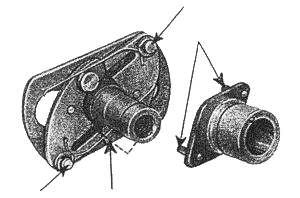

Thanks Puffs- it's not too bad, but I have foudd a few issues along the way. For a start, it looks like the bracket that holds the top part of the left hand side cover on has been ground off! I've asked fellow MZ club members and it does appear to have been removed.. Not sure why.
The mount is supposed to look as such (right click and 'view as' if too large for your computer monitor, as linked from elsewhere):

Bracket - bummer. You'd have to make something then. Is that LH cover also the air box, as in later models?

Yes, i'll have to find the dimentions of the bracket that should be there and fabricate and weld something up.. Annoying, but oh well. Even if I did get it together and running, it wouldn't necessarily be on the road immedately. But, at least with a battery strap, everything would be secure. The rubber battery strap that came on the bike fell apart in my hands obviously.. :-D Though I am very good at zip tie fixings.. :-D Yes the airbox is on the RHS, and the electrics behind the LHS cover. Quite the reverse from later (TS250) models.

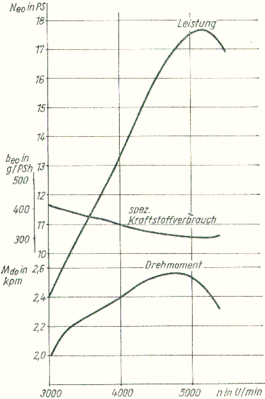

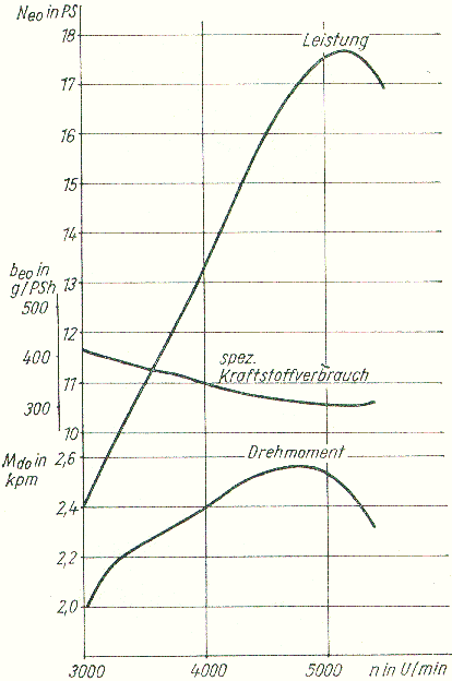

EDIT: when looking in the documentation, I saw that this engine actually lubricates the main bearings with gear oil, so that reduces the risk of those having corrosion issues. Of course there are still the conrod bearings (both needle bearings) that were open to humidity.

On electronic ignitions, IMO their biggest advantage is more accurate ignition timing. With points, the timing can wander a bit, due to vibrations, particularly at high revs. Now the ES 250/2 is not quite high revving:
But still, wandering ignition timing is mentioned as a possible disadvantage of that mechanical advancer, particularly if it has too much clearance (which it shouldn't have in your case, with 12k mi). Check it can move freely, so that it advances properly.
