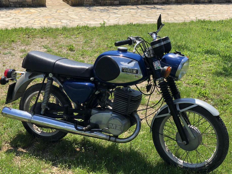

Postby Kruh » Mon Mar 08, 2021 12:09 pm
As far as handlebars go, the TS had 2 versions: the flat style and a higher one (like in the picture). The higher one is also wider.
