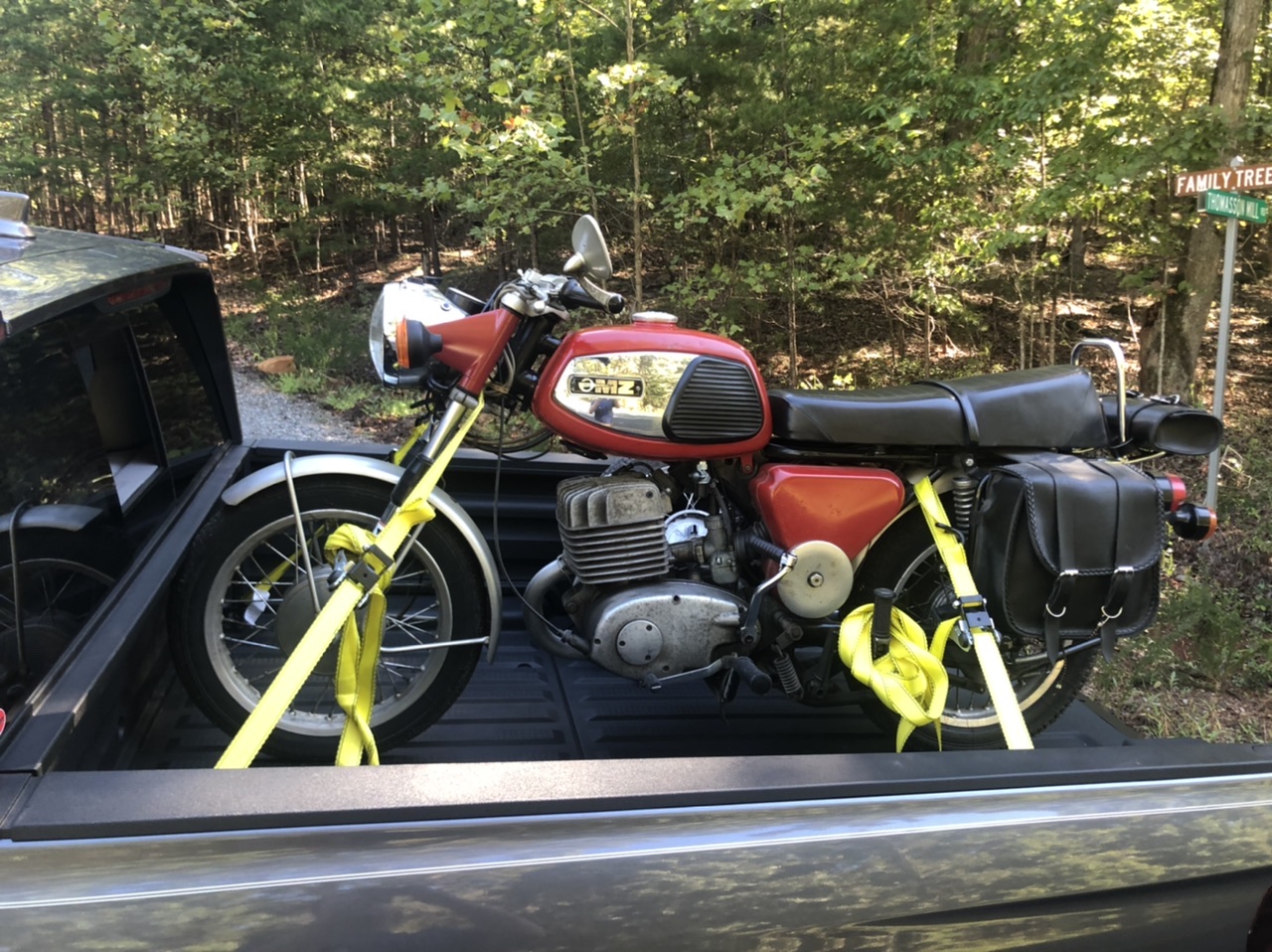

Hi All!
I’m a new member who just picked up a beautiful 1974 TS 250 that I’m planning on cleaning up a bit and then riding as much as I can, as the previous owner did a really nice job sorting it out mechanically.
I have a question about the tank size though, in the manual it says it’s either a 12.5 or 17.5 liter tank. How do I know one do I have?
I have a Puch twingle that uses tcw3 spec 2 stroke oil, can I also use this in the MZ or is simple TC spec better...assuming 50:1 mixture ratio.

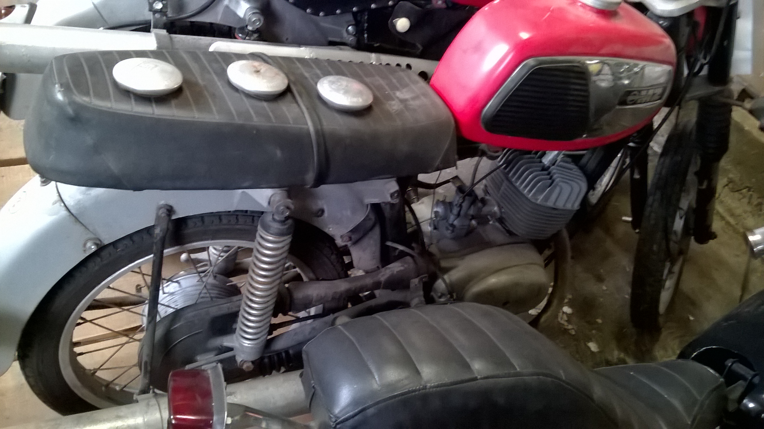

Postby Guesi » Thu Sep 24, 2020 3:15 am
The tank on this picture has 12,5 Liter.

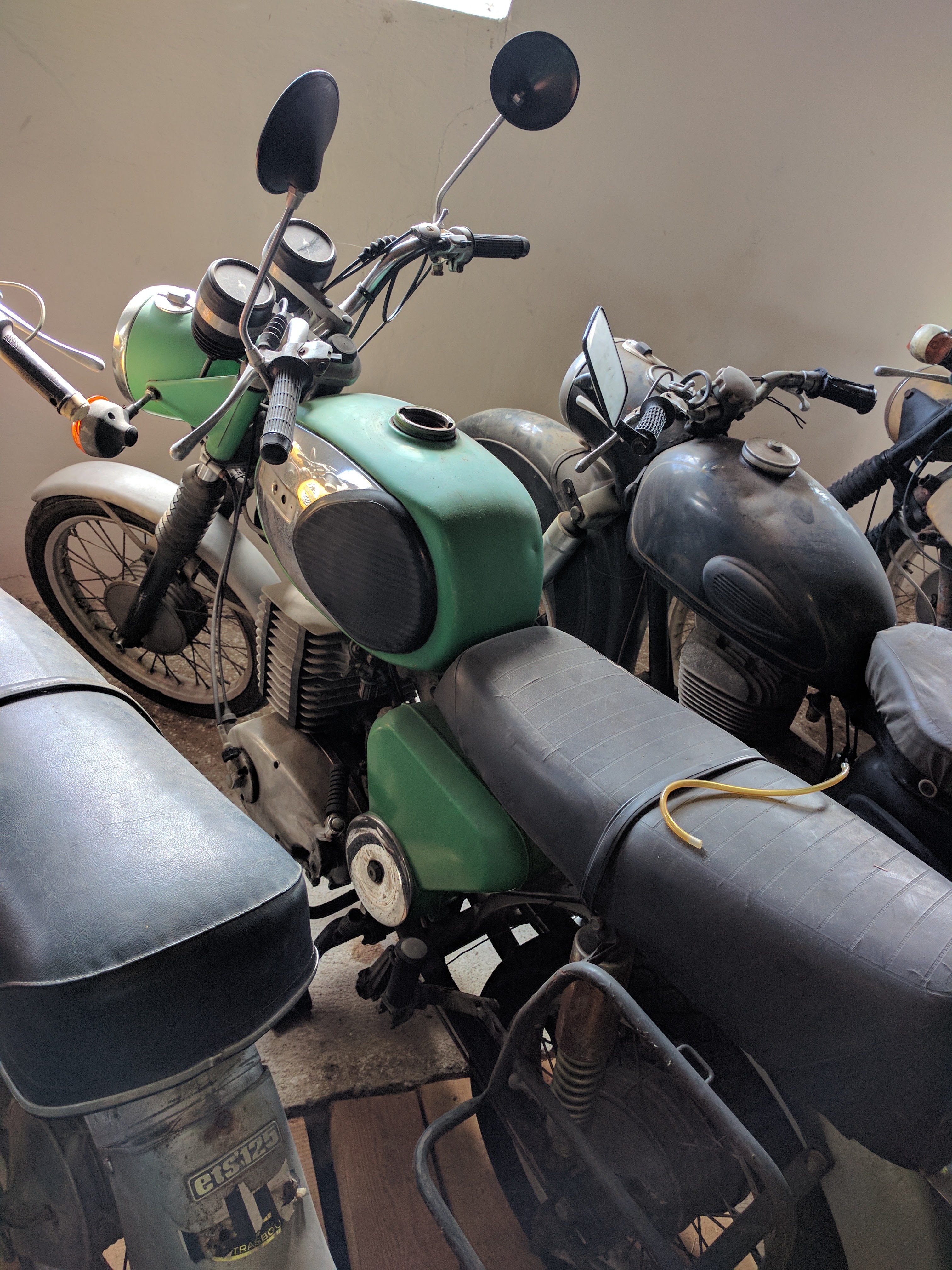

The 17,5 Liter tank looks like this:

Postby R1100purist » Thu Sep 24, 2020 9:14 am
Thanks Guesi! So it looks like I have the 12.5 liter tank on my ts250. Is it a fair assumption that only the ts250/1 “supa 5” came with the 17.5 liter tank?

Postby Guesi » Thu Sep 24, 2020 11:41 pm
No.
The 12,5 Liter tank was on the US Export models.
The "original" TS 250 and TS 250/1 all had 17,5 Liter tanks.
Your 12,5 Liter tank was originally from the TS 150 Model.

Postby Puffs » Fri Sep 25, 2020 4:44 am
Nice bike!
IMO the small tank looks a lot better, but if fuel consumption is anything like in the later ETZ's (which have about 13L for the 125/150 & 17L for the 250/300's) you'd want the big one for the range. Of course range might not be an issue in your case.

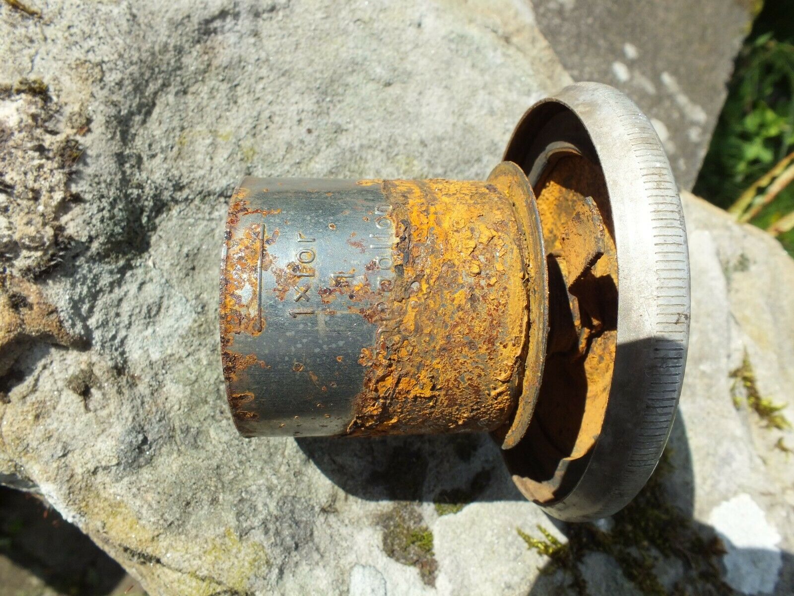

Postby breakwellmz » Sat Oct 03, 2020 8:40 am
R1100purist wrote:Okay I found some TC grade 2T oil (Lucas semi synthetic) and going to run that on 40:1 based on previous owners recommendation. Now I just need to figure out a solution to carrying around/measuring the oil While on the bike.
All my two stroke MZs (I`ve had five of them) had a measuring pot on the underside of the filler cap marked 33:1 or 50:1 depending on engine size, doesn`t yours? Carried a bottle of oil behind a side panel.
Mine certainly all had long and hard lives, be it hard road miles or (in the case of the trail bike versions) Low speed running with cooling fins clogged with mud, all good.
Remember, they are relatively low revving engines NOT racing ones and the more oil you add the leaner you are making the mixture.
Each to their own at the end of the day but i think the manufacturer have more idea than us mere amateurs. :wink:
