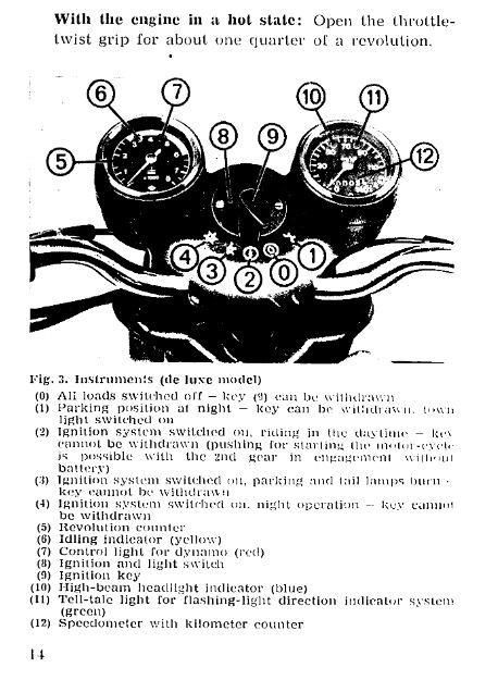

Postby Lpo90 » Thu May 28, 2020 5:28 pm
Have not looked inside the lamp itself yet. So I should get a light at the front as well as the rear of the bike on the sidelight position.
Lpo90
Posts: 40
Joined: Tue Oct 22, 2013 2:12 pm
Re: Key position and lights
Postby Blurredman » Fri May 29, 2020 2:01 am
Hi.
I have found in the owner's handbook:
You can find it in page 14 here:
ftp://blurredmanswebsite.ddns.net/Vehic ... ndbook.pdf
You use position 3 for tail and pilot lamp to be illuminated.
Position 4 for dipped beam. Position 0 is pilot lamps on, but ignition off.. For parking in an unlit road.
Posts: 1266
Postby Lpo90 » Fri May 29, 2020 4:47 am
Cheers, seems my front pilot/sidelight isn’t working then. My previous etz was the same. Thank you.
Lpo90
Posts: 40
Postby Blurredman » Fri May 29, 2020 8:18 am
It could be a broken/lown or missing bulb, but it could also be simply the cradle that the bulb sits in. The cradle sometimes doesn't make a good earth to the bulb, or even from the cradle to the headlamp surround itself.. In the past I have implemented an additional wire from the earth of the main bulb's connection and wedged the other end of the wire between cradle and headlamp to get it to work before.
Posts: 1266
