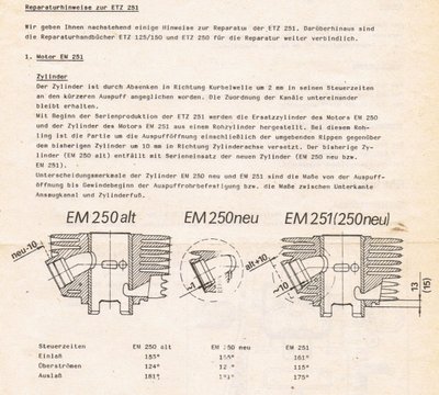

There is also a thread on the different cylinder barrels, but I guess this says it all:
Unterschied ETZ 250-251 Zylinder.jpg (36.96 KiB) Viewed 279 times
The heads are probably the same, but you do need to measure the squish size = clearance with the piston crest. Again, maybe search. Are you sure you mean head, or cylinder = barrel?

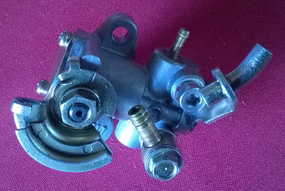

This is what it looks like for the internal pump on my ETZ.
I found this in a Dutch publication, the engine with the internal pump indeed seems to be the older one.
Looking at the drawings it looks like there's two different pumps but when searching online indeed one can only find one type of Mikuni pump.

Ta for your pic & that publication. The pump in your pic looks identical to mine, except for the connection of the exit line. The publication confirms my suspicion; a 6mm line on yours connecting to the internal galley, and a 3mm one on mine:
MZ oilpump (external injection line).jpg (41.44 KiB) Viewed 279 times
connecting to the external line. With some effort you might be able to convert between the 2 methonds, maybe you can take out that connecting mandrel & replace it by something else. But: I took mine out, see viewtopic.php?f=5&t=9988&p=50155&sid=60e89cb83eabf350cf59ee0913d40a09#p50385.
