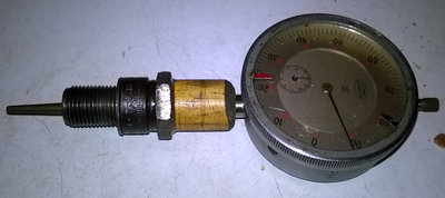

For fixing the gauge in the head, I set it in an old spark plug from which the ceramic internals were removed & replaced by some wood. Before I inherited that dial gauge, I just used a calliper.

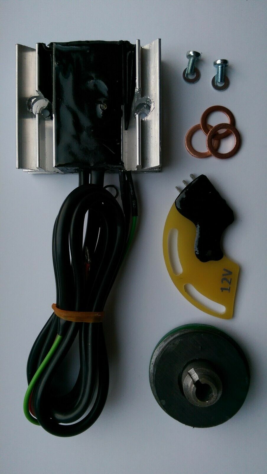

all fitted very very easy to fit and runs great.
only £60 from ebay

eBay item number:
233478873087
for the ignition £65
and got the dial gauge from burwins £16
very easy instructions fitted the wire through the loom hole on the engine so tidy and will not
be cut by the chain.
disconnect green wire from points and remove points and condenser.
fit new ignition plate where the points were and connect coloured coded wires.
remove green wire from coil and connect new wires .
get the correct tdc and move the new timing plate and a light comes on the unit when it sparks.
So easy with the dial gauge and it started 2nd kick as usual.
while my points were still like new decided to fit the new ignition to save working on the bike

Anyway, for completeness my dial gauge fixation:
Dial gauge in modified plug.jpg (18.85 KiB) Viewed 19620 times

That is the same electronic ignition I have. I believe it's polish made - ‘Zaplon elektroniczny’
The guy in the UK just sells them on.
However.. Yes, it is very good I think. I bought one to replace the fact that the points on my 251 simply could not be set. There may have been crankshaft bend or something strange happening there - either way it doesn't matter as the engine has now been rebuilt- BUT.. I did not re-implement the points, I kept the electronic ignition.
This is a bike that I travelled for 10k miles with this electronic ignition, and to my memory have had no issues what so ever related to the item. Just remember to use appropriate spacing so that the magnet/rotor is the ideal distance from the sensor! The little LED to indicate sensoring of the magnet to time it is also extremely handy!
