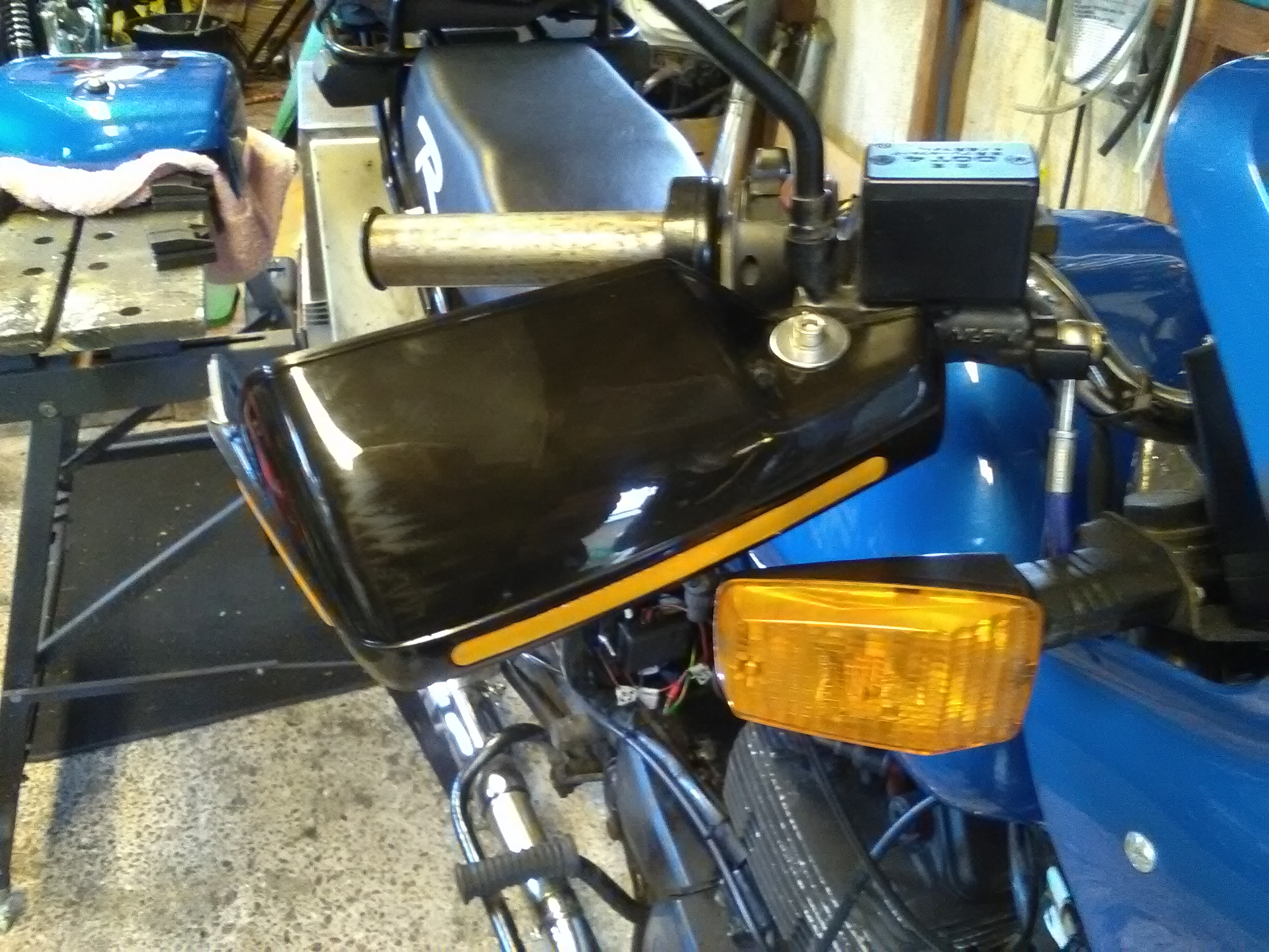

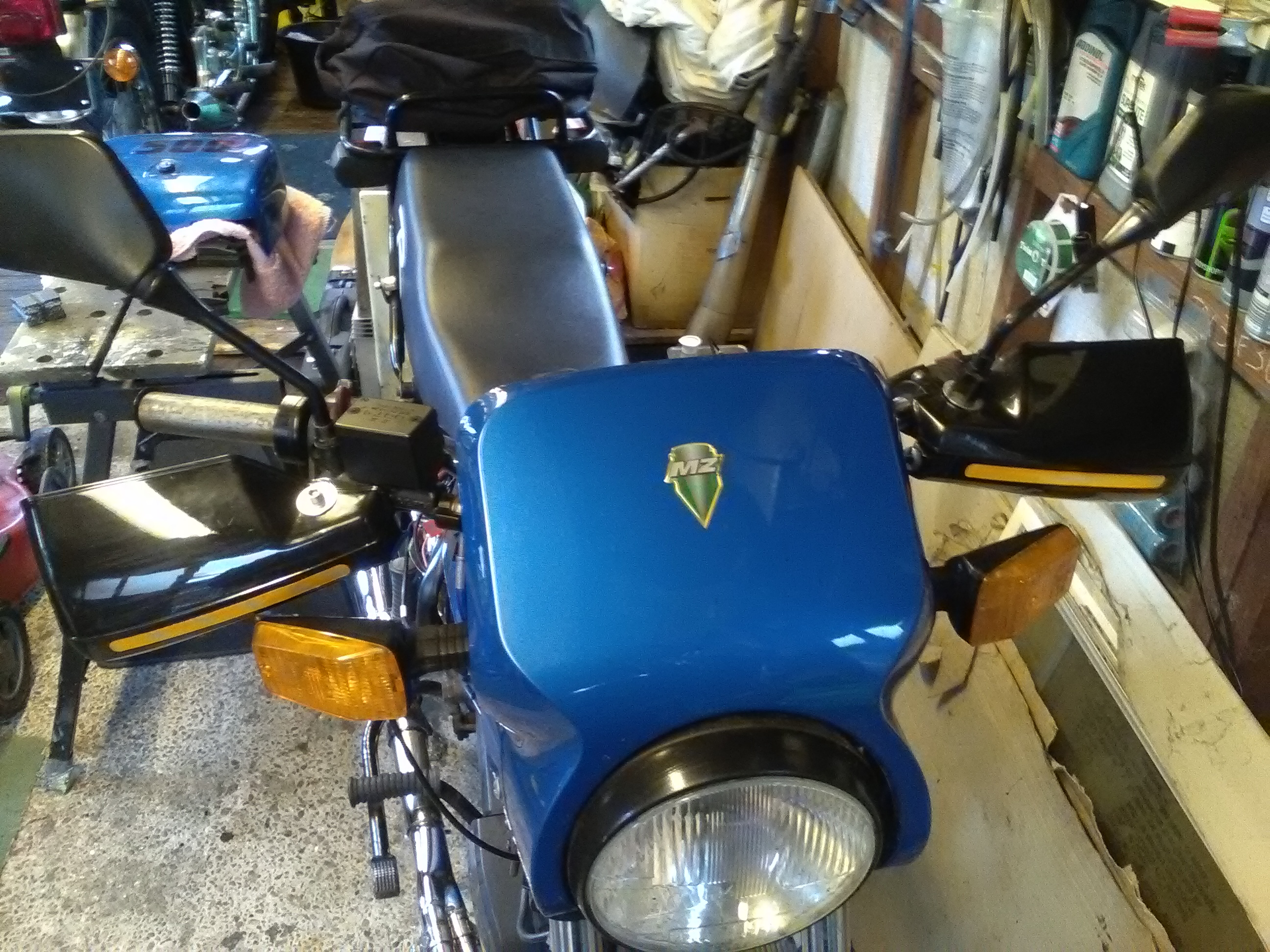

Just "adapted" some universal handguards from my "they'll come in" stores which I put aside when I found "universal fit" meant "fits nothing". Junior hacksaw, drill and cable tie later they're on and will hopefully help deflect cold air off my hands. Meanwhile I will keep looking for a solution to my heated grip issue.
