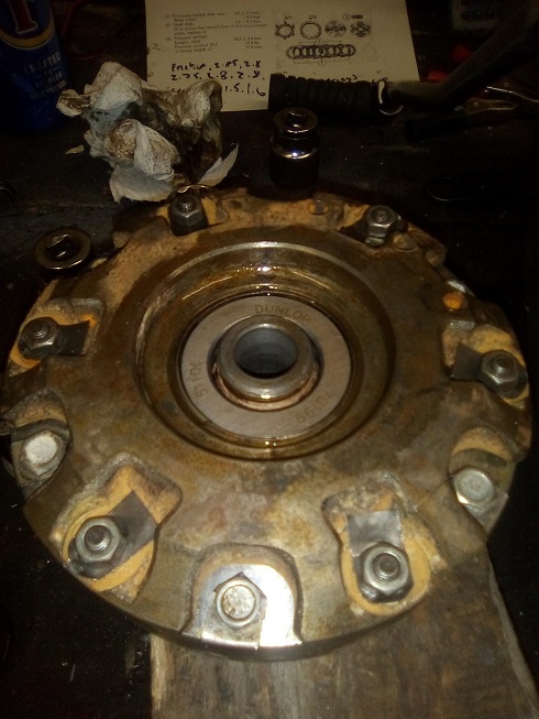

Well last night I had it all back together. But before I get to that. The picture of the new bolt in it's place (as you can see I have filed away some of the protruding surface). Yes I did install two copper washers to counter the fact the thread of
the bolt didn't go all the way to the head, but I didn't really want to drill a recess in the tapped hole.. I did indeed put some RTV on the thread too.

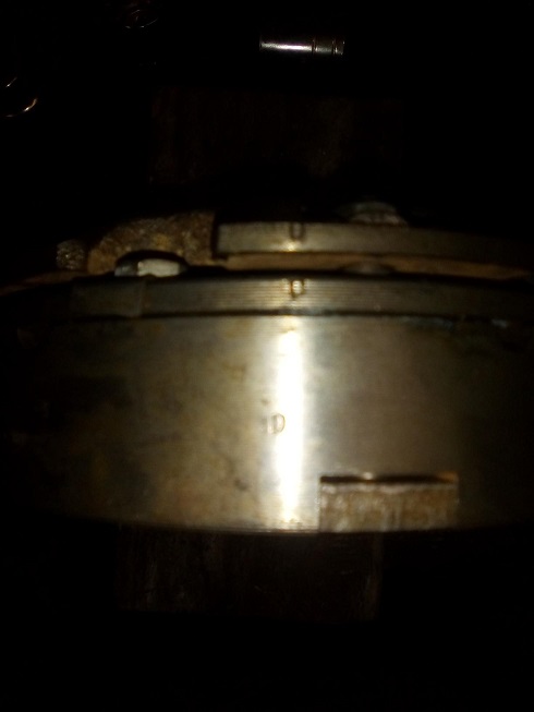

The clutch is back together. Notice this- something that isn't mentioned (at least to my knowledge) about the ETZ models. Presumably balancing was able to be done alot more accurately later on, but the 'D' in this case (the manual states 'X', but I guess it could be anything the builder had), need to be aligned like so. (page 35 of the official service manual). The slave to the pressure plate doesn't have such a marking however so that can be wherever it seems.
I did take measurement of the plates and springs before assembly (the longer springs being most opposit eachother as possible).
The spring measurements according to the book are supposed to be 28.3 - or + 0.6mm. Mine were: 26.6, 27, 26.8, 26.6, 26.8 and 26.6. A bit compressed over time but I find that all the springs I have dealt with on these clutch are. Will have to just keep an eye on the clutch engagement and feel for slip at speed etc. I already have a somewhat ongoing problem with my 251 regarding clutch slip because of shorter(!) aftermarket springs. My etz250 had slip too, but I decided to replace with original 2nd hand springs (pre-used) and that has no slip despite them being short too.
Anyway: Friction plate is supposed to be 3.0 - or + 0.1mm when new, and a wear value of - 0.3mm. Mine are as follows: 2.85, 2.8, 2.75, 2.8, 2.8.
Steel plates (have lovely cross hatching on them still!) are 1.5mm - or + 0.1mm, and mine were 1.6, 1.5, 1.6, 1.45.
So at least I have those documented. The condition of them were very good, with just minor scoring on one or two of the friction plates. But, we will have to just see how the bike goes as it is and we'll cross that bridge later if any of these components are an issue. The fact of the matter is this bike is not going to see the 24/7 use say my etz251 gets. Therefore, these components all together could last me another 10 years. In the spirit of keeping the renovation cheap enough to make the bike usable, but not a restoration (at this point), this is fine by me.
And... I lubbed the thrust bearing and installed it too.
Installed the clutch (lubbed the pinion bearing again), and installed the clutch cover back on after a thorough cleaning of metal debree. Immediately I tightened it up just enough to feel what that clutch would be like- and it was the same as before! Extremely difficult to pull in..! However I did notice that the outter sheeth of the new clutch cable had become compressed slightly at the point where it enters the clutch cover. I put the original cable that the bike had, back on the bike and it was completely different. Sure it's a heavier clutch than the later bikes, but it was now smooth, groan free, and as light as it should be (I imagine). Interesting.

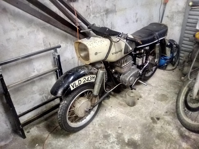

And here we have the bike assembled (container for catching over fill from topping up transmission). I used new copper rings for all bolts that required them. I haven't however put a cotter pin on the end of the crank bolt. Though that's easy enough to do that at a later date.
The bike started readily enough and I let it run for a while to try and tune it a little but it's still a little unreliable on the idle front. It might be the case that is similar to my 251. Idle speed in neutral after first starting is around 1700. With clutch in, 1300. But if been riding, then slowing down it can idle for a while at the 15/1600 mark and then gradually (but reliably) sink back down to the set ideal speed of 1300. Without a tacho it's a little difficult to determine what this ES250 is doing. And my RPM calculating strobe light is broken so....
Alas, Saturday I hope to do an errand or two, so other than perhaps a quick whizz around the local estate tonight maybe, Saturday will be it's 2nd shakedown and maiden voyage. As said- the clutch is working lovely in operation. Smooth and ungrumbly and doesn't rattle.. One thing not evident in the video (and yes, I admit I gave it little thought for already previously mentioned reasons), is that cylinder certainly sounds rattly within that bore! Ahh I suppose that means less liklihood of seizing I suppose.. :roll: :lol:

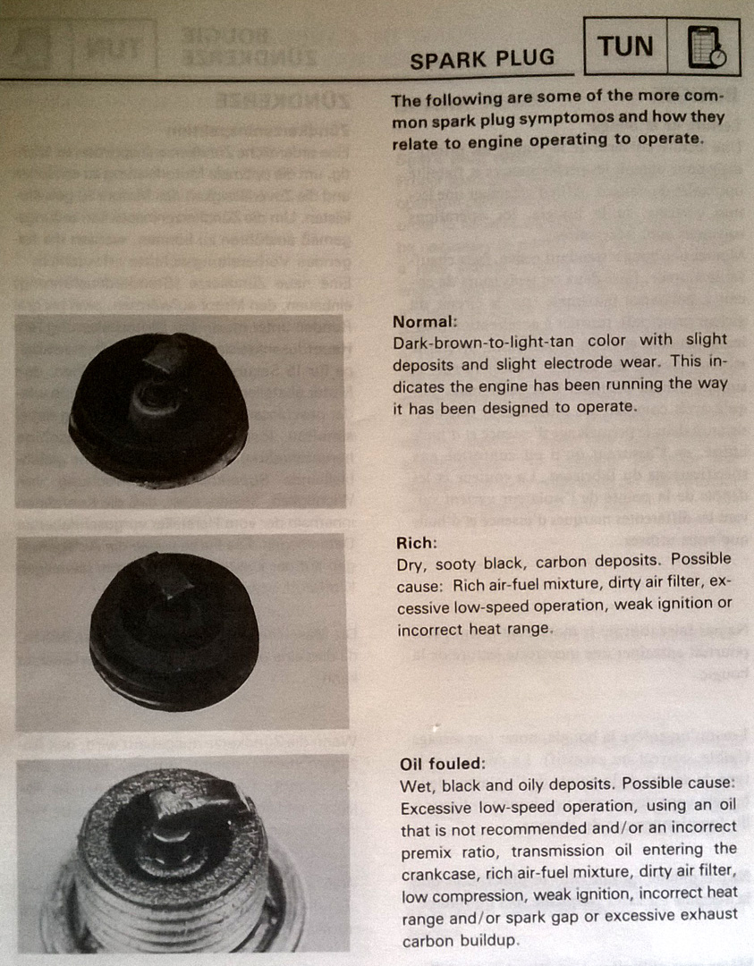

Jetting: yes that seems a bit lean. But if you richened it, by positioning the needle in the highest slot, and it began to misfire in the mid range of the throttle, the needle should probably come down again.

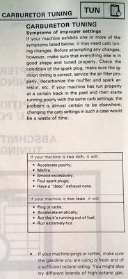

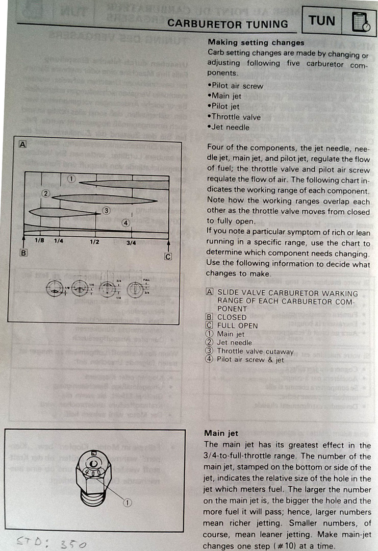

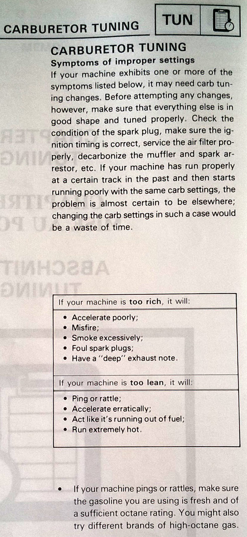

For reference, sections from the YZ250 manual I posted earlier; I find these quite useful. But note: it pertains to a quite different carb (a Mikuni TM38SS), so not everything is completely applicable you your case. And also, the plug pics (originally in black & white) are very dark. Nevertheless, a good indication of where the different jets are active.

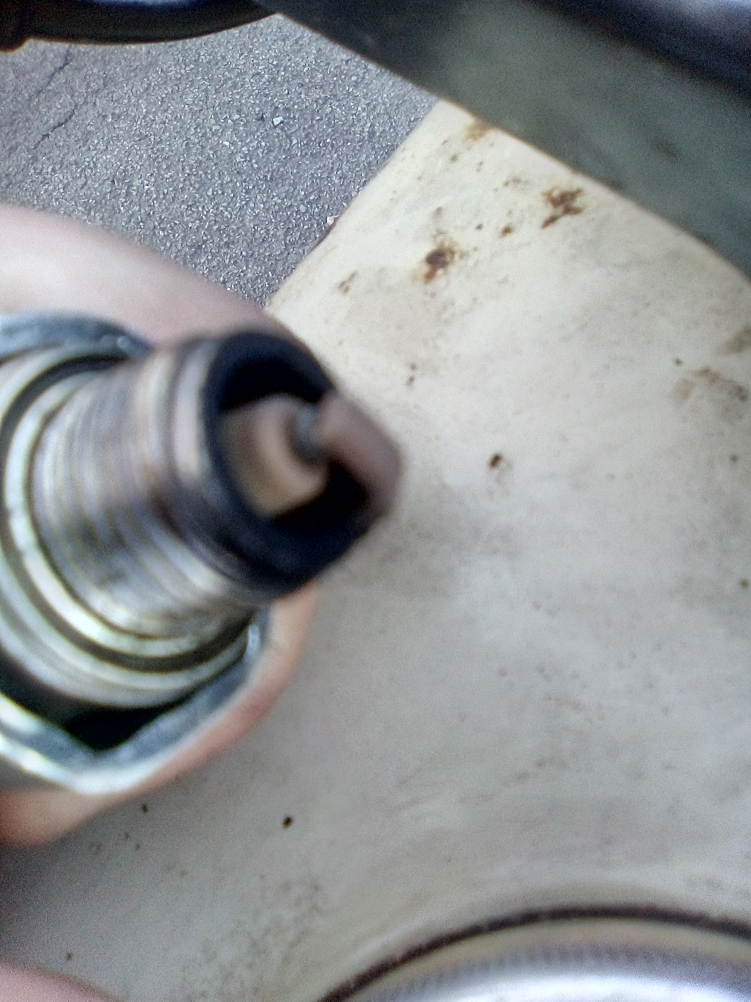

I prefer to start with the main jet, but in your case, with a newly rebuilt engine that was designed for different fuels & oils, that is a bit of a leap. But maybe after 55 miles it would be time for a proper plug chop. And while the modern fuel (E10?) has changed, I would expect not to stray too far from the factory prescription. And also, those holes in the airbox you mention, do they cause the flow to bypass the filter (partly)? The factory jetting specs expect a non-leaking path to a clean & standard air filter and a standard suction tract; any differences may need adaptations to the jetting (and a 2T needs good filtering).
But also it's quite cold now, which means there's more weight of O2 per air volume. Air shrinks when it cools; a leaning effect.

Thanks for the diagrammes, they do help- esspecially the fuel jet overlap/working territory.

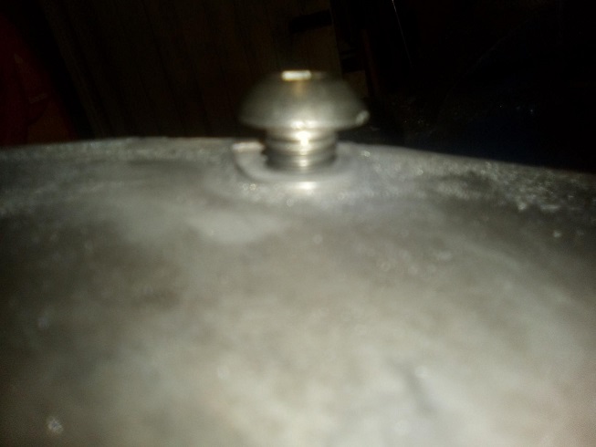

I'll have to take a picture of said holes for you. There are a few (very hard) bung things that were the remaining little bits and pieces that came with the bike that I wasn't sure where would go (although those holes didalways intruige me). Anyway, I think they must be there for moulding maybe as this is bakelite stuff, or perhaps to remove vibration noise (but then why not some at the top?). Bolts 2 and 3 go through springs and keep the other bakelite piece (that the electrics/coil etc mount onto) in place on the frame- the air box and the electrical mounting piece just squeeze around the frame. They don't bolt directly on the frame themselves- not sure why. Vibrations ? oh well.

Pics: if you get to it, but it shouldn't leak air before the filter, I'd guess.
But don't expect too much difference in jetting due to some relatively small holes. Well, for sucking in dust it can make a major difference.
