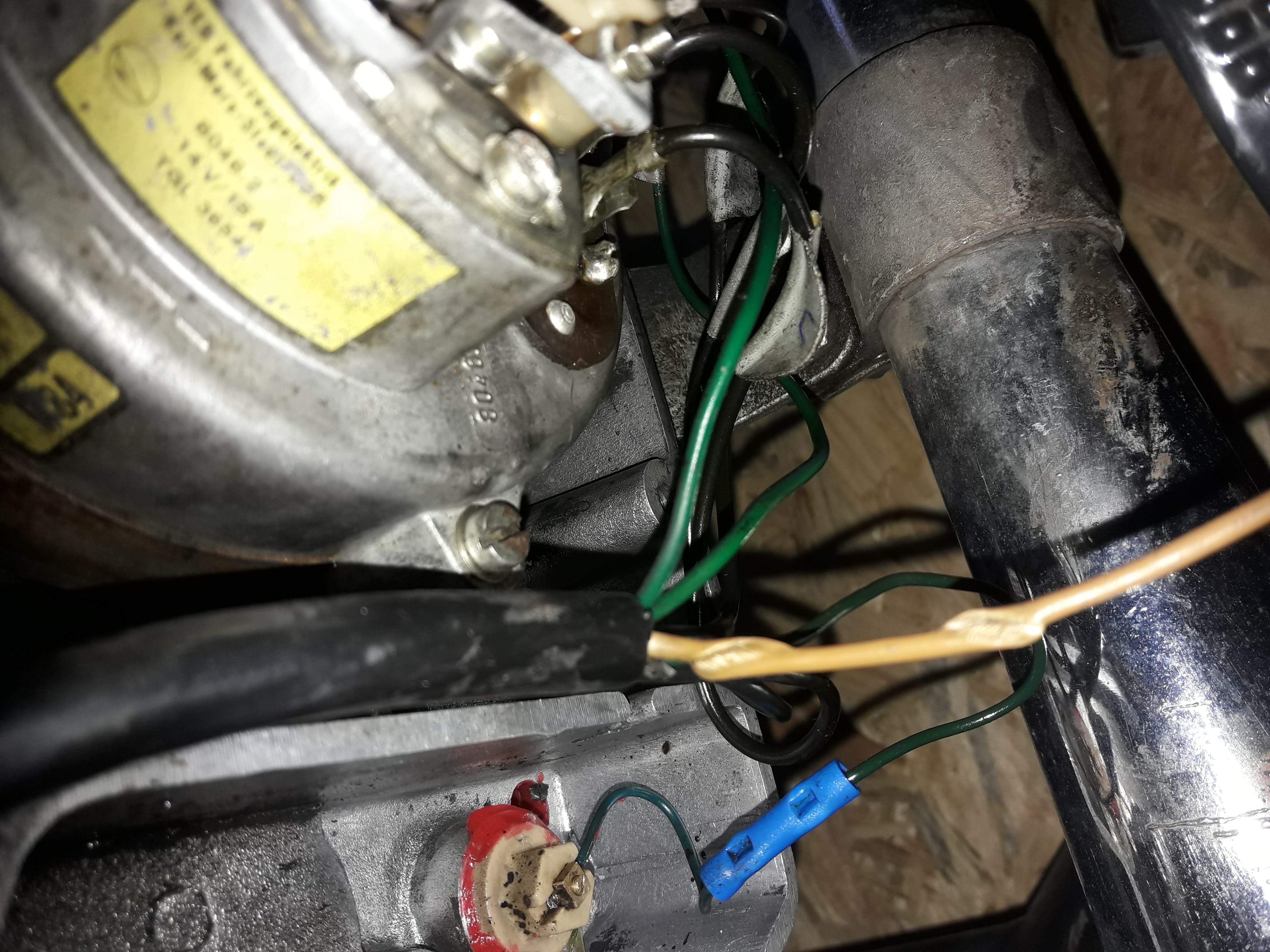

Klemmy: as Puffs has said I would look at the fuse box to make sure the fuses are making a connection. Possible the jolt has dislodged a fuse or made an already poor connection worse.
Can you verify that it charges or not with the voltage meter?
Also check the wires from/to the alternator to the rectifier and also the voltage regulator.

I was at work today all day, so I couldnt do much investigeting about the problem. The thing is, that I drove on the bad road, with many potholes, so the speed was not high. Instantly after hit, indicator light came. I made about 6 km to home, without any other indication or problem.
Later I took off the cover and I found squashed brown wire, which goes on alternators right corner, but I dont know, what exactly is its purpose. This is my mistake, I was not careful enough, when I put the cover on, when I was looking if the Loctite did his work on the leaky plug next to neutral light switch. But that was before I ride the bike and it was about 50 km long ride, with no sign anything could be wrong, whatsoever. I cut the damaged wire part and connected it again with the clamp wire connector, very similar to one, that is on the wire of neutral light switch. I was looking forward and I saw one disconnected wire on the alternators down side, where 3 black wires are. I plugged it in I thought, I found the problem. No, the light is still on.
Every other wires are looking ok, so do fuses.
I have some hobby program multimeter and I will try to do some measurings tommorow.
Thank you very much for your support.

Quick update...I had cleaned some of contacts today and bike is charging and running just fine :shock: No warning light on, during running...Did a quick ride, few km around the block and everything is looking normal. So far, so good.

I've spent a lot of time in the past and still do, cleaning (wirewool or sandpaper) the spades and their respective connections, or reinforcing the connection to the spades with solder. I also find that if they are not too tight then slightly (!) crimp the spade connectors down a bit with pliers and they should be a tight connection when affixing onto the male counterpart.
As for your crushed wire- I wouldn't worry, that brown wire is the earth wire anyway, so being crushed (the the extent that it showed the copper core) wouldn't have done anything as the motor as a hole is obviously earthed too. Unless of course it cut through the copper core, but I doubt it. I've done this a few times in the past too.
But good you found that it now charges nicely ;-) :-D
