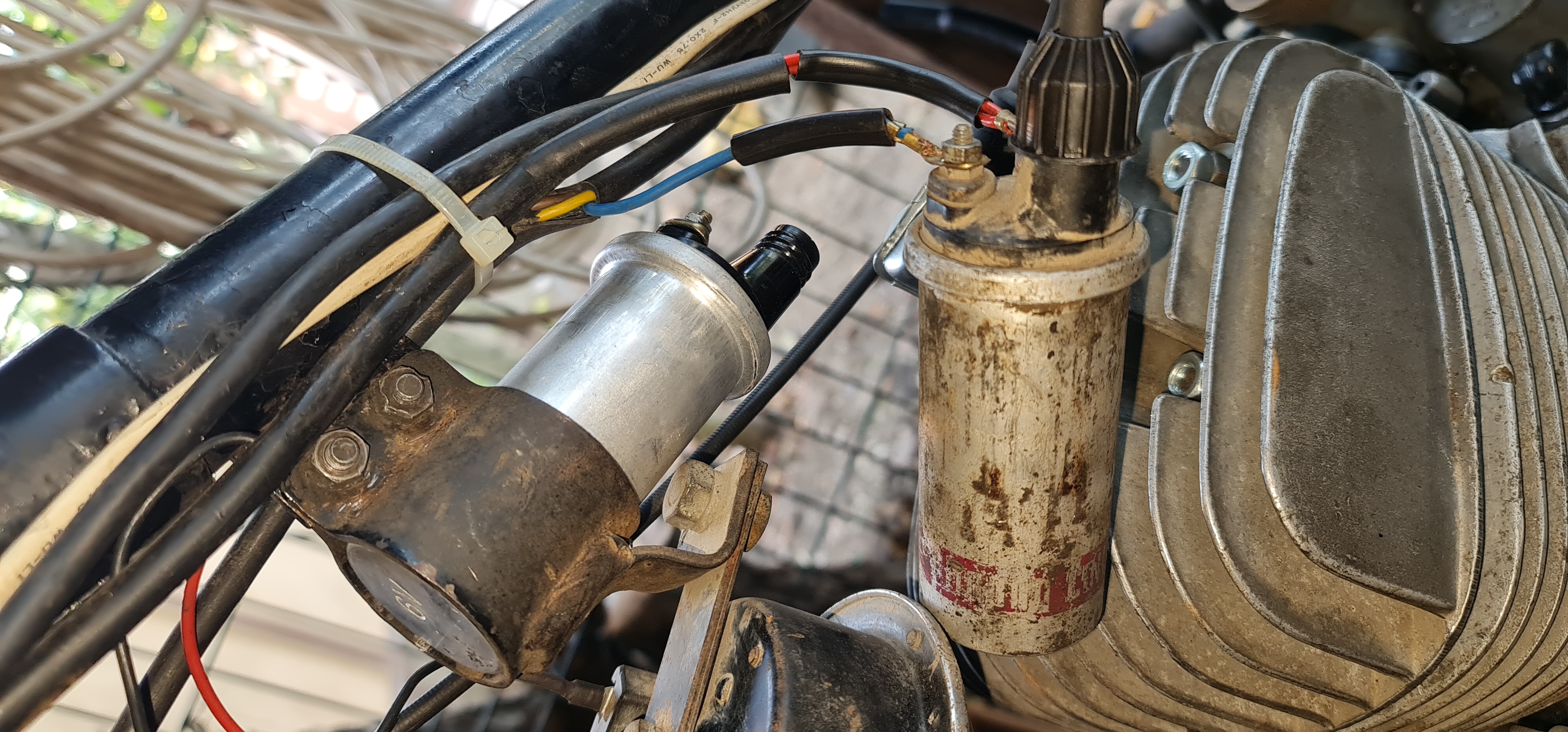

So ,
at idle the voltage is 6.2 and the charge light goes off
when I revv the engine voltage increases but also the charge light starts to glow a little.
PS:
Changed today the condenser and the ignition coil. What a story:
Bike had a huge ignition coil , i suppose from a Trabant car (6v also) so I decided to go with the original small ignition coil (to fit as many orig-like parts as possible) and changed the conmdenser with a brand new one. In this setup with new coil bike just does not start, it seems that the spark is very weak (breaker points gap is 0,3 spark plug beru isolator 14-260 gap is 0,6). Changed back to Trabant coil and kept the new condenser, after unflooding bike starts. Even changed the spark plug cap with a non rezistor one on the new ignition coil and not even a "puff" of smoke.
It starts to drive me crazy.
Another test with the little type ign coil from the ES175 engine which is the same dimension as the new one. Starts right up. I guess I have a ign coil made of chinesium.... damn.

Postby Blurredman » Tue Oct 05, 2021 5:33 am
I once bought a new 'mz' coil that you can get on-line. I sent it back because, although the bike would initially start okay, after just 1 mile or so the bike ignition would cut in and out constantly and it would be impossible to ride. I was replacing the old coil because that also broke down afer 10 miles of riding (overheated coil) so I used a spare original mz coil that I had instead. Although I was prepared to buy PVL or Lucas miniature coil to use. But the spare original was good.

Postby grimstone » Tue Oct 05, 2021 10:32 am
blurredman: crappy chinese parts. I spoke at the store I bought it and they did not even wanted it back. They will give me same value discount on next order. I will do a current ramp test to compare with the goid MZ coil and the trabi coil and I'll post. Indeed ign coils tested on the bench, cold could seem ok but fail when they are heated during operation....

Postby grimstone » Thu Oct 07, 2021 4:27 am
I tested both coils. Both on primary at current ramp test draw about 2.4 Amps but at secondary, testing with a spark tester the maximum distance between electrodes of the one that does not start the bike is 0,4-0,5 and for the one that starts the bike is 3,5 mm... so I think I can conclude that secondary winding on the new chinesium coils is bad.
