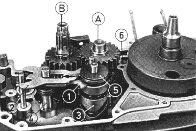

It's apart, it suprising just how much force you need to apply to seperate the cases.
The timing side came away with the bearings in the case, the gearbox outsput shaft bearing is going to need replacing as that it pretty rough.
There is no sign of any sealant on the mating faces, just an oily film - the little traiangular depression in the lefthand case (see picture) was full of gearbox oil and that is idealy placed to let oil into the crankcase through lack of any sealant. The little rubber plug was in place but does like it was not fitted properley which could I suppose wedge the cases apart a little which would not help.
Bild 27. Schaltung und Getriebe.gif (32.34 KiB) Viewed 7588 times
Any tips on re assembly?
Do I fit the new gearbox bearing to the case, or fit it to the gearbox shaft first?
I am thinking that I could make up a couple of mandrels that I could use to heat the inner races of the bearings before attempting to re fit the cases - there is one shown in the blue workshop manual for fitting the main bearings to the crank. Doing it this way the bearings would be mounted in the case which is how it is shown in he blue workshop manual
Any help appreciated.
