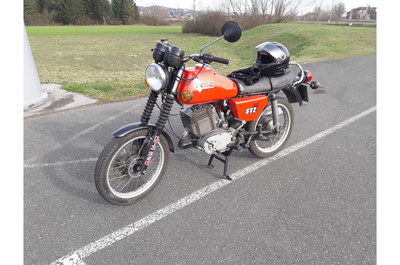

Classic beauty;)
You know, what the building in the back is? I belive, that member, named Kruh, knows;)
You'd be right. Its Krško if I'm not mistaken.

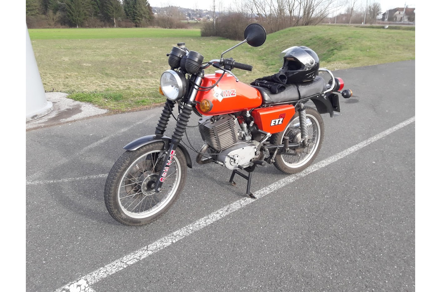

Additionally Klemmy, you have a lovely looking bike there. I notice you have Mitas H-03 on both the front and rear. I didn't like having such a tyre on the front of my ETZ- It felt funny going around corners! But, interesting your rear tyre looks as square as mine has also become (I currently have a H-03 on the rear too)! Plus, can I ask what size you have on both the front and rear please? I have a 3" Mitas H-03 to go on the rear of my ETZ to replace the 3.5" Mitas H-03 when that has worn through - and I thought a 3" might look silly but if yours is, then I don't think it does. :D

Yes, Kruh, that building is a Nuclear power plant Krško 8) Source of a "green energy" in front of two stroke motorcycle :D
Im glad you like my bike, Blurredman. And yes, the tires are both Mitas, the front is 2,75-18-H-03 and the back is 3,00-18-H-03. So its not as factory recommended 3,50, but I belive it doesnt look too silly :D
The both tires are very old-2012 year-so the changing them is a must. And there I made a rookie mistake and I didnt look at the bike specification for tires and I just simply order exactly the same size of tires as they are allready on the bike :roll: Im planning to change them in the next week. Anyway, Im not planning to do some speed records, so we will see, how they will perform on the road.

Hi Klemmy, yes you're right that 3" rear tyre doesn't look too out of place on the ETZ250 at all. I think the 3" H-03 I have will not look silly given what yours looks like. :) But I really didn't like the way the 3" Mitas H-03 felt on the front of my ETZ250 when I tried it :D

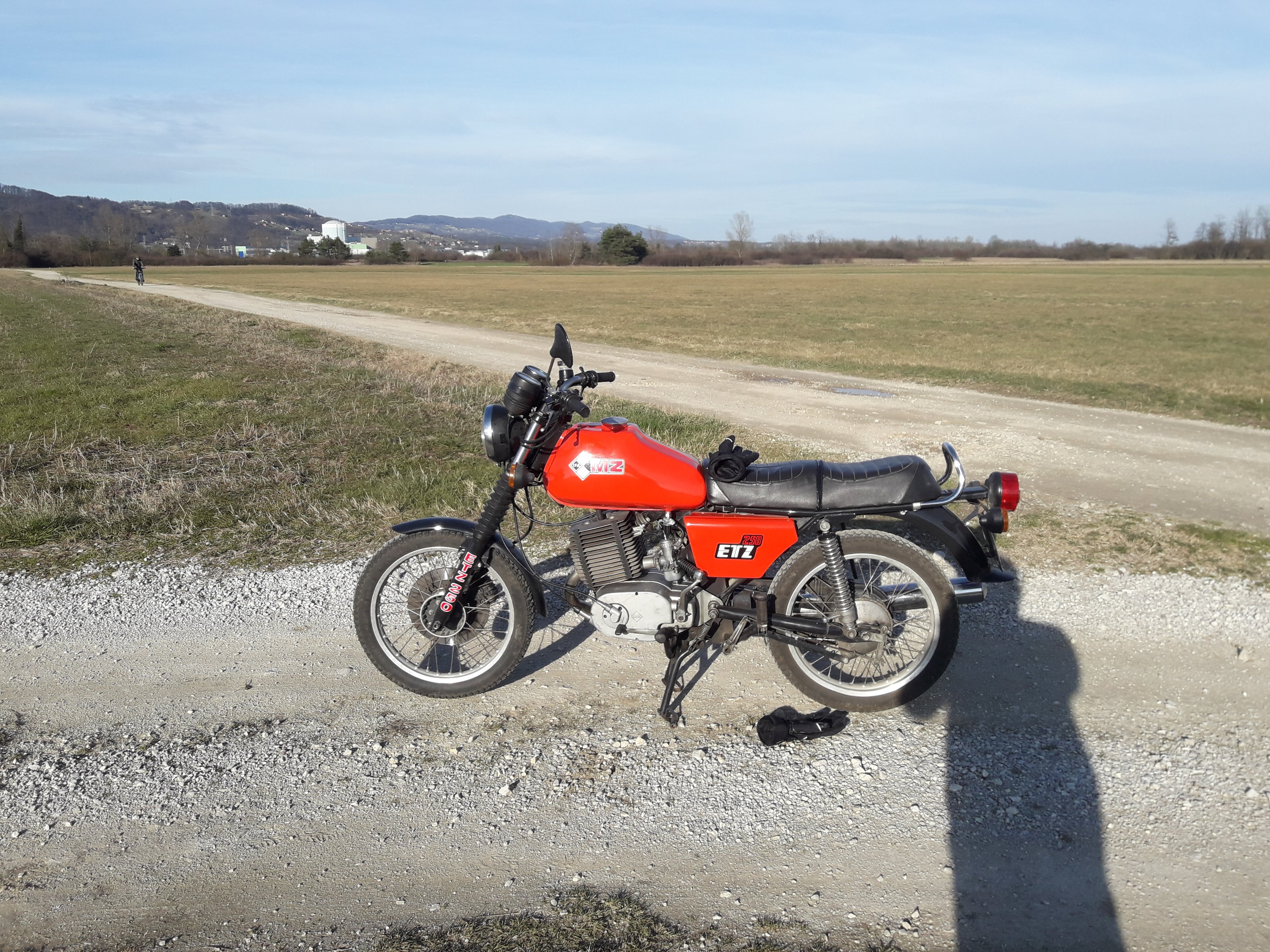

Here is mine ETZ from profile, so you can see, how it looks with 3,00 rear tire. Apologies for my shadow and glove on the floor. The bike was running and vibrations did their job :D

Thank you for the picture Klemmy, most helpful! I really dig your bike! A very nice example, nice colour. No rust that I can see.
Puffs: your rear tyre does look big but it doesn't strike me as much as how large your front tyre looks! :) :) It certainly fills the gap out.
