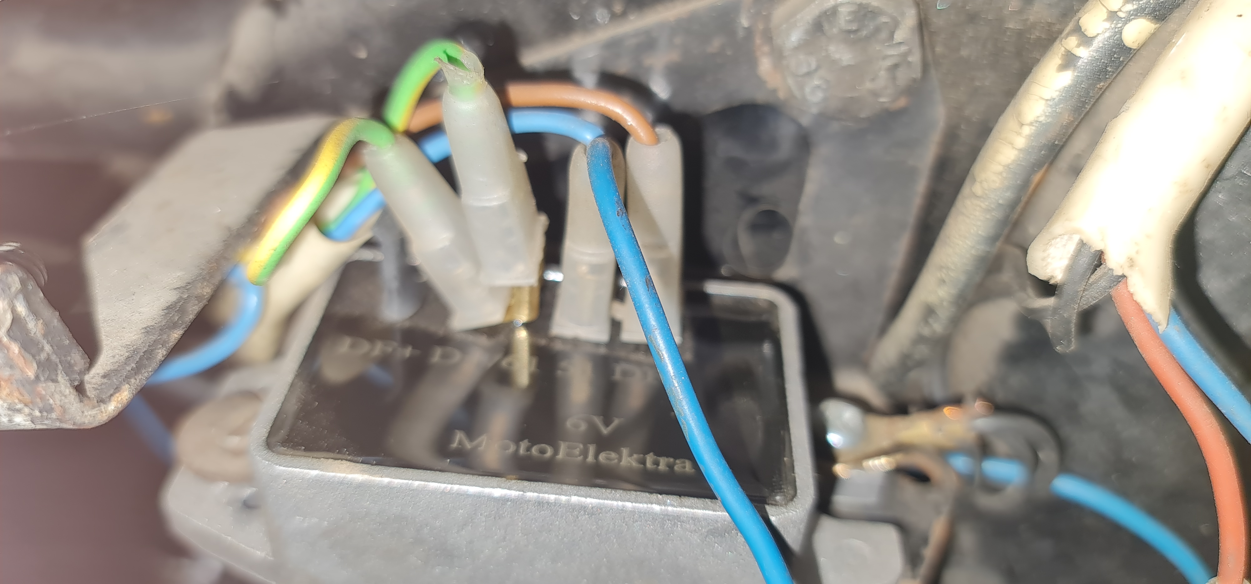

Believe Guesi.
But leaving the resistor in will probably not stop it working, it just won't work as well.
Have you connected the DF wire to the correct terminal ie DF- , not DF+

dave47 wrote:Believe Guesi.
I have to check on that
pics attached. they are correct

I was reading on the powerdynamo site about these electronic charge controllers. It seems this one is the original and all others are copies and yes Guesi is right. It cannot function with that rezistor in place.
Now I will disconnect that rezistor again (initially it was disconnected ) but I connected again on advice from ost2rad via email.... hmmm
I hope I did not burned it... if I did I will just send it back since it was their advice :).
PS: I now realize that I am quite happy when Guesi posts some answer on thread... and I would kindly invite him to post more and help if it is possible:) It seems he has a lot of good advice to give.
Buttttt.... the damn charging light ... it stops lighting when engine at idle and it starts glowing again when I revvv the engine.
I read on vape site that the charge indicator will not work if it is led but mine is a dumb 6V original bulb...

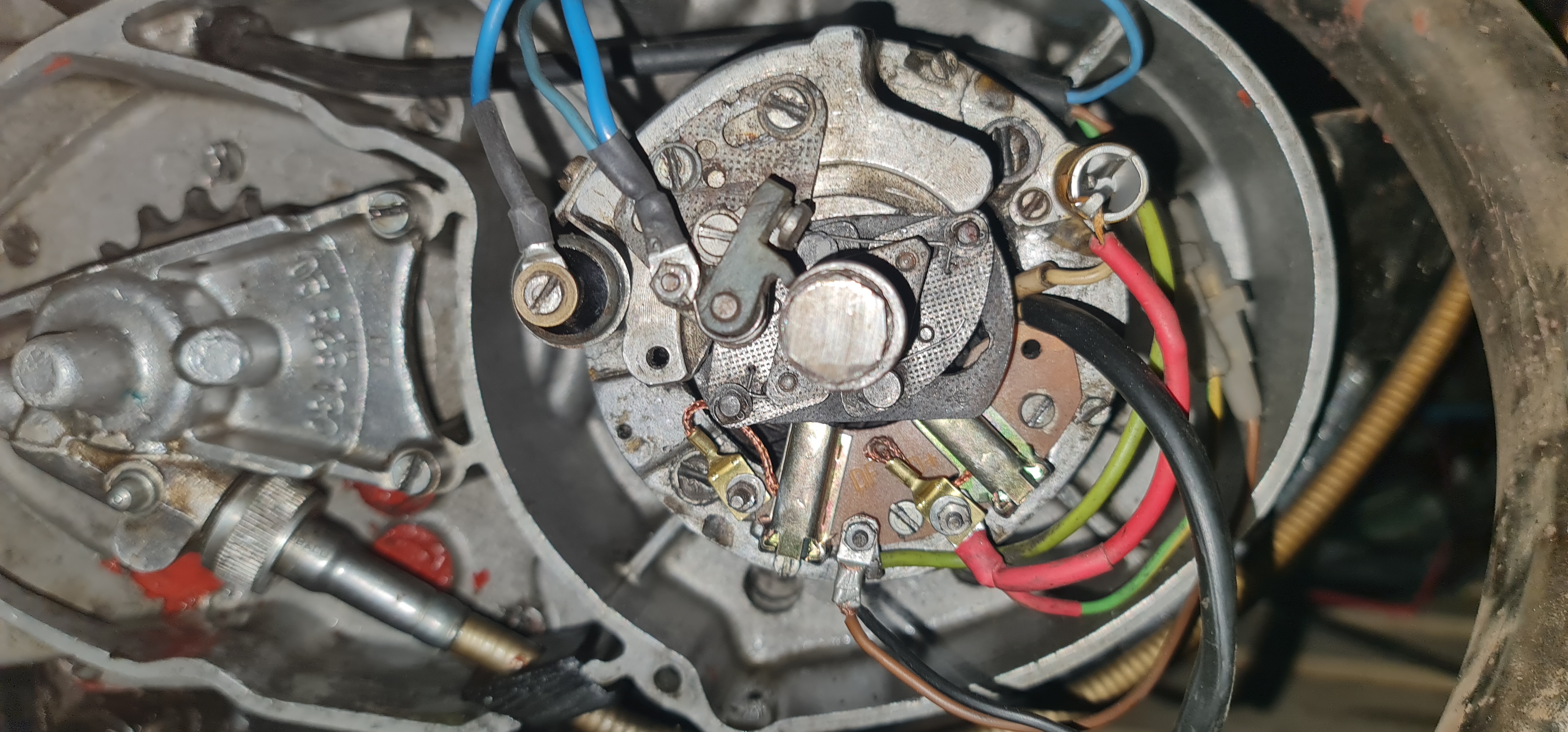

So i took all ognition from the es175 engine and will change on the 250.
One question: when I measure between the poles of the rotor i get 0,01 - 0,04 ohm. from poles to ground 0 ohm. I should consider it good right?
Also stator checks and I get 2,1 - 2,2 ohm rezistance beteeen poles and nothing to ground .
