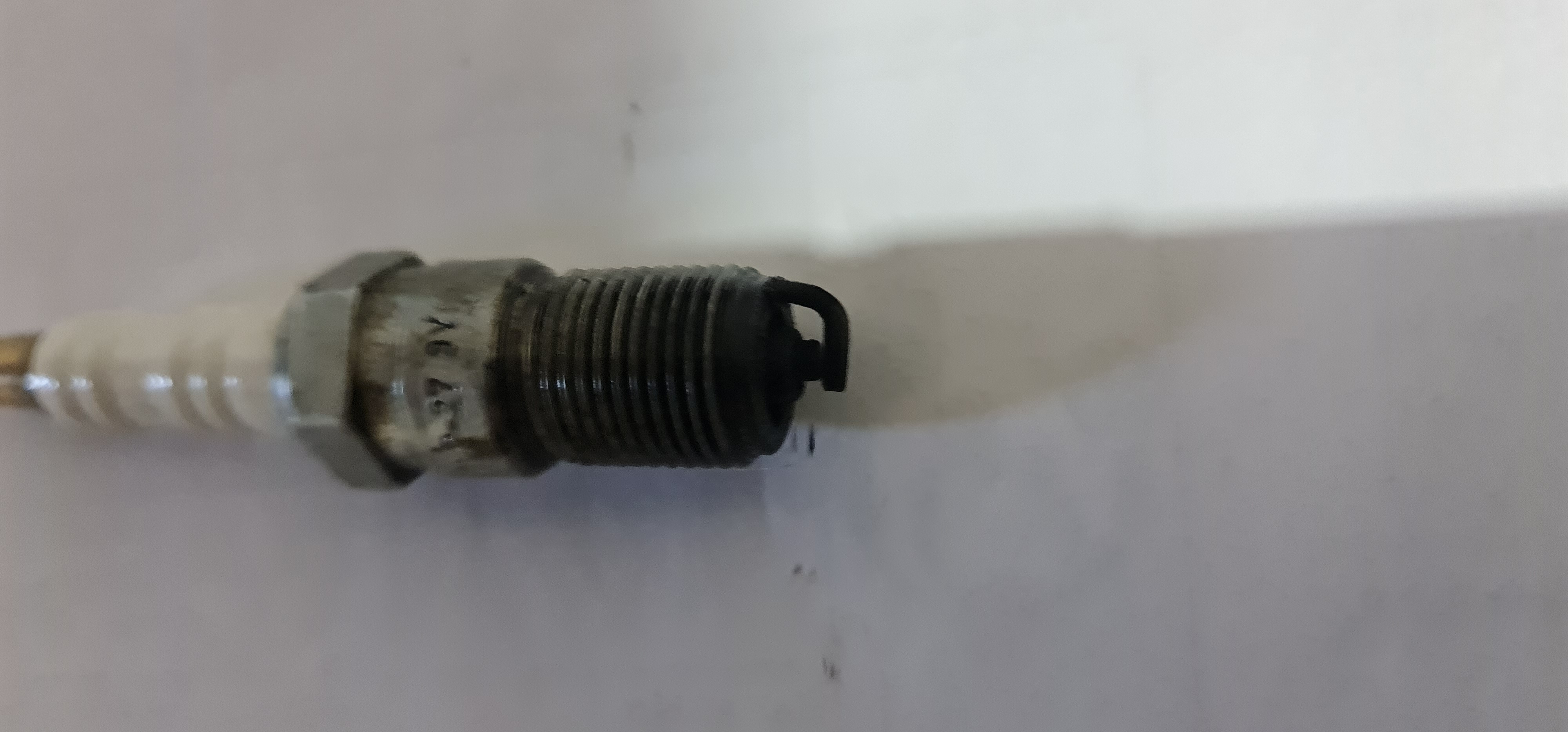

So starting the engine cold is has specific sound. An now I can say the the sound comes from cylinder , it is like piston rings rattilng. But that noise is slowly decreased but still there as the engine warms up. And a lot less smoke when the engine is warm. Noise is louder when accelerating and no noise when letting the throttle go and engine revs down. In fact the noise completly dissapears. Crank bearings? Ideas... Do not whant to break something... First time I changed the old 12 year oil in the gearbox the oil was definitivlt contaminated with water.. a little but...
Incorrect carb that is causing ignition trouble....
Spark plug looks like attached
Still i have the question of why with the chain off Gears are very very easyli selected and with chain on and the bike on wheels not.... so much clutch drag????? Yes with the chain off and in first gear when i pull in the clutch that pinion never stops but..... even my 2001 F650GS BMW does that... Now also running on GL80 api gl 4.. No difference fron the other oil..

That does look very rich.

grimstone wrote:]Hola,
Took the drive chain off today to be able to shift throu gears
The attachment spark_plu.jpg is no longer available

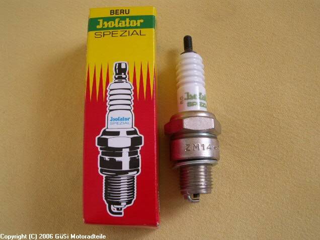

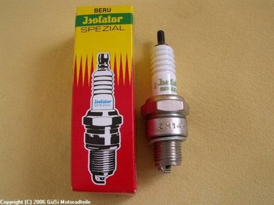

Ihn my opinion the thread of your spark plug is far to long . It should look like this one:
Guesi Motorradteile
