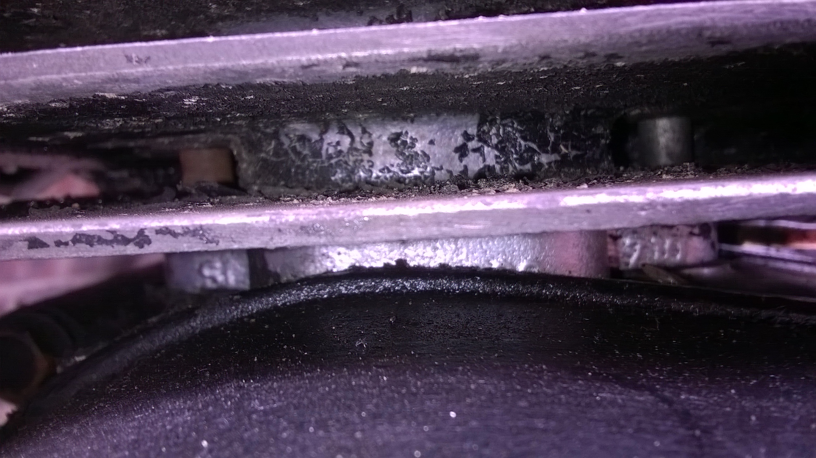

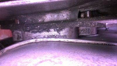

The number will be where I said, but may be obscured to a greater or lesser extent by the LH cover which for some reason is higher than the crankcase. It is mostly visible on my early ETZ, ( broken fin makes it even more visible!) but only the top part of the final .000 can be seen on the later bike. It tells you nothing anyway.
All the markings are the same on both of my barrels and on yours, except the date marks. I think it very likely that this is what they are, because apart from anything else they are in circular panels, which suggests they are changeable. This would indicate that your bike, like mine, has a replacement engine/barrel, but whether from a late 250 or early 251 is anybody's guess. I suspect that MZ may have used the same for both for at least part of the period 88/89.

Yes you are right, I can just about see something that looks like the very top of the '000' at the end. But I don't have a broken fin, so to see it properly I'd have to take the barrel off. (The angle & view of your 2nd photo is only possible without that lowermost fin.)
LH barrel neck_2.jpg (21.83 KiB) Viewed 463 times
A pic of mine. Anyway, then that number is the same for all barrels, hence indeed useless for detailed identification.

FWIW, it looks like the 'Si' & the '710' on your first photo are a bit lower than on your 2nd, which would be consistent with Maß A being (2mm?) less.

I think you are right , it has been dropped by about 2mm, (not 1.2!), which makes it the 251. The data sheet must be wrong about the position of the number. The footnote must only apply to the later 251/301s.
The "datemarks" on my earlier bike read "E" and "85", which I take to mean May 1985. It is consistent with being on a D reg bike (UK), but somebody must know for sure.
