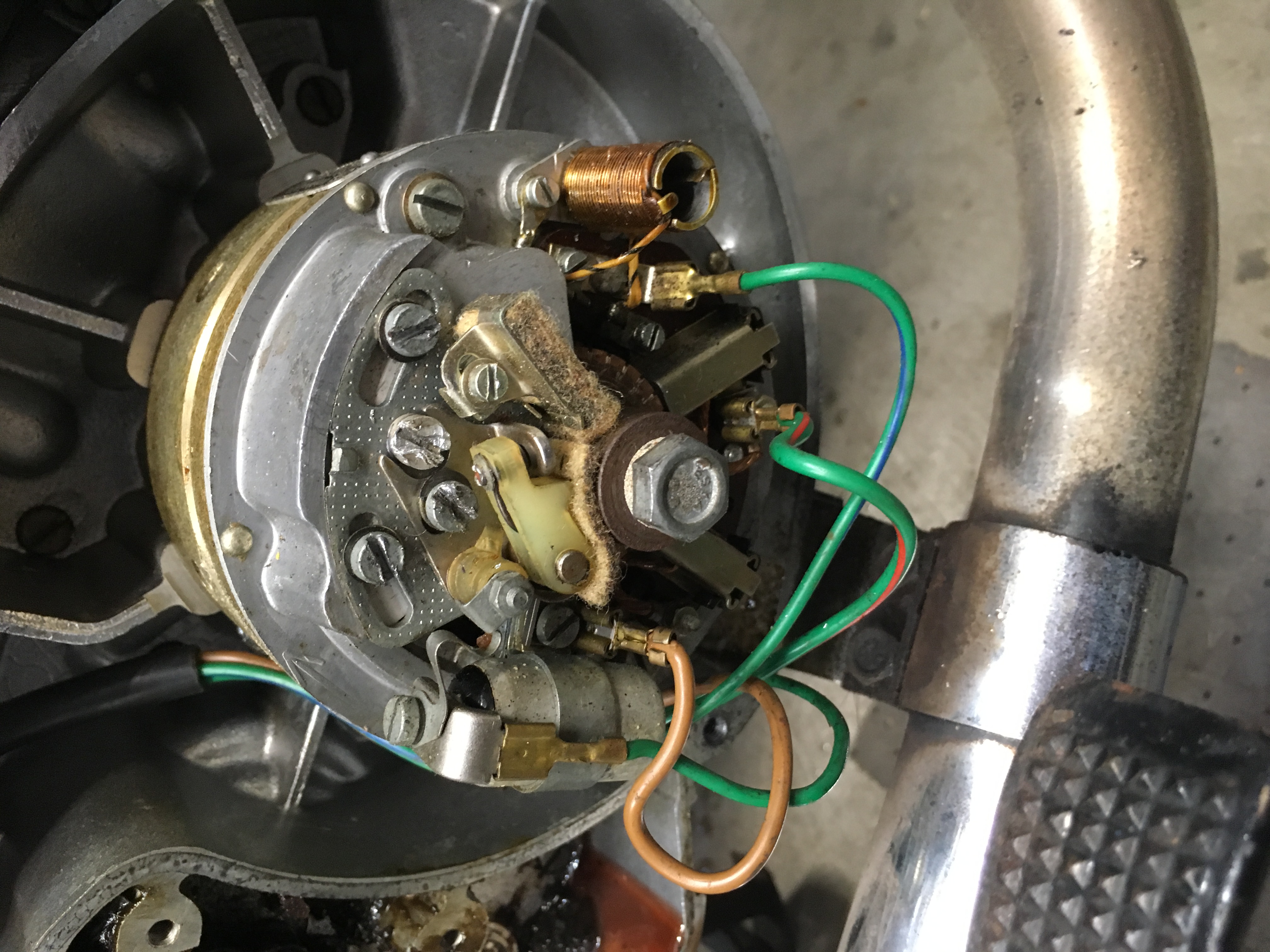

Going to double check the points too because it still kind of just maxes out in the same range as it did before. Today's ride led me to believe that perhaps it just doesn't have enough charge to fire the coil at higher RPMS. What brought this thought on was that after I was riding for a while, the bike didn't want to rev past say what the middle of the gear was just before. If I rode it at low RPMs it ran fine. They after a little while, as thought the battery charged a bit, it would rev a bit higher. The battery did take a decent charge when I got home and the charging light never turned off on the bike the whole ride which in the past it has.
If I turned on the light or even a blinker, the bike wanted to die. I had to keep it revved pretty high with the clutch in around some traffic light turns or it would bog down.
Is the power dynamo 12V system the only good option here? Perhaps the genny is fine and another component is aging in the charging system.

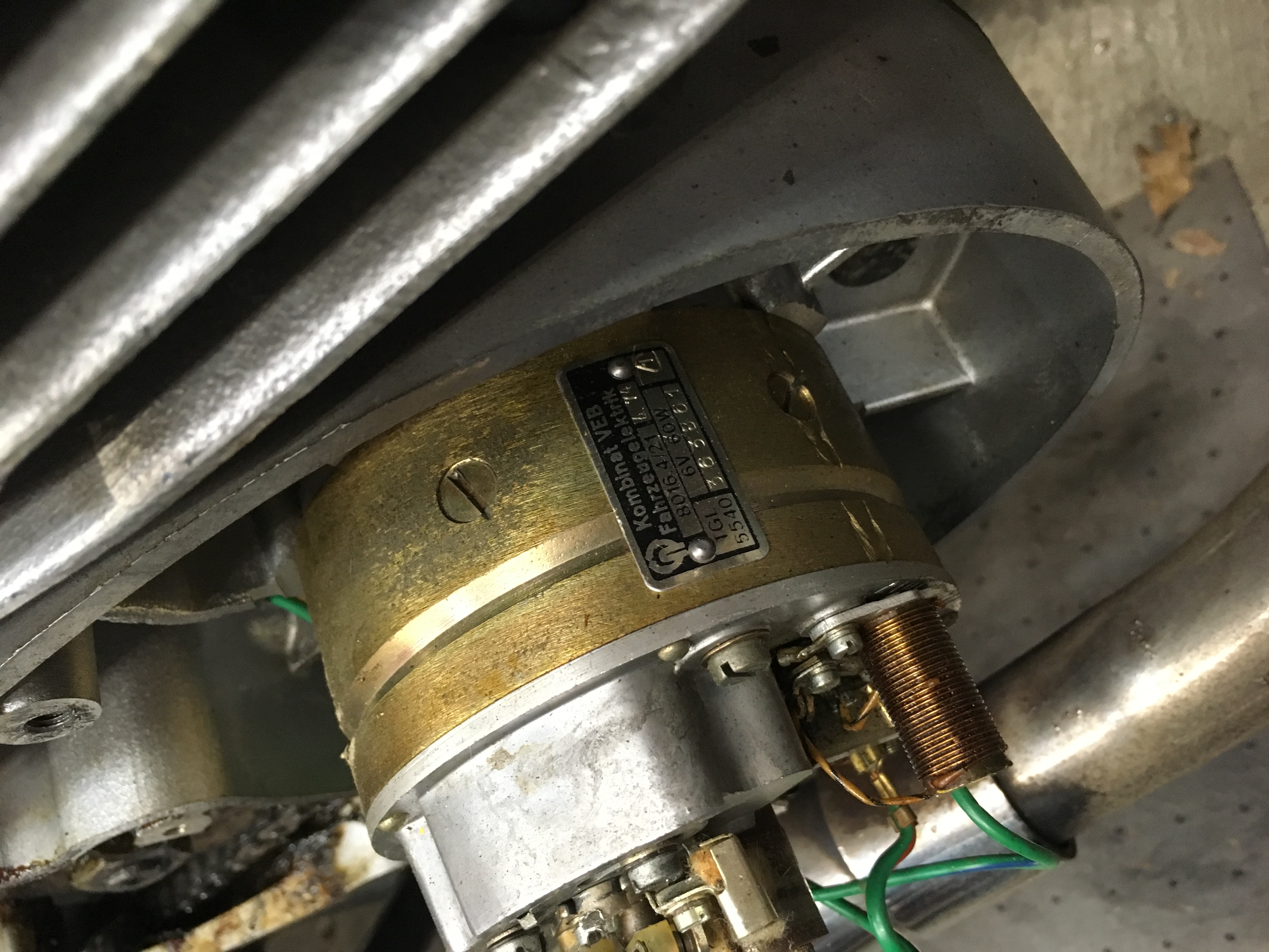

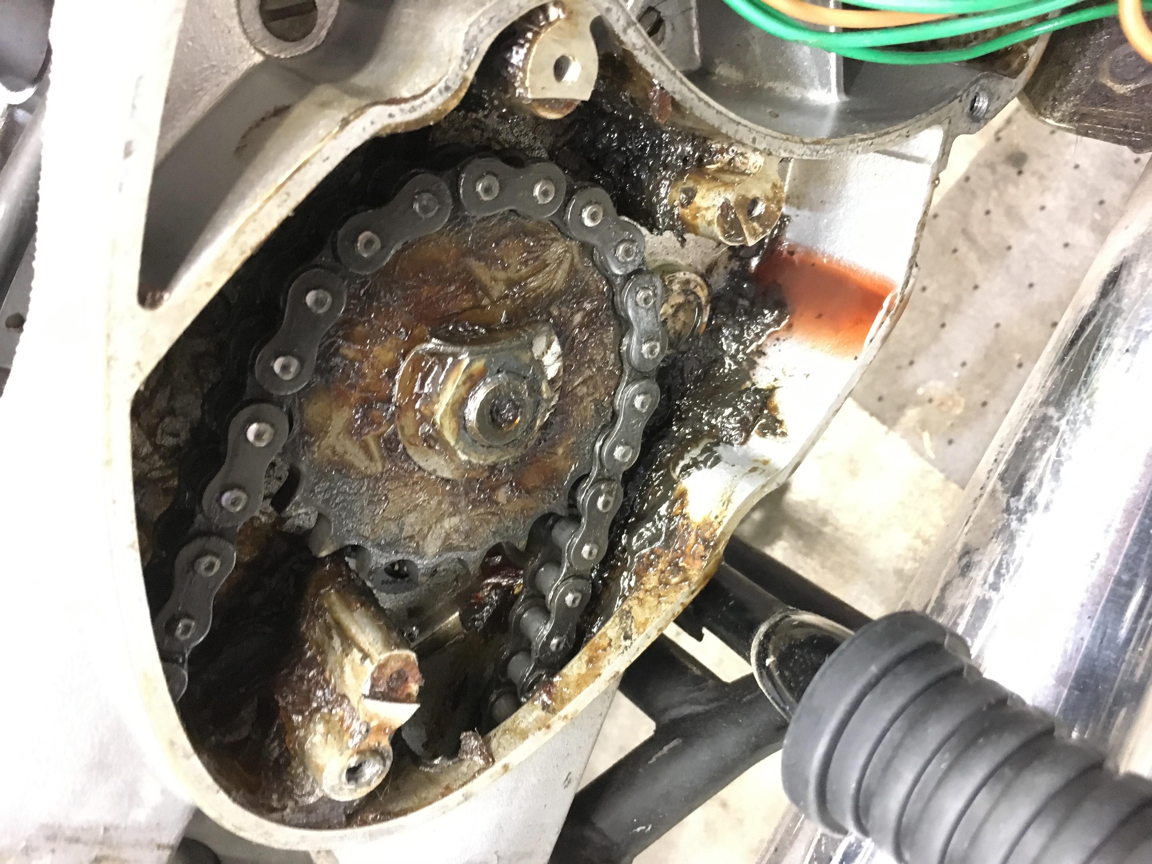

I have a couple of images here that to me, make the bike seem pretty new and unused... Looking forward to your thoughts.

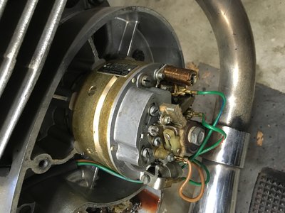

Postby neomuzzi » Mon Jun 03, 2019 11:04 pm
another pic

Postby Blurredman » Tue Jun 04, 2019 6:12 am
The felt attached to the contact breaker itself is normal- it is there to catch excess oil on the cam that would be provided by the other felt. Or so the factory manuals say. There is a rectangular hole so that the points foot is not lying on the felt- but the cam.

Postby parrbd » Tue Jun 04, 2019 8:26 am
Looking at those butchered screws makes me think this bike has lots of miles on it. The first thing I would do is burn out the muffler. I have to do that twice since 1985 on my ETZ and many times on other two strokes.

Postby Andy_C » Tue Jun 04, 2019 10:20 am
Whether the felt should be under the heel of the contactor breaker or not I would remove - surely it will affect the opening / closing / gap of the points - I would at least try it without the pad.
My ETZ once had problems with intermittent running / stalling, that was down to electrics, I checked all of the connectors and tightened them up - just slightly close them with a pair of pliers and re fit.
Some were pretty loose.
Ever since doing that it has run faultlessly - worth a look perhaps?
